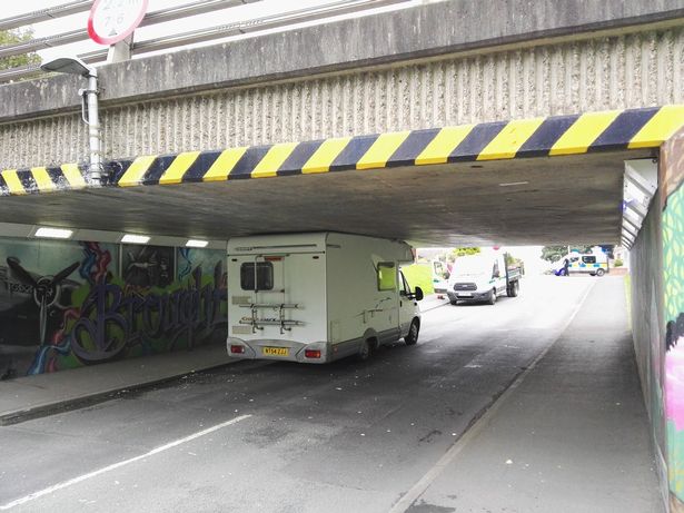

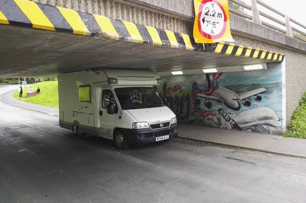

The motor home got stuck under the bridge on Broughton Hall Road in Broughton at about 6pm today.
Can't see one of our stickers on it
Motor home stuck under Flintshire bridge blocks road - Daily Post
