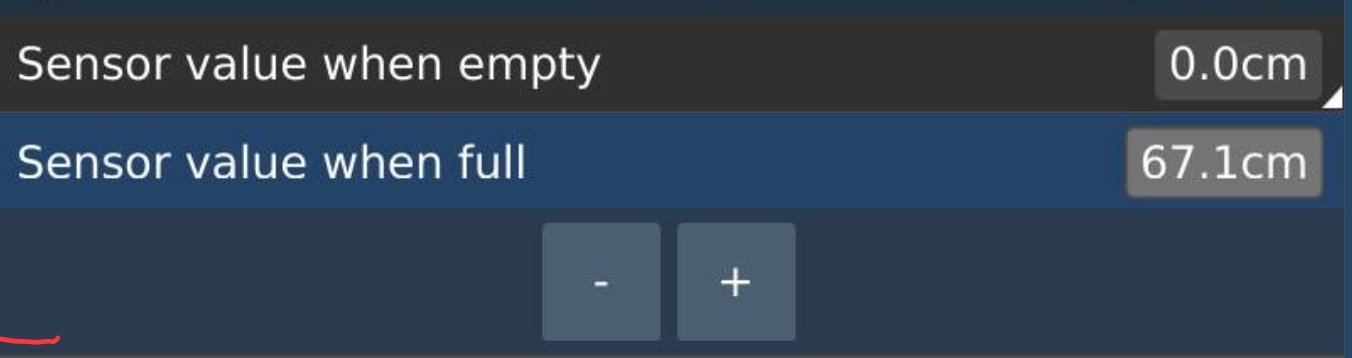

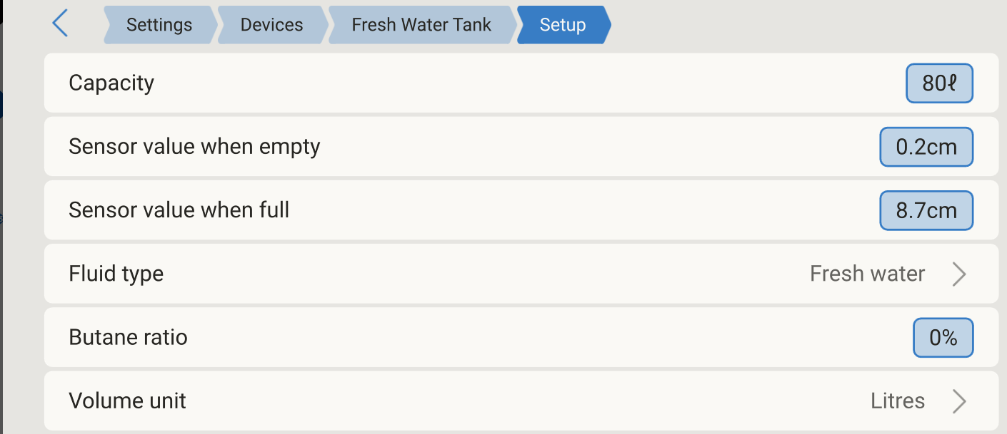

My pump stops picking up water when I have 2 litres left in the tank but my drain tap near gets every drop out. The qr code is on the sticker near the sensor so you would need to take it off. I noticed if you modify the water sensor height when full( not full tank that's what the settings called)in the victron settings. You can get the victron to read the correct amount of litres you have measured in. But I have not tested what it will do when you have a full tank. But it seems to be quite accurate as the victron dropped the litres by the same amount I drained off and added what i put in only tested 14 litres so far. Was messing with it earlier but now it keeps hailing and trying to snow🤣
Mike
Can you only set by whole centimetres on the Victron on your installation?
As mentioned, I had it set by a 10th of a centimetre when I first set it up, but now whatever I put it rounds the value to the nearest whole centimetre, which is annoying. Running the latest Venus OS release.
I am running 3.67 venus on a raspberry pi and can go up by points of cm. Not updated mine yet as last time it flipped my screen and went headless🤣 so i had to remove it and start messing about with it. I have removed my zig control panel and replaced it with the pi and screen.

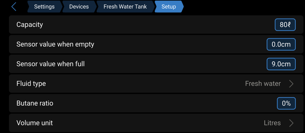

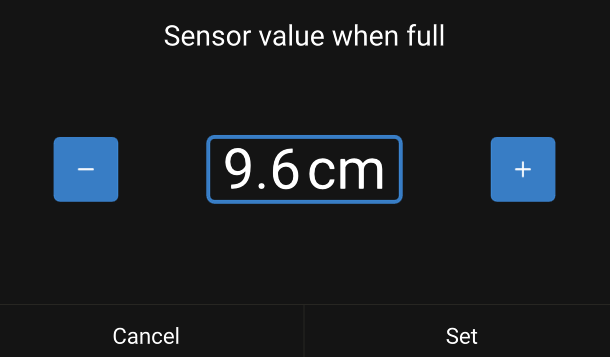

The display suggests that settings to a 10th is possible ...

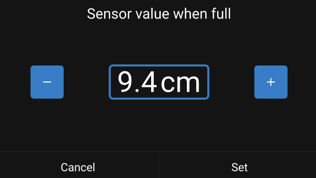

But when you do so ... e.g.

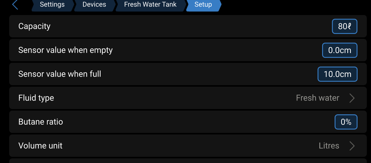

it rounds to nearest whole number. If I make this value n.4, the entry changes to n.0, If I make it n.5 to n.9, it changes to n+1.0
Running Firmware v3.70~13 Large (need the Large as using Node Red features). This release date shows as 20250716, so fairly old really (I thought I had updated it in last few days actually. Guess not!)
I see there is a v3.72~4 now .... let's update!
Looks like got the tank granularity back (y)

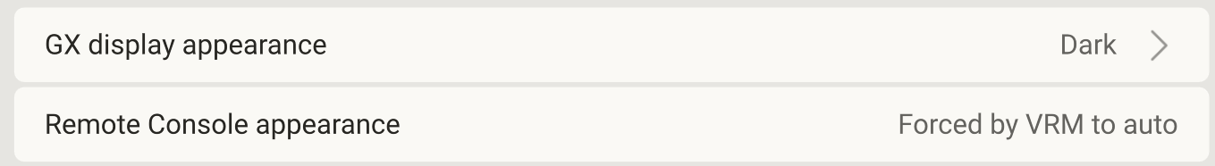

But if you liked the "Dark" Mode, you are out of luck it seems? These screens are 'DARK'!
(At least via VRM. maybe direct console will be different?)
