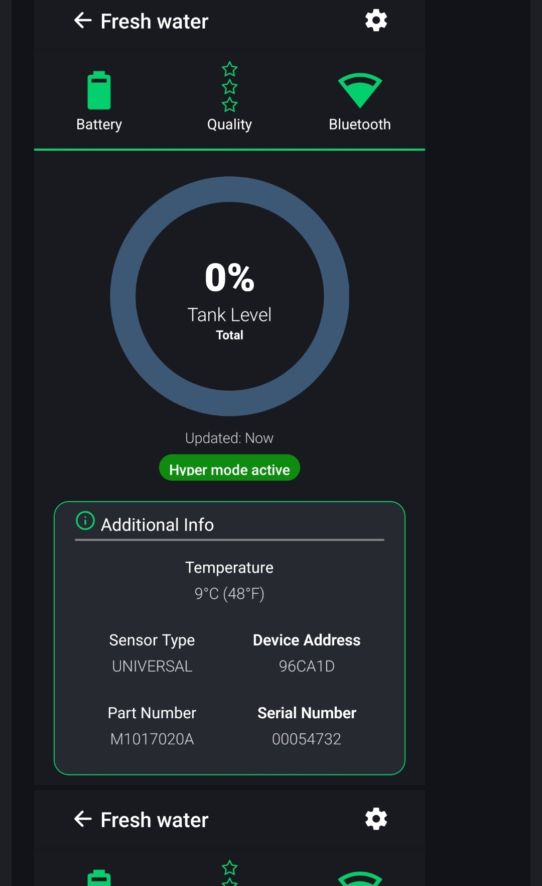

Anyone else fitted one of these to there water tank? I got one from lpg shop in December but only fitted it about 3weeks ago. From the off I could not get any of the quality stars to light up on an empty tank so could not proceed with the app install. But noticed once I had about 12litres in my tank the quality stars all lit up and it showed a percentage of water. But this is then totally inaccurate and a full to the brim tank shows 88%. Mopeka have been great with there help and I logged water percentage as I added 6litres at a time up to full 96litres. And

Iandsm, when you fitted yours did the quality stars light up on an empty tank. Mines on the bottom of my fresh watertank thats made from black plastic. And I have tried it with different amounts of grease and even without. And no matter what I can only get the quality stars to light with about 12litres in the tank. Mopeka got me to upgrade the firmware on it and it made no difference at all.

The quality stars are the fit of the sensor with no water I get no stars so the sensor won't register anything. And when installing the app you can't get past this stage when it checks quality it asks you to adjust the sensor or add more grease they call it sonic grease comes with the sensor think its just silicone grease. Few pics of what I mean its sounding like mopeka are correct and it's faulty so still trying to get lpgshop to answer me. The pic with 1 star is with 12litres of water in the tank no stars is anything from empty upto 12litres. Sensor is in its plastic clip that you glue to the tank which was spotless.

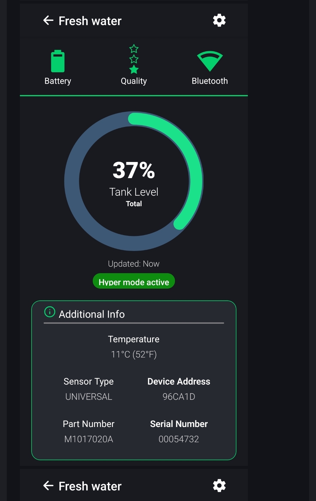

...at 30% I lost 1 star but carried on draining it then went to back up 53% then 59% then 42% which changed to 1 star at 36% then all stars lost right at 36% at this point the sensor stops working and shows empty.

Sensor is fitted to the center of the bottom of the tank which is just a standard black plastic tank fitted by autosleeper. Nothing is in the tank and yes its fitted with the plastic ring that is stuck to the tank and the clip has pushed it right tight to the tank. I cleaned the bottom of the tank first with panel wipe then used the little tube of primer that came with the sensor. I have tried varying amounts of the sonic grease. Mine will only get any stars with water 12 or over litres of water in the tank. Mopeka usa have said it sounds faulty to contact uk distributor. Lpgshop finally answered me today after I sent them a message through Ebay as I bought it from there Ebay store. They said all they can do is test it if I send it back. But I want to get other people's thoughts first to make sure its not just me fitting it wrong or expecting too much from it. Everyway I have tested it even with old firmware and old app it would only work with 12 or more litres.

I am going to test it on a container like that tomorrow👍 I am sure its always around 12 litres as I fill the tank with a 6litre watering can that I fill with a jug😂 and I always get the 3 quality stars to light up at this level. Then when draining the tank as soon as the 1st quality stars goes out I start measuring whats left with a jug. And then measure whats left when the quality stars go out and the mopeka reads zero and its always around 12 litres again. Tank size according to my manual is 108litres but when doing all this testing I get around 96litres and it starts over flowing. The mopeka app only shows a percentage.
