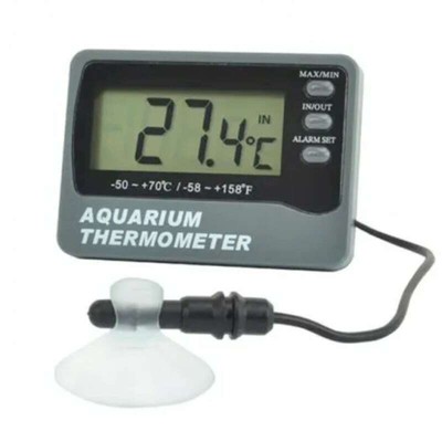

in my T5, I didn't have any fancy monitoring stuff in it, but I did have a Min/Max thermometer with a probe so you could do current/min/max temps for two different positions. Used it to check room and fridge IIRC - around £3.99 from LIDL :)

these min/max thermometers are very handy for checking the freezer compartments and fridge temps. Lots of fridges fluctuate a lot which can be quite dangerous if you have meat and dairy in there.
