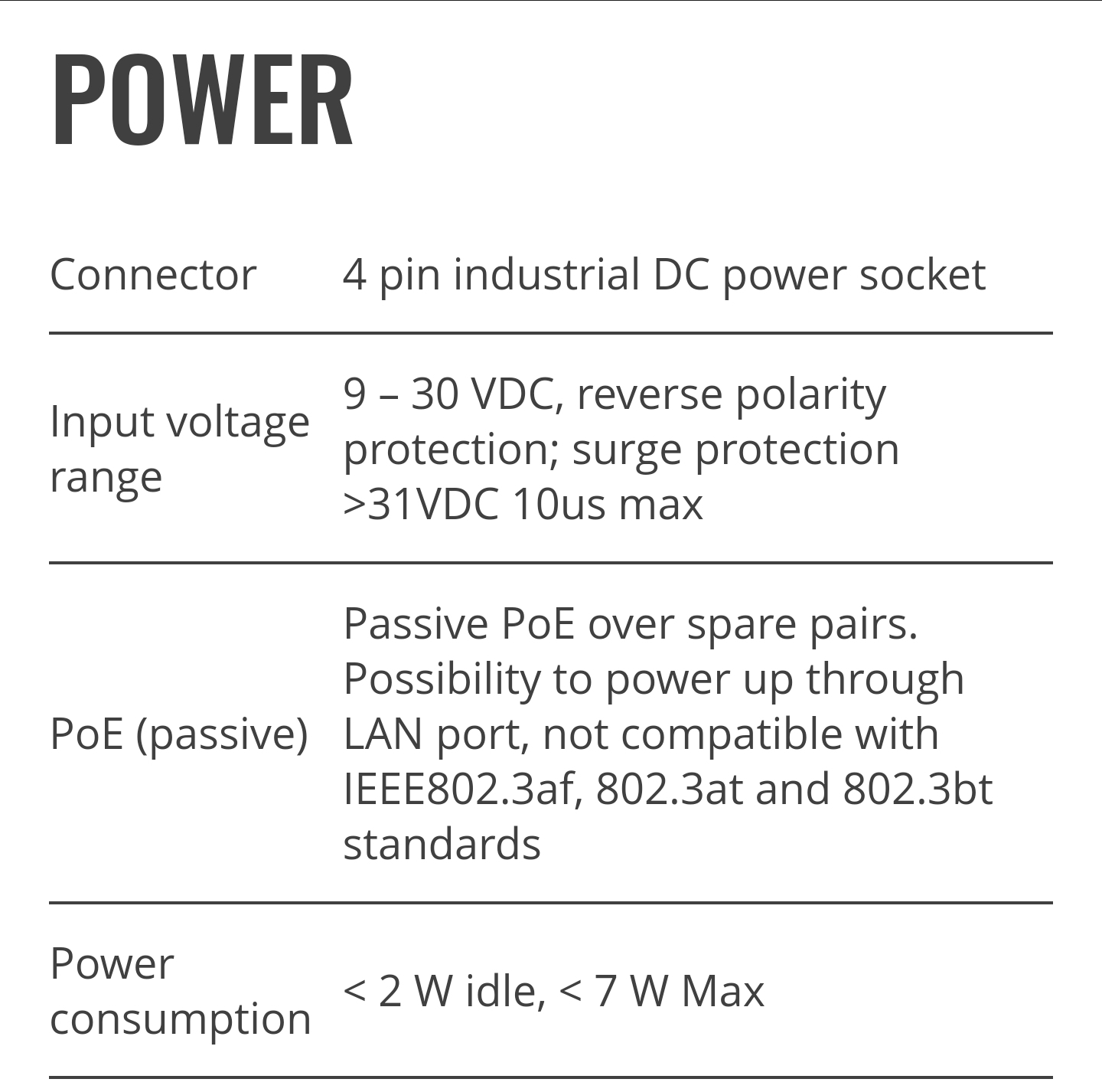

This is for the later one...What is the power usage like on these routers? I think my iboost draws about 9 watts so not much at all.
