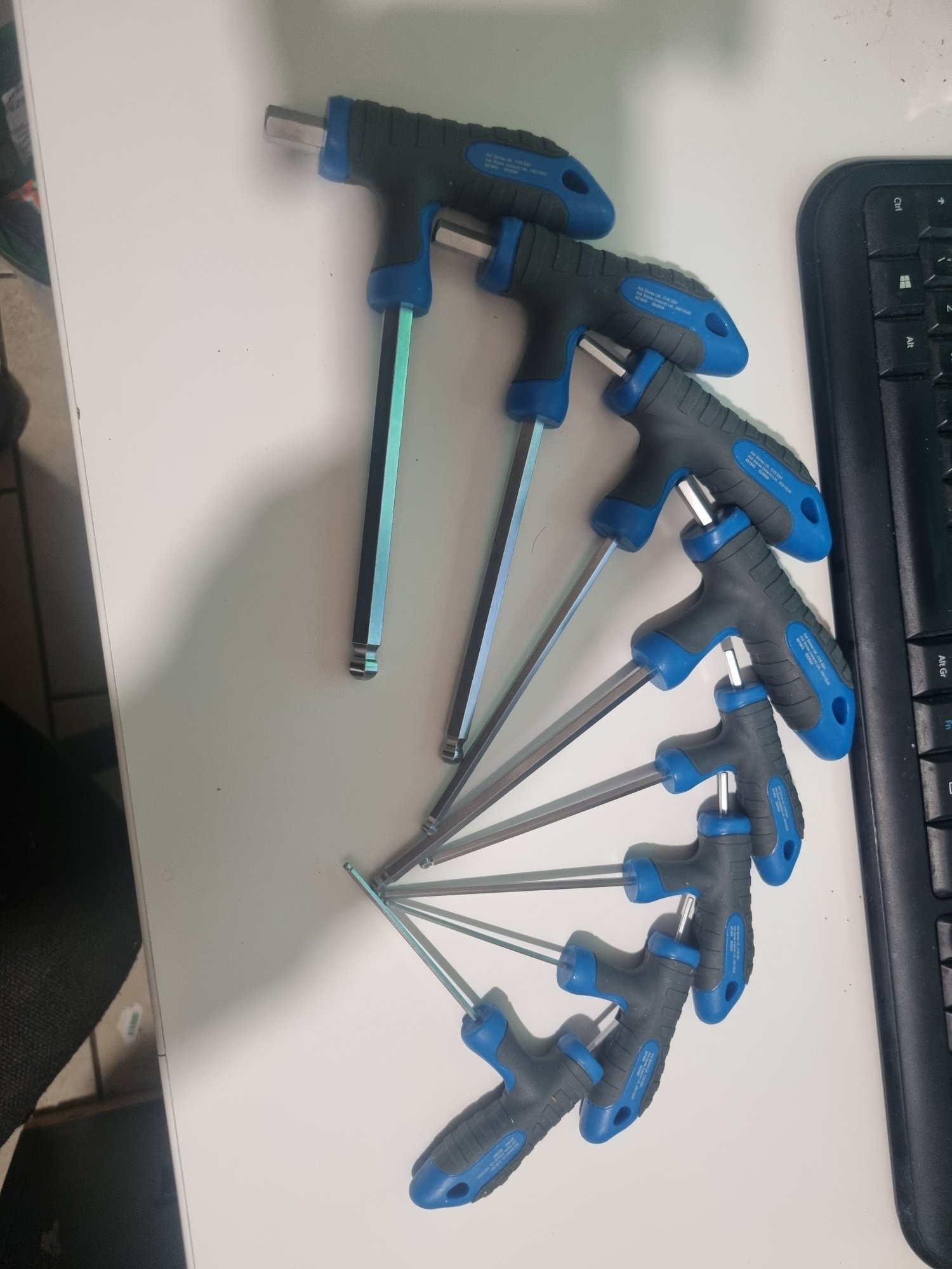

Julie just bought me this set of long bladed Hex Wrenches in Aldi. Quite reasonable at £5.99 I thought and ideal for working on the bike. In fact I could have done with them yesterday.
