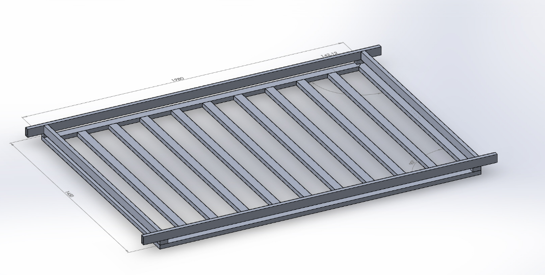

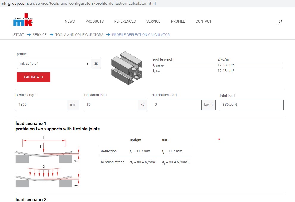

The Aluminium extrusion i thought about was what the Americans call 80-20 i think. I went on the MK website and used their calculator, but it does not say what is the weight limit, it only gives the deflection, and i chose something that gave 'reasonable ' deflection to my eyes. I could not find a way to to be sure, so went safe. The opening is probably 1.8m. If i can get away with 20mmX20mm that is better, but i do not think it will beat the Ikea beams in price.
12mm deflection seem to me quite a lot... and this is for one person. 20 X 20 will deflect more.
I will admit I do not know what is considered OK.
Oh, I will probably will not win 'the slim of the year' award, no offence taken!

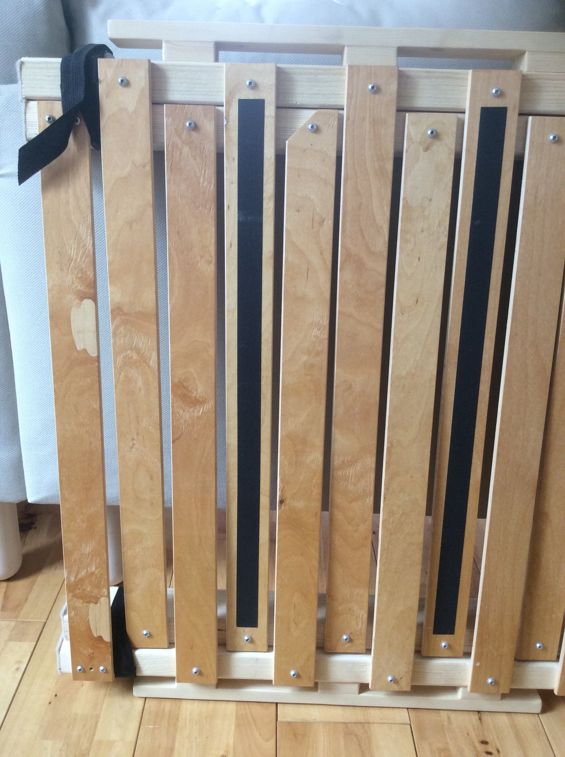

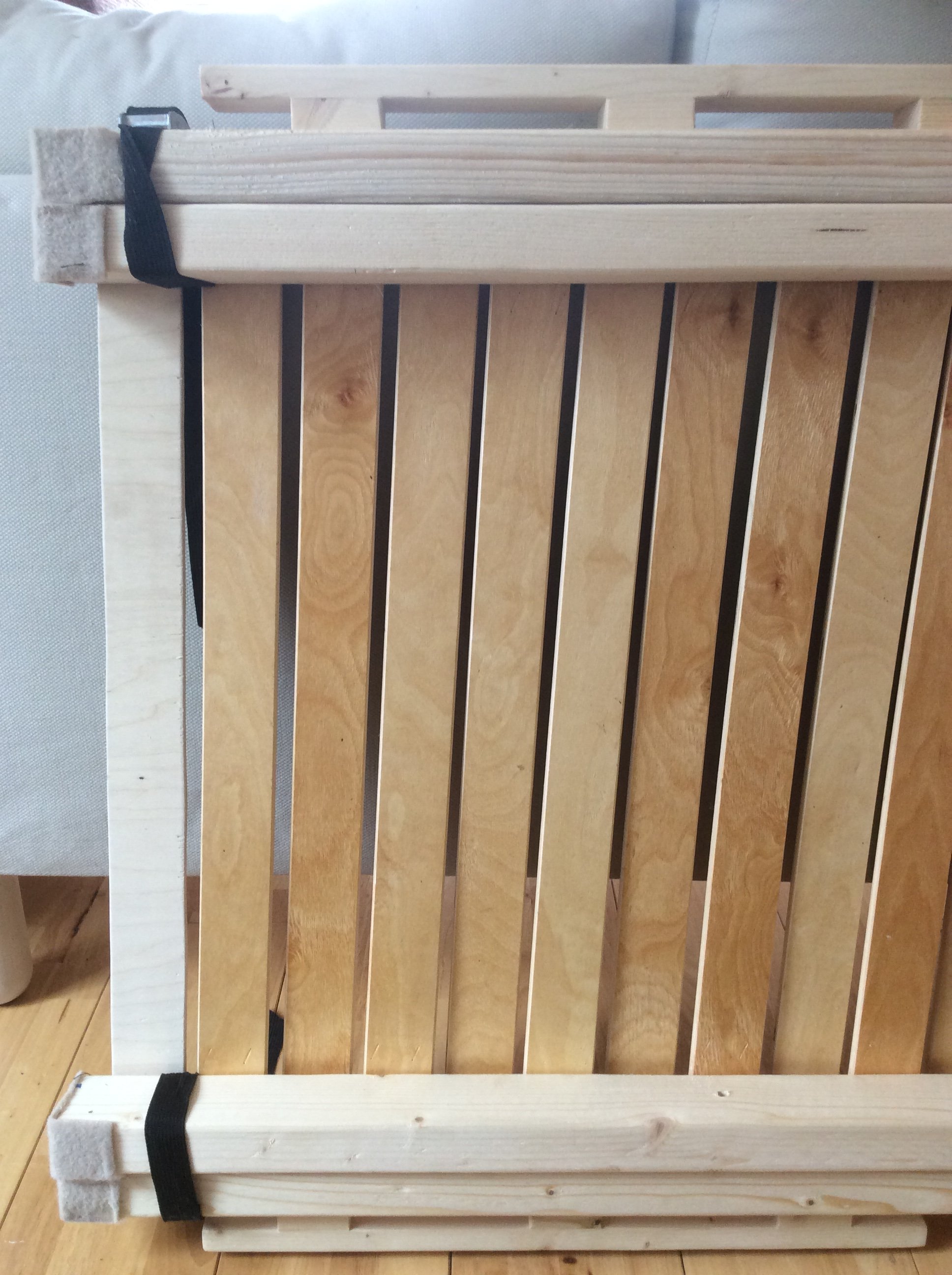

I made mine from Ikea slats and B&Q 60mm cls. It’s cheap, plenty strong and can be removed for daily van use.
Because I have a shorter van I made it with interlocking slats. It can be halved in size by pushing it backwards during the day or could also be pushed forward to give a bigger boot. The carpet offcuts on the ends help it slide.

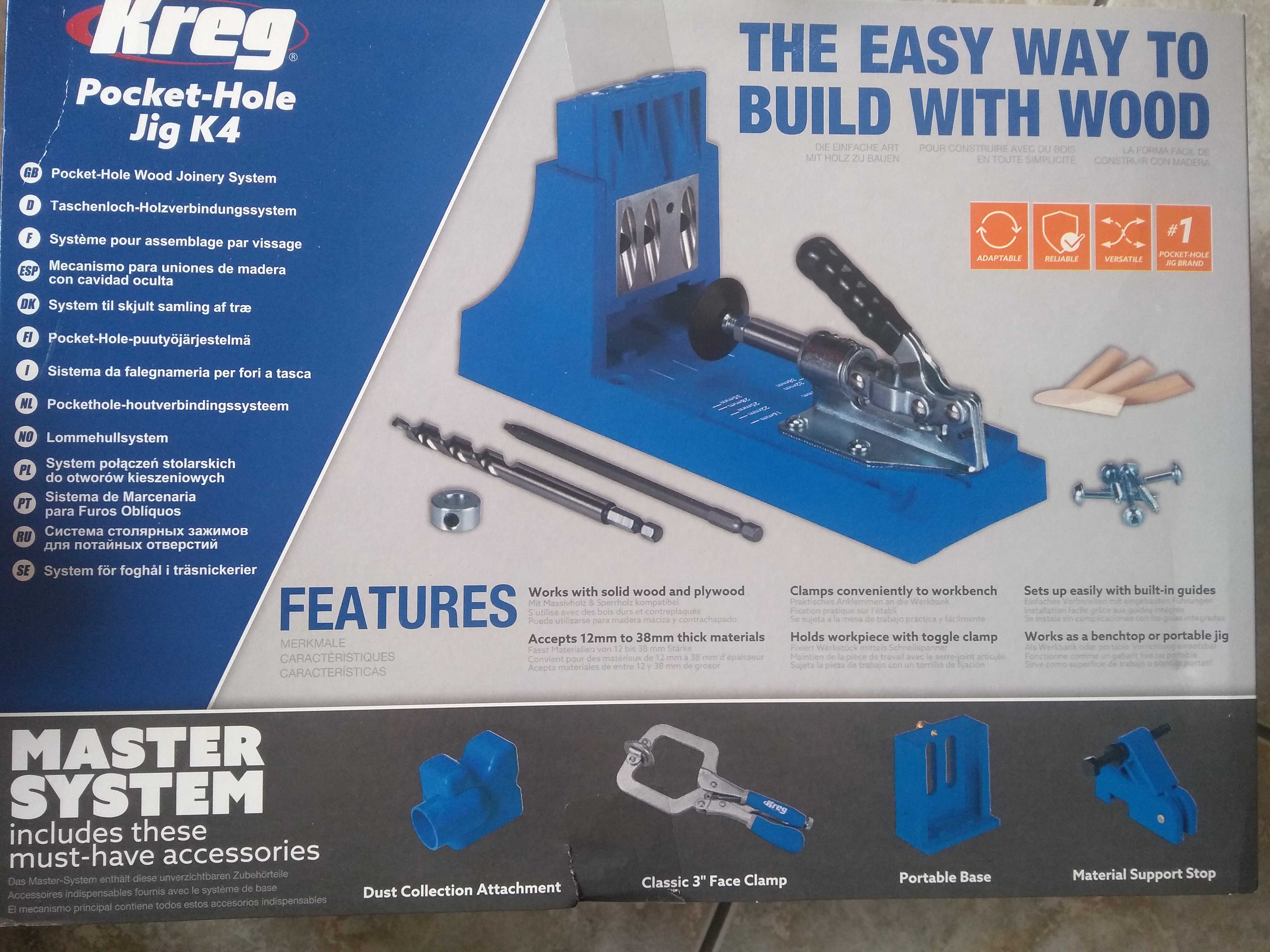

One more step closer, bought this:
Thought of doing it much later but Kreg came up with a new design that has less use flexibility (you cannot use it as standalone ), but require less setup. The current one is discontinued. It does not get very good reviews as oppose to previous one that was the 'benchmark ' for pocket holes.
I "went" Pocket Screws when I built my last camper and bought the Kreg jig set as well (I guess the older one? got it in 2017). Worked very well but I found I rarely used the stand - mostly the 3-hole jig and the face clamp combo as the jig is too unstable with large ply sheets.
The end result really is super-strong :)
FYI, the square Driver bit is also referred to a "Robertson" bit (a Canadian design that predates philips bits) in case you are looking for a replacement.
Thank you!
I wend for what they call K4 Master system. It includes the clamp and the plastic jig that allows the hole guide to be used as standalone. I wanted it for the reasons you mentioned above, I cannot see myself holding a big pieces in the jig. Their new jig does nit allow for this flexibility, you need to buy all separately.
I do intend to buy a spare drive bit and a drill, as I think those two are 'consumables ', so this very useful information.
I think I broke two of the drill bits in total, so not too bad really. one was bad luck, the other stupidity, so definately worth getting a spare :)

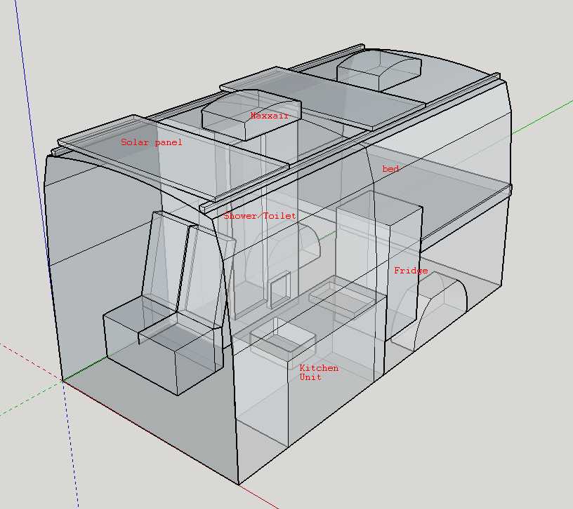

We have been looking for a while for a van to convert. Looking at second hand vans, almost non of them come with an airbag for the passenger, let alone other safety features. After considering long and hard we decided to go with VW Crafter. We have seen on with most of what we wanted but the price was sky high, and dealer would not budge. Looking around, we found that we can buy a new van to our spec at a considerable lower price then a used one standing on the forecourt. SO van is now on order, expected in September. VW Crafter MWB, the 'normal' one is high roof so no issues there (we are in no rash so happy to wait).
Design:
It was decided that we do not want LPG, so all electric, and diesel heater. Hot water is looking like electric as well.
The initial design looks like this:
This is very 'loosely' based on a Vanworx MaxTraxx crafter design, with some changes.
Sleeping will be sideways, if we will find it too short we will consider adding a side pod but think we will be OK without.
Water tank will be at the 'garage' on one side and batteries and electric system on the other side. We plan to go with LiFePo4 batteries as we will need it for both hot water and induction hob. Appropriate size inverter will be near the batteries. Grey water will be under the van.
The van will have to be under 3500kg as I want my daughter to be able to drive it, so trying to go as light as we can with as little compromise as possible.
The design includes a shower/toilet (chemical) and the garage should hold 2 pair of bicycles. I am considering fitting actuators to lift the bed for ease of use of the garage.
We started looking for parts, and currently looking for seats. from reading around the ford Transit minibus seats are usually the builders choice.
This is where we are at the moment - comments are welcomed.
