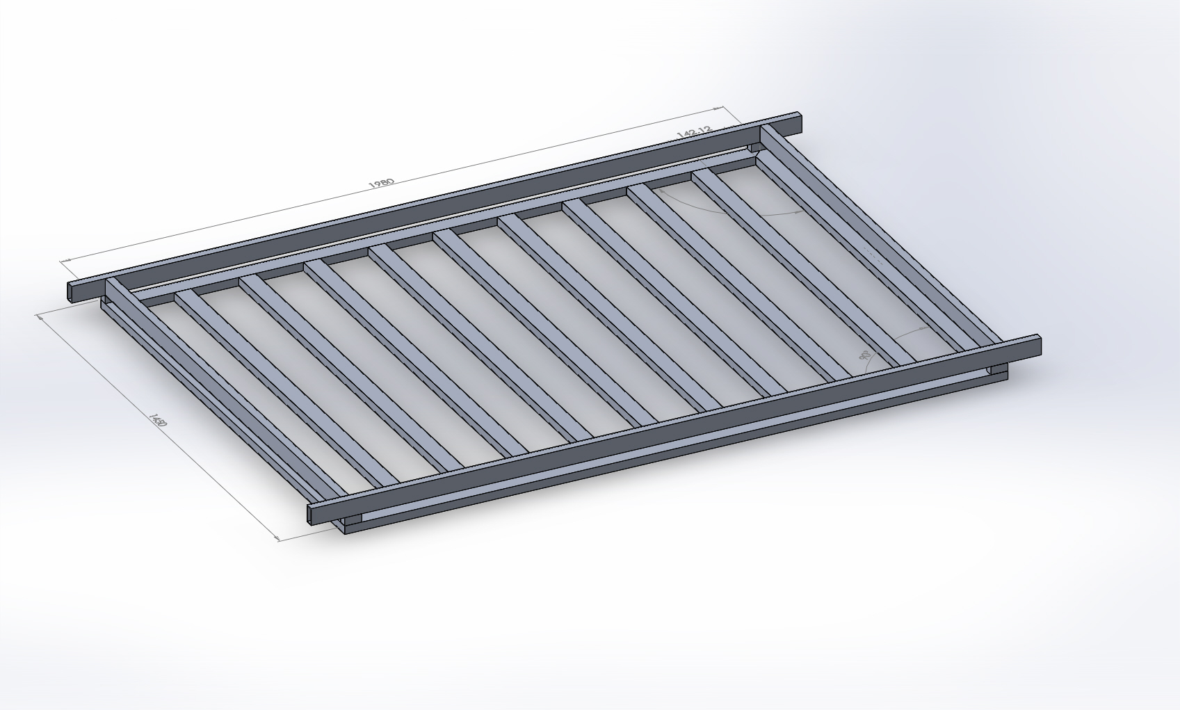

I've just drawn this bed frame up and intend to make it in aluminium box section. Without welding the software says it will be just over 20kg Have any of you weighed your bed?

Haven't weighed our bed, but I would think your frame is a lot lighter than our timber one.
Initially I wanted the bed to be mounted longitudinally, much safer to sleep in whilst someone else is driving. After mocking up the layout on the floor I was shocked at how much space would be wasted for just walking. The up side of the transverse bed is that is can also be used as a body stiffener. If the real bed weighs the same as the drawing it looks like it will be a good idea.

@SquirrellCook what was estimated cost of your ali for the frame ? I have been looking at similar , or even modding a side opening ottoman bed frame , they have gas strut assist .
The bed frame is constructed from 1"x 2" x 10g aluminium extruded box. I expect I'll use a company called "Simmal" as they have been trouble free in the past. I estimate I'll need Six 5 meter lengths. They are asking £212.00 plus vat and carriage.

Looks good.
My bed design has funny origins, as it was intended for someone else. There was a design criteria. One feature was that it would have to be able to handle extremely energetic sex! Hence it may look a little overconstructed. As it never got installed I adopted it for Murky.
As "Betty" is having a lot of structure being removed from the back I wanted to use the bed as a stiffener for the body.
Mark

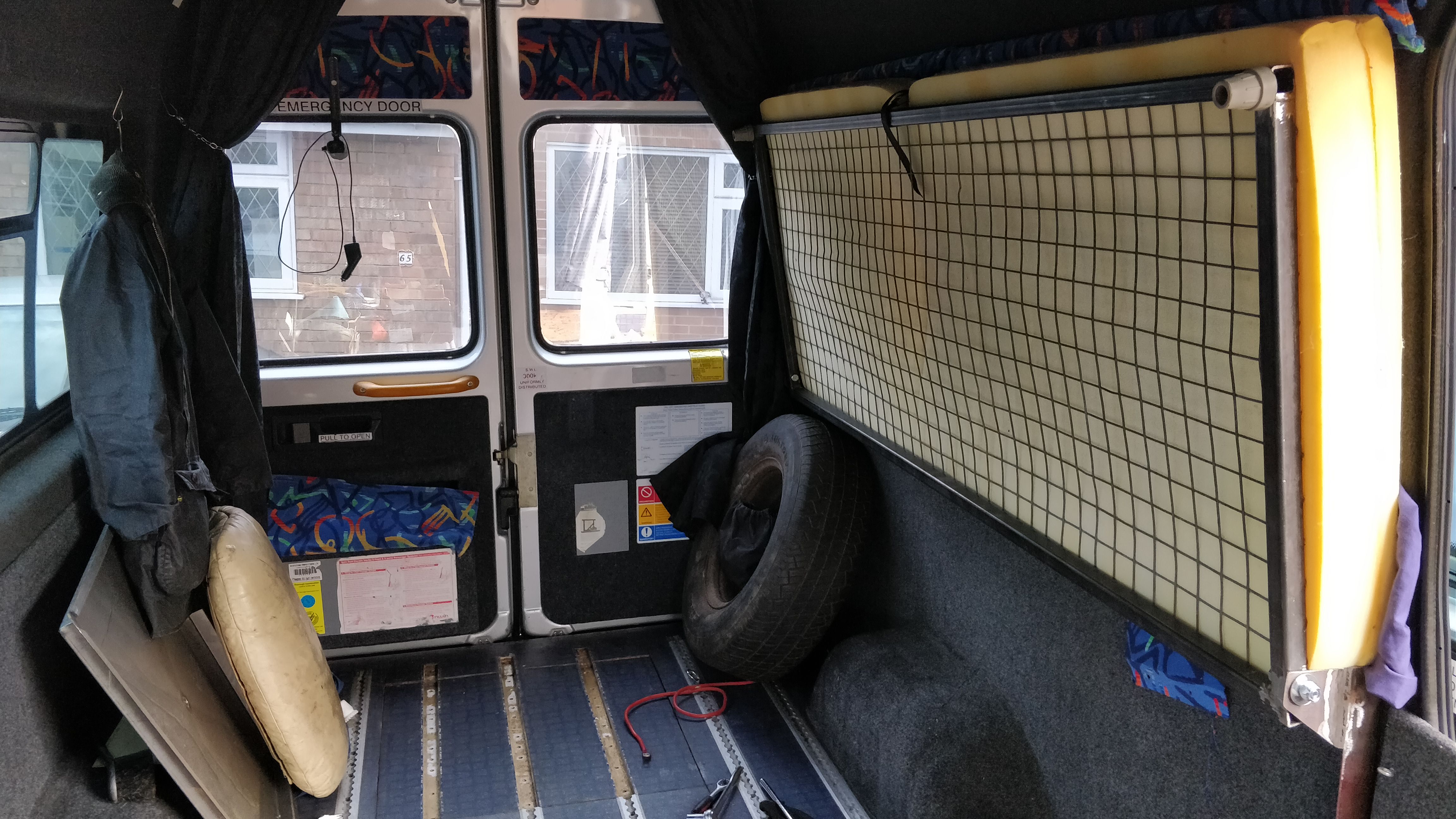

My bed folds up to allow motorbike access.
