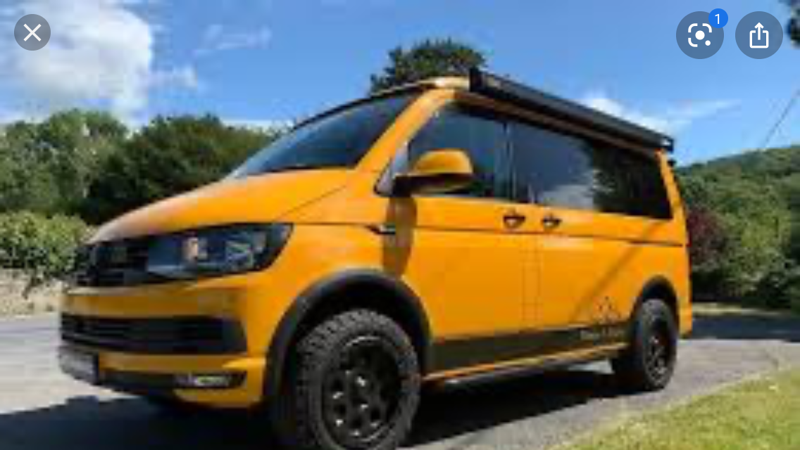

Lowering with 20inch wheels and runbber band tyres is so yesterday. The slammed look has been replaced by the swamper look with lift kits and chunky off road tyres.

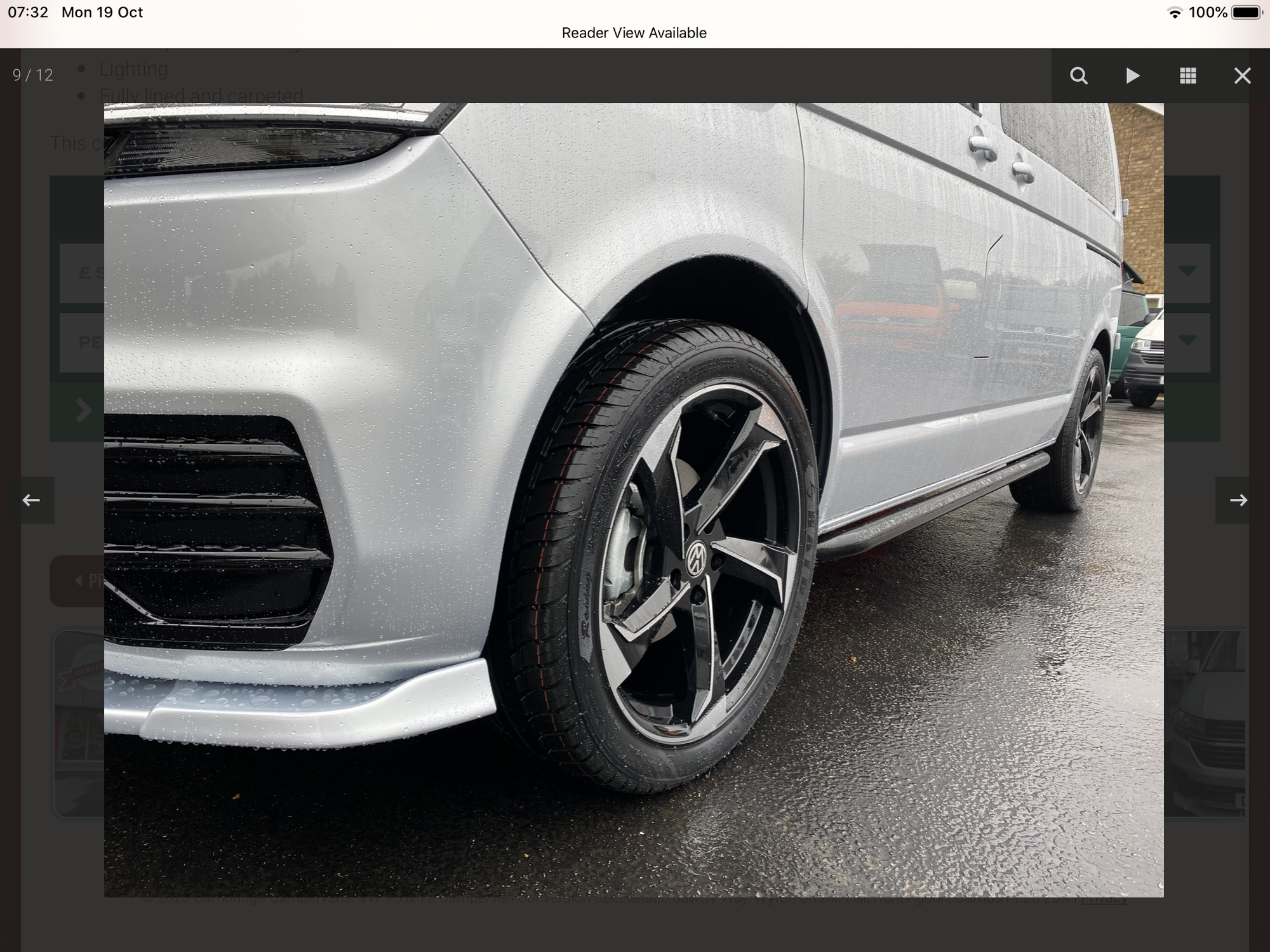

Thanks for all the replies, the standard Van goes in my garage no problem, but with a pop top on, am literally a few mm’s short, so just thought about lowering the Van say 20 mm, will give me the clearance I need.
yes, wheels/ ride height etc, very personal thing, but just love these wheels👍

Nice van lovely wheels not sure on low profile tyres though but that is me
