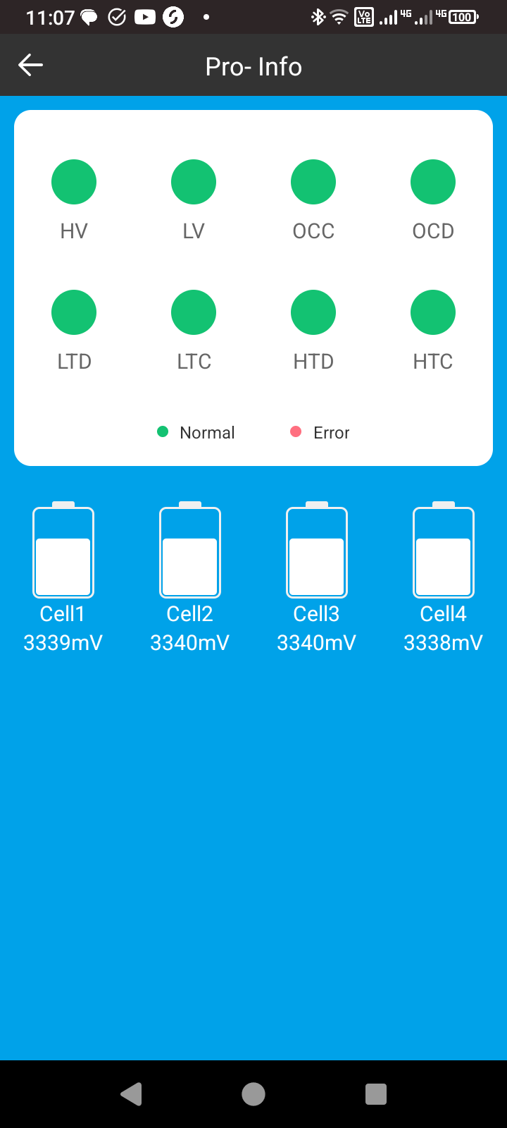

Hi All,
I Recently switched to a hybrid system by removing one of my 110Ah wet lead-acid batteries and replacing it with a 100Ah LFP from Alpha Batteries (clicky product link). I have 200W of solar on the roof (2 x 100W in series) with a Victron SmartSolar 75/15 controller. I've tried a few of the charge profiles, but the controller switches to float prematurely and I have to switch profiles and then switch back to get it back on absorption. The controller is set 14.6V absorption and 13.8V float. At 13.8V, the LFP battery stops charging and goes to standby mode. Also the LFP battery log shows lots of "COV" events (I don't know what that means) and a corresponding "Restored" event for all except the last "COV". According to Alpha's blurb, the battery is supposed to have "Victron Communication", but I'm not sure what that means and how to access it! There doesn't seem any obvious way to get the battery and the controller talking to each other!
I'm not sure whether any of this should be of concern because the system seems to work fine (albeit with me having to force the system back onto absorption) and the LFP hasn't dropped below 80% since initially fully charge.
I'd be grateful for words of wisdom ...
Thanks, Geoff
Thanks, David. FWIW the instructions that were supplied with the LFP said to charge at between 14.2 and 14.6V. It also specifies a minimum charge current of 10A ... which I'll never achieve; not with just 200W of solar and cable resistance keeping alternator current below 5A. The charge current is considerably higher at 14.6V than at 14.4, but I've dropped the charge voltage to 14.4V... but I still don't know what "COV" means (charge over voltage?)
Re. "COV" ... the app says, "Fully charge or discharge can recalibrate SOC", so "COV" might be something like "Calibration on voltage"? I really don't know and couldn't find anything in the (fairly comprehensive) manual about either the log that the app makes available, "COV", or even "calibrate".
I am not sure what COV stands for - Charge over Voltage sounds a very plausible meaning.
just for extra info ... the reason why you can get a charge error even if the voltage is under the maximum quoted is that the maximum quoted is based on the maximum voltage allowed of each cell. If the cells are not in perfect balance (and they rarely are), then you will hit the maximum voltage of an individual cell before you get the maximum overall voltage.
FWIW, I have similar batteries to you - 2 Lithiums are from Alpha and are heated 'Polarmax' models in a Hybrid configuration (3 x Lead Acid, 3 x Lithium) and I cut charge voltage to the Lithiums at 14.19V which is fully charged. The charger then continues to provide a charge to the Lead.
I would have said lower to 14.2V for you except that would not give the lead the full charge it needs. 14.4V is a reasonable compromise.
Wire in parallel and devide 14.6 into 200 gives about 13 amps top
COV = Cell Over Voltage, one or more cells being too high. I had this problem in Spain in erly March, with Cell 4 roaring away which caused the Solar charging to cease, although Cells 1-3 were still quite low, resulting in Bulk Charging ceasing at around 13.3v. Solution was to buy a Victron IP64 Charger, amend the max Cell Voltage limits, and do a Top Down Balancing exercise over almost 3 weeks, initially at 14.0v and finally at 14.2v when we returned to Scotland. Lithium hits 14,23v regular as clockwork now before dropping back to 13.5v Float
Steve

That seems to tie in with the AI summary Steve. Although their definition of the abbreviation COV is different the cell balancing recommendation seems to agree with your solution so sounds a good path to follow.
You would think the BMS would handle this though?

I now have a 110Ah wet lead/acid battery in parallel with a 100Ah LiFePO4.
Thanks for that. I've re-set the absorption voltage to 14.4V and not seen a logged COV since (but it's early days!) That said, the LFP hasn't achieved a 100% SOC either -- but that's probably not a bad thing...

Thinking about this, it makes sense as that's just the BMS stopping charging when the battery is at 100% SOC. So, it seems it might be an error, but it's just the BMS doing what I'm relying on it to do by default. Seems weird, though...
My MPPT has an equalization option, but it's set by default at 16.2V and I'm not sure whether that's the same thing as cell balancing. Typically, the cells have a differential of less than 0.005V except at very high SOC, when it can get at large as 0.1V -- high enough, as @wildebus mentioned, to put the highest cell into an 'over-voltage' state. I'm planning to buy a mains charger at some time to take the battery back home to rebalance. However, I suspect I won't need to do that until next year.

Geoff. Depending on which BMS was used in your battery the balance current that's drawn from the strongest cell can often be tiny, it therefore takes ages to drag that cell down to a similar level to the lowest cell in the pack, this problem is often exaserbated by the fact that a lot of BMSs only provide cell balancing while the battery is actually being charged or even worse being charged above a set current. (maybe this is the 10A figure that you mentioned?)
Take a look at the BMS settings and see if there's a 'balance' setting page where you can set the charge current when balancing commences and set this as low as possible, ideally there'll be an option to make balancing happen continuously or ALWAYS, so the cells will balance constantly.

NEVER use the equalization option with Lithium. If it say a Victron SmartSolar, when you select the Lithium profile that is disabled. Also if a Victron disable the low temp disable feature as well for your setup.
Thanks to all for the help.
I honestly would not bother. A decent Lithium battery is balanced as needed prior to shipment and will do the neccessary self-balancing with no user-interaction.
I just had a look at my Polarmax batteries to see the cell voltages (batteries are at around 78% SOC)
The only time I see any significant variance between cells is in times of high charge or discharge, which is what I would expect. When the batteries are pretty idle, the BMS will (or at least should) do some gentle equalization.

I *think*, Rob, that the BMS takes an overall view, rather than looking at the individual cell levels; however, the Roamer Smart 4th [?] Generation BMS has active Cell Balancing built in [mine is the previous generation, so lacks this sophisticaton, and at only 16 months old, I can't justify binning it, having paid just north of £1,000 in the January 2024 sale! The irony is that the Roamer reports cell levels to 3 decimal places, whereas the KS Energy predecessor only reported to 2 decimal places, so, whilst Roamer made me panic with 3.311 to 3.328v, KS would have have shown 3 cells at 3.31v and one at 3.32/3.33v, and I would have lived in blissful ignorance until the much cruder BMS copped a strop and the battery went into a coma that may or may not have been possible to wake from ... 'See a problem' spend £££ to solve it, create another problem that causes angst and costs ££££ to resolve' seems the way of the world at present; but then I had the DPF Sensor failure to distract me from BMS problems ... :ROFLMAO:
