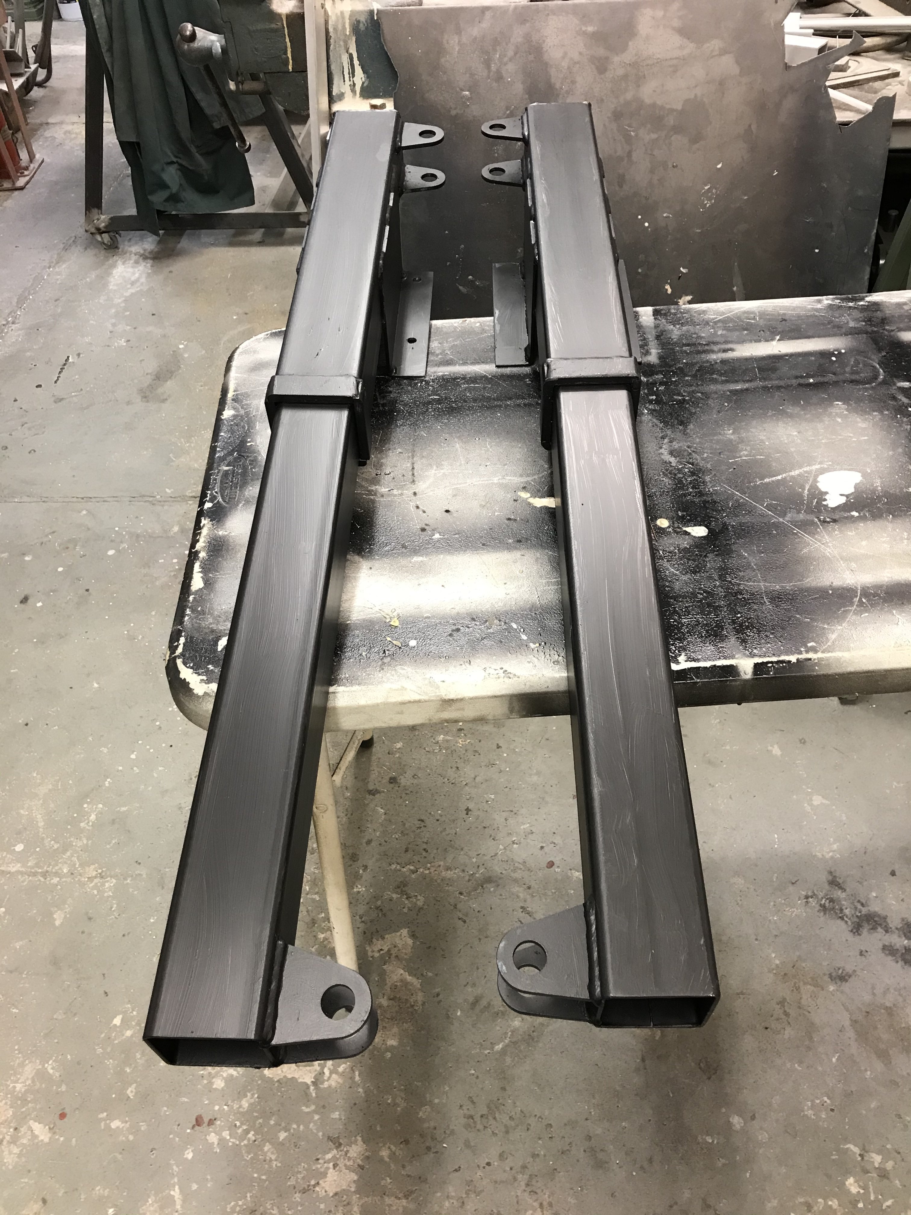

First coat of rust primer, I did intend to have these fitted this weekend. At least it’s progress. Still have to purchase some rams and a power pack.
As you are lifting the chassis, presuming the body will sag (might not) how are the determining when level, just communicating with the co pilot?
The body is extremely well attached to the chassis, it has to be by law. There will be no sag. It has air suspension on the back and it does have a habit of deflating. So if parked for any amount of time the legs are to hold it. Though I expect they'll lift it. Any levelling will be done by eye and argument! Each ram will have a simple push button control.
