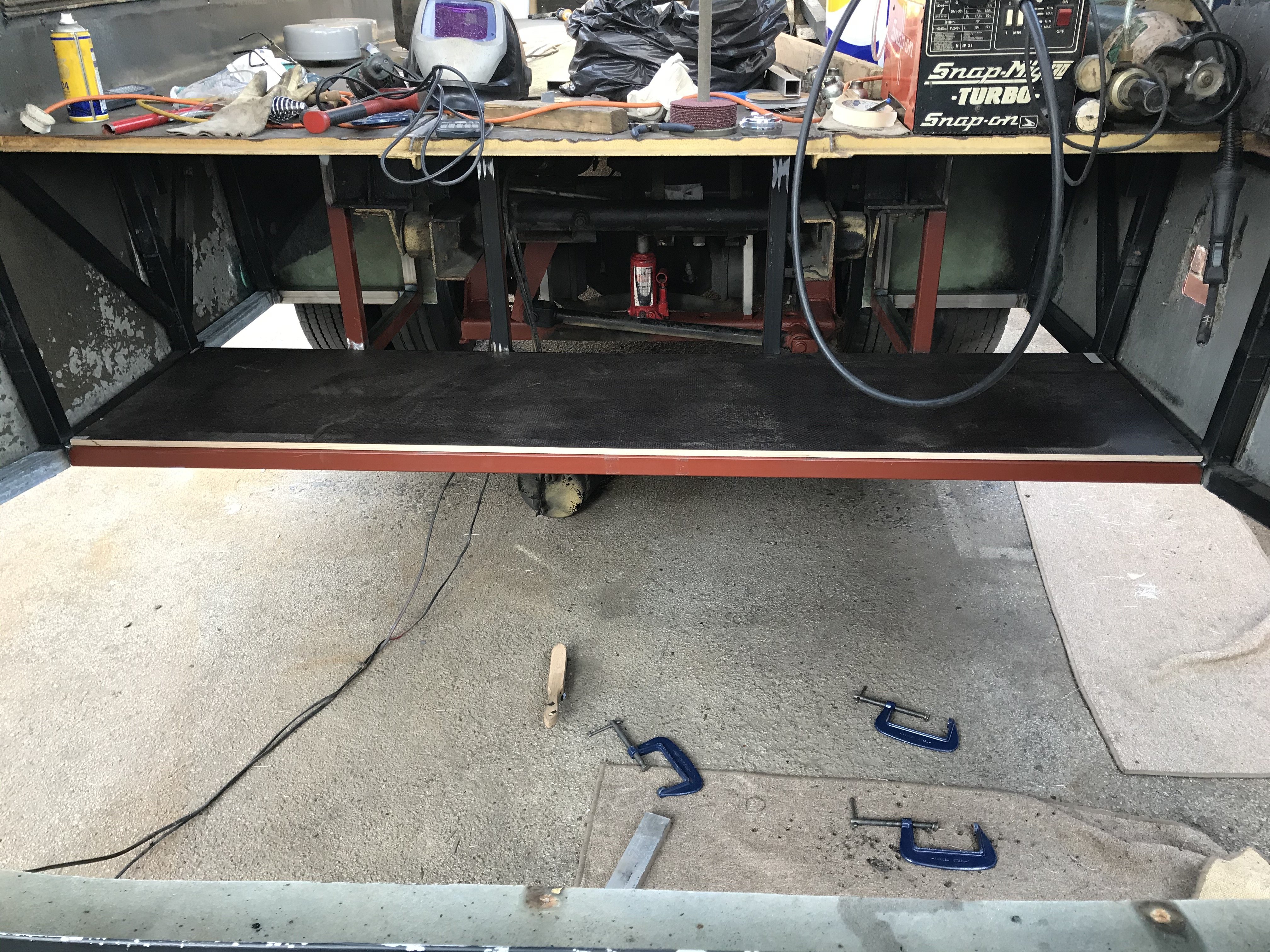

So a bit more about why I want to do this.
The Mercedes Vario has a body control module that appears to be able to do much more than it does on Betty. There are other electronic control modules on it. Engine management, Retarder, Air Suspension and I expect others. All communicated to by the body control module. On some coaches with full air suspension (still springs on the front) it's possible to make it kneel or level when parked. I only have rear air. Over a day or so it slowly lowers itself. I've replaced most of the pressurised parts and it still does it. Hence the easy way out is to jack the rear end. Because of the way it's made I'd rather not jack the body. Even to change a rear wheel it will not be fun as you can't reach under it with a normal jack.
From what I can tell, the suspension electronic module should be able lift it on demand, but as I'm unable to find anyone that is able to play with these parts.
Hence they way out of these fun and games is extendable lifting legs off the chassis. Fortunately I haven't closed this area in yet.
In the picture you can just make out the ends of the chassis I need to attach to.
The red beam that the bottle jack is on is the only sensible place to jack it up for a wheel change. It's sat on ramps at the moment that makes it look like there is more room under it than there really is.
