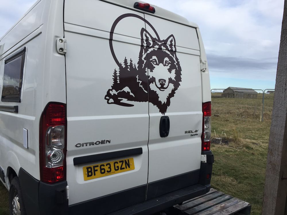

We got the diesel heater fitted and tested yesterday and although we haven't quite finished the bodywork repairs yet, as the decals had arrived, we couldn't resist fitting the rear door decal -
Phill, do you have any plans to get rid of that small dent in the otherwise immaculate O/S rear door?
Did you have any problems attaching that graphic? No matter how hard I try, whenever I have put any on I always get some small but noticeable trapped air bubbles which has seen me rip them off and throw them away!!
Looking really good, I bet you are grinning like a Cheshire cat...
Phil
Phil
Ha ha, yes, funny how clearly it shows up on the photo, never noticed it till I took the photo! Gareth has a paintless dent pulling kit which should pull that out fine.
As for the graphic, it’s covered in tiny bubbles! I’m consoling myself with the thought that they’re not so obvious unless you’re close up. It was a quite windy day so we probably shouldn’t have done it but I’ve never been big on patience ;). Hopefully the side decals will go better.
