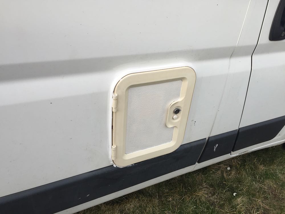

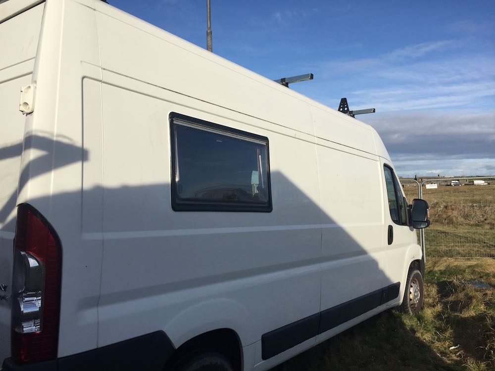

Well, it's another very windy and wet day today here in Westray (can you see a theme developing here :rolleyes: ) but actually that's a good thing - kind of...
Yesterday was a cracking day and I managed to get a window and the toilet cassette access door fitted, so today they're getting thoroughly weather tested - no leaks so far!

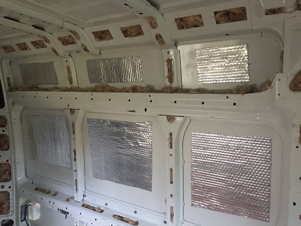

I've been inside the van today bot to check for leaks as above and to make a start on fitting Dodo Deadmat sound deadening sheet -
Whilst doing this I also got first-hand experience of the need for a vapour barrier.
When I started the job the mat was sticking back to the panels a treat. After not very long, say around half an hour, I found the mat was not sticking and realised that it was because the panels were damp. As they were fine to start with one has to assume this was just due to the condensation from my breath.
I had always intended to install a vapour barrier over the insulation once it is in place and this just re-enforces why it is necessary.

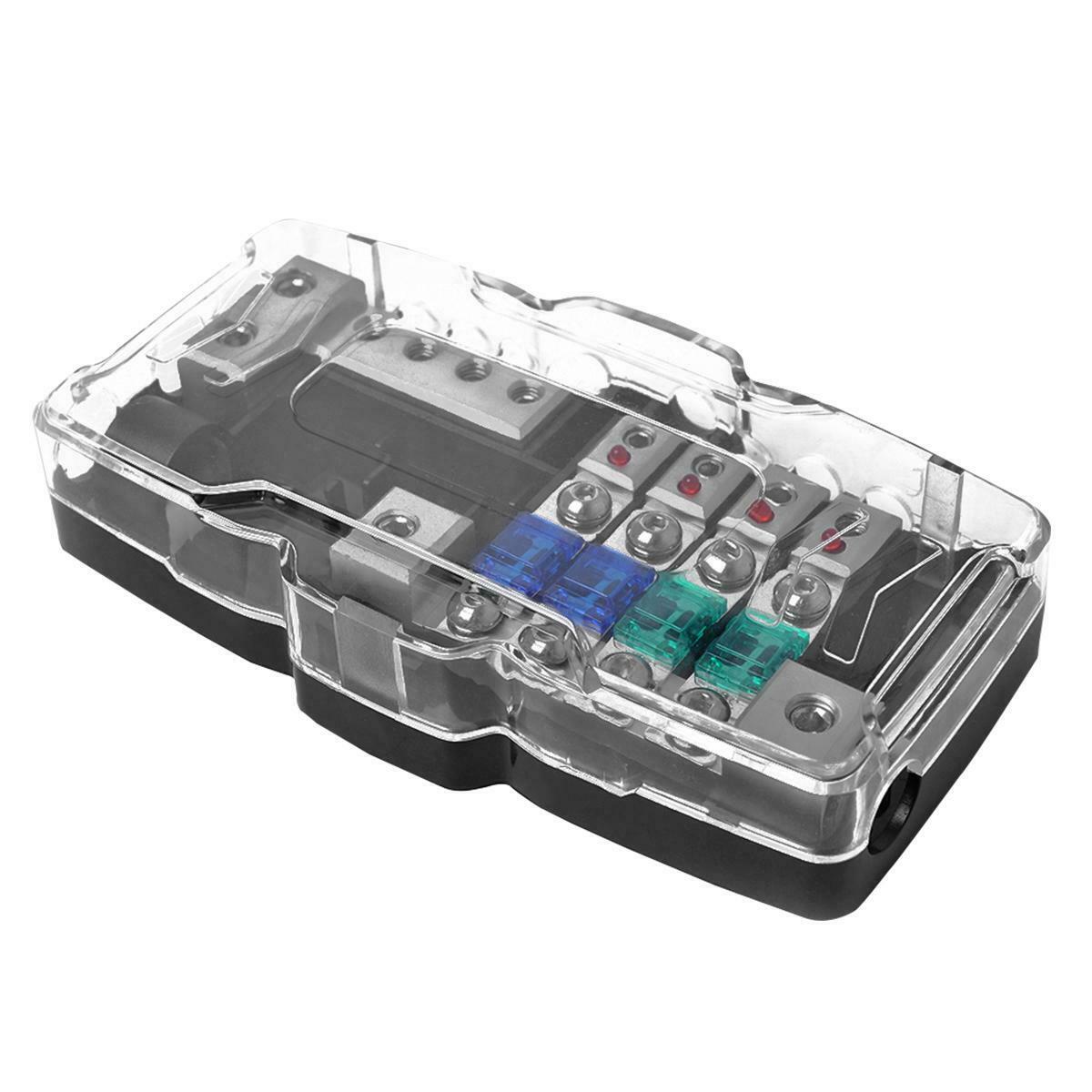

Mr Squirrel says he likes Idiot lights ... the Fuse box picture he posted is the same box as in my photo but shows the cover you get and the full size it is. I would recommend those over the fusebox you posted TBH. The one you showed is decent and I have fitted quite a few of those and have them in my own van, but the one with the clear cover and LED lights have a definate advantage with the indication plus the built-in 0V Busbar which is a nice feature - and I have tended to move to those boxes now as they are better value than the one you shown + the extra Busbar.

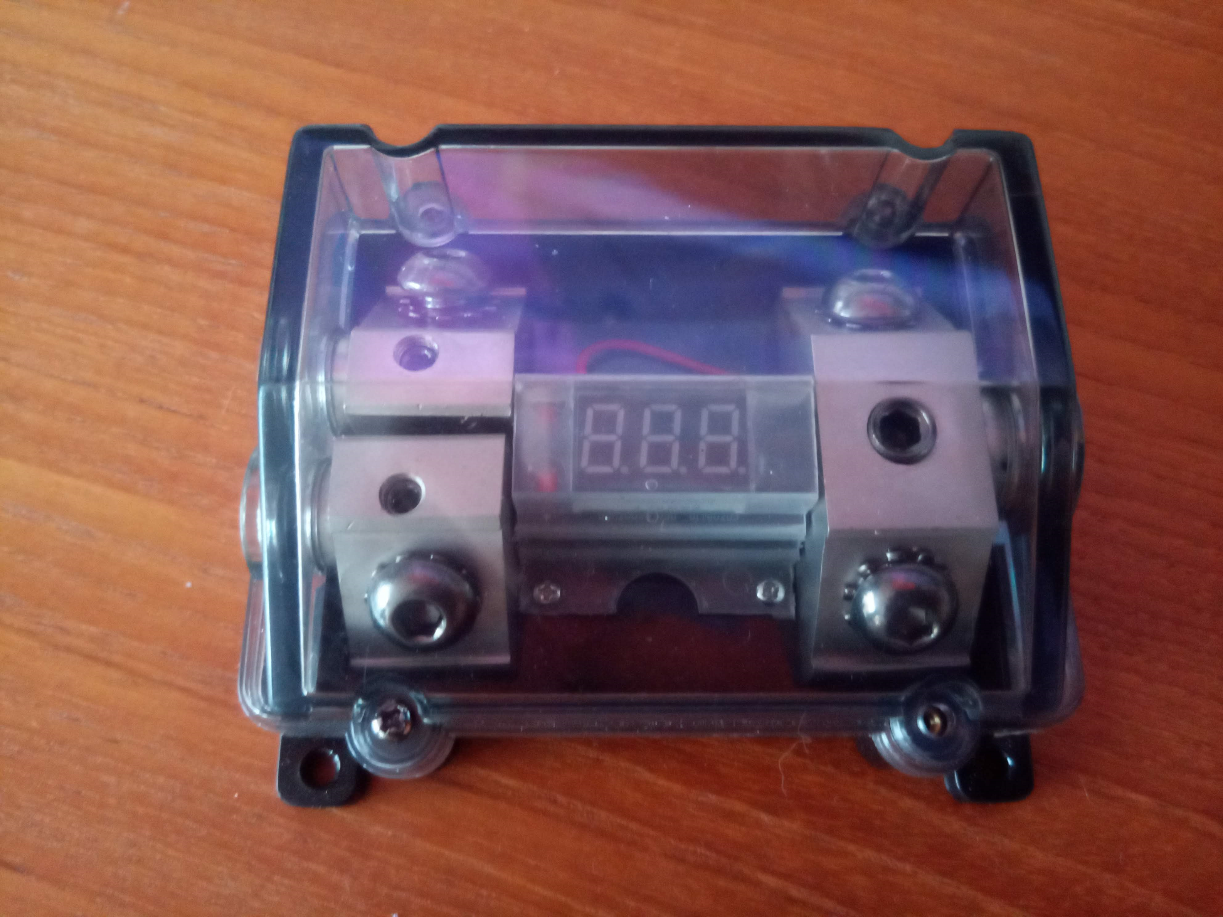

As a separate fusebox, this is a nice unit ...
This has an LED for two seperate fuses (so one input and two outputs and supports a much higher current than the Midi-fuse fuseboxes and larger cable gauges (this one is an ANL-Fuse Fusebox). What it also has is a built-in Voltmeter, which is pretty novel.
I do like the look of that but have already bought the other (bad weather might stop me working but it doesn’t stop me shopping, ha ha)

That is an excellent price for that!
Thank you! I was going to use one of these:
But I like the lights. The older I get, the more of an idiot I become (so I'm told)
Those are good. Usually available at a bit better price, but the one SquirrelCook posted is defo better value.
