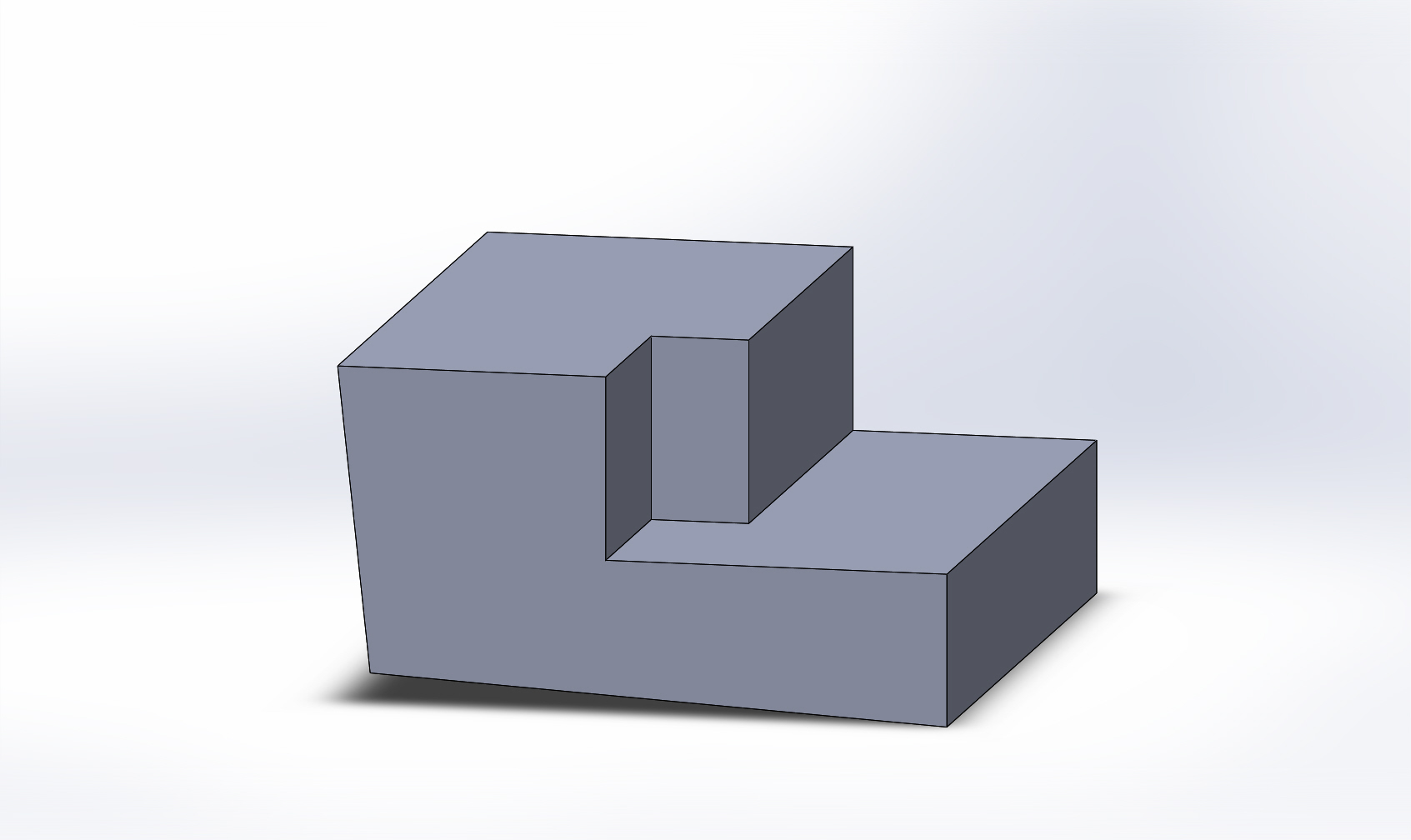

I'm up to 400 litres, but space isn't easy to find. Because the tank is going to be bolted to the chassis I might have to build some structure inside it.
It end up being hung in a single plane with the weight badly unbalanced. :(
It end up
I'm guessing that you are aware that 1ltr = 1kg that's an awesome amount of weight to be carrying around plus the weight of the tank ? 🤔. Phil
The face you are looking at is in front of the rear wheels. The notch is for the front of the leaf spring if it had them (air suspension on the back)
So the top face on the right hand side is the face that bolts to the chassis. I expect I'll make that in 5mm stainless and extend it to the bottom of the tank.
The body is fully rubber mounted so I can't support it from the left hand side.
This just playing at the moment in the space removing the spare wheel carrier left.
