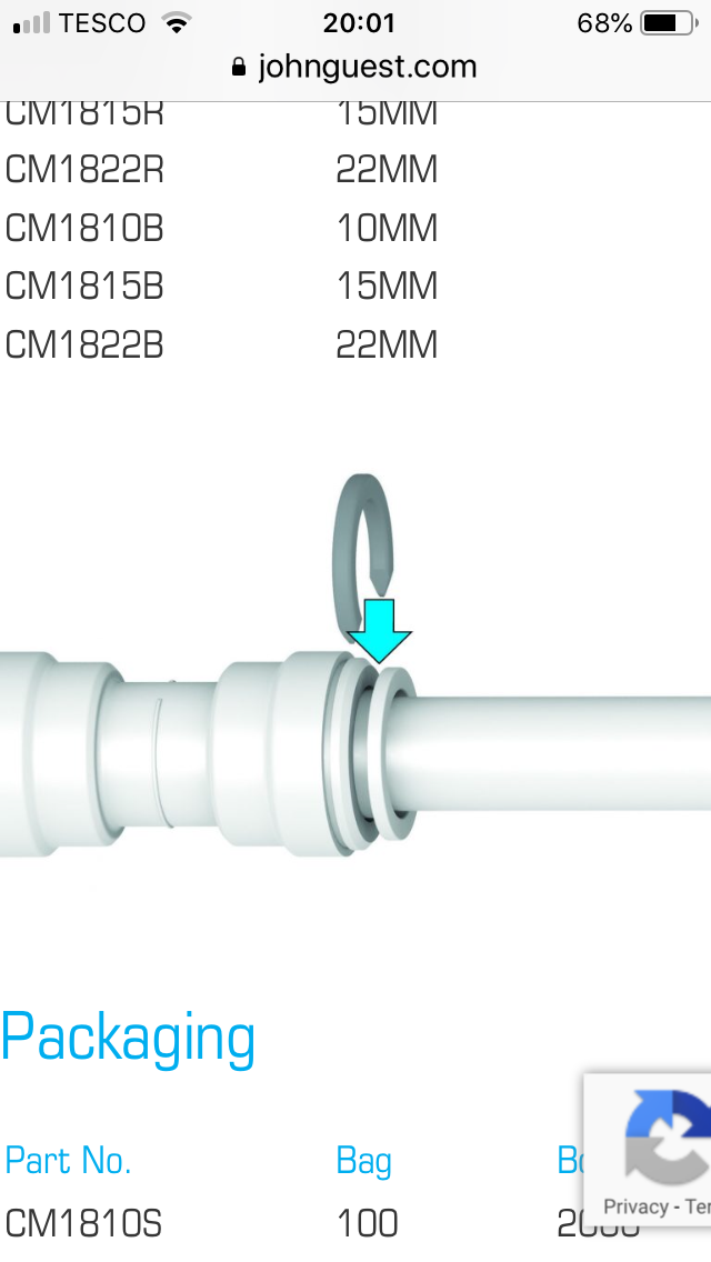

Another question- should I get & insert these collets in the joints
