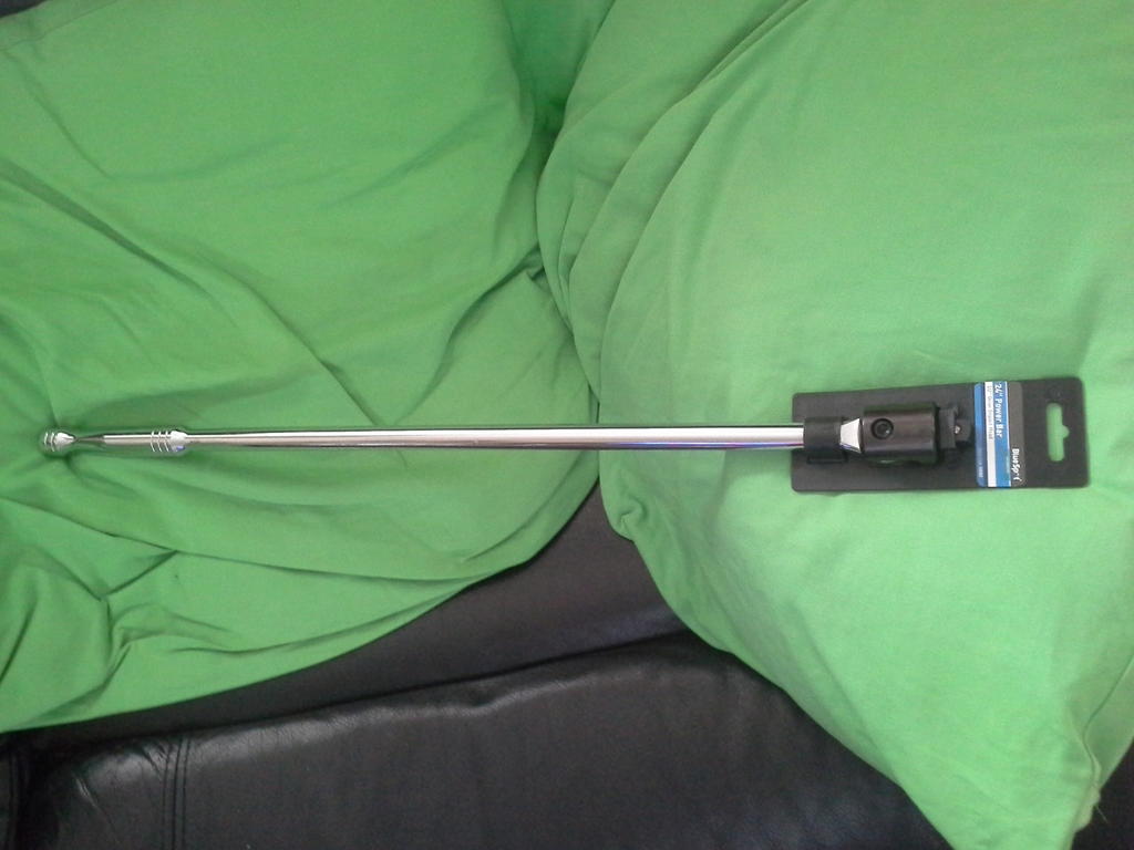

1 ton hydraulic jack from Screwfix. Mahoosive extention bar for the nuts. Yes, I have AA but that’s no use if you don’t have a signal.

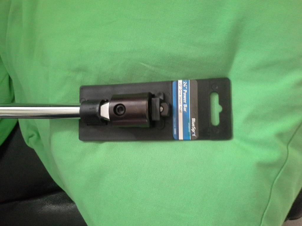

Channa
£10.00
7/8 scocket and this £10.00 @ proper job bridgwater.
Should do the job of getting nuts / wheel off
