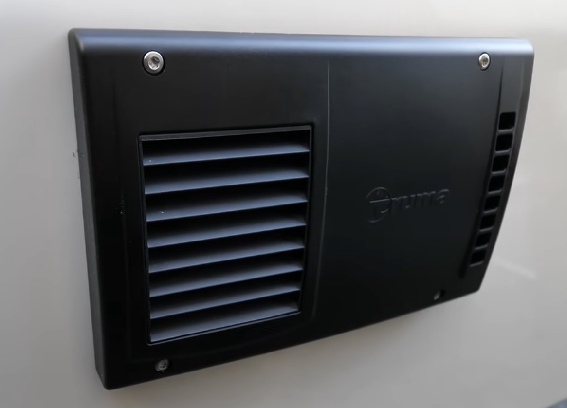

There are two versions of the Truma diesel combi. The older Generation 1 version had a rectangular flue with separate air and exhaust inlets and looks like this.
The Gen 2 version has a balanced flue with a single round external vent that is almost identical to the gas version except that is black and includes a spacing ring. It fits the same hole as the gas combi one which makes swapping from gas to diesel much easier. The Gen 2 version has more sophisticated combustion control than the Gen 1 version. Perhaps the two versions sound different.
I have heard Eberspacher type diesel heaters that sound like a jet engine winding up but honestly this is not my experience with the Gen 2 Truma diesel combi with the single round vent.

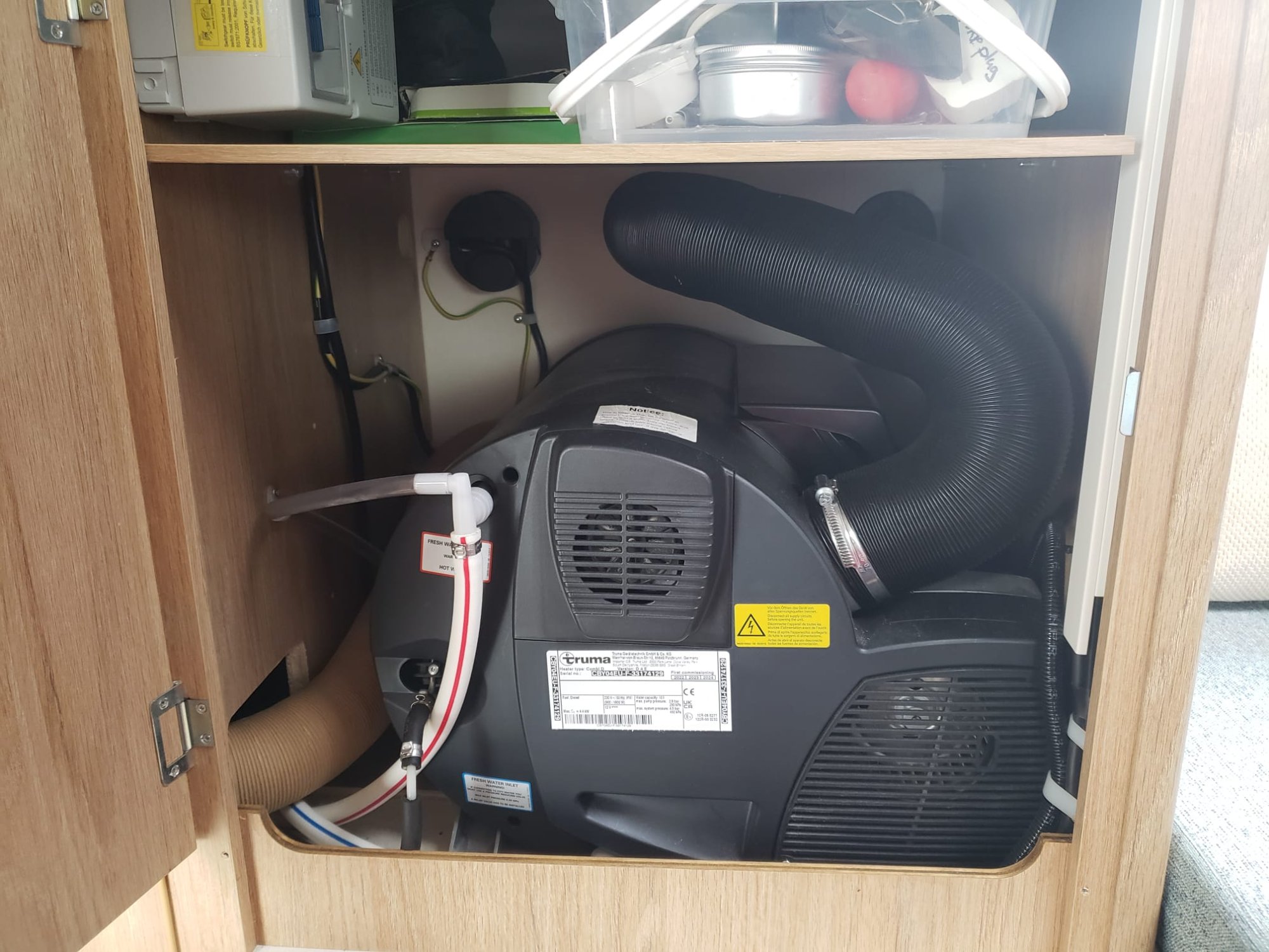

Here is mine, inside it's cupboard.

It's a Combi D version D4E
The exhaust vent is just a small round vent on the side of the van so unless someone tells me otherwise I suspect it draws it's combustion air from inside the 'van? It is that thick black pipe that runs from the heater to the flue vent.
You can see two griles on the inside behind each is a fan. One controls the flow of combustion air, that runs when it is heating anything and that is the noisy one. It has a long shut down (presumably cooling) cycle after the burner has finished firing. The other fan is to circulate heating air to the room when it is space heating, that one is not very noisy.
I would be interested to see a picture of the inside bit of the quiet ones. I suspect we are talking about 2 completely different heaters and if so mine is the one you should not be specifying in a new van.
That looks like the standard balanced flue set up, the outer pipe is the air drawn in, inside that will be a pipe for the exhaust.
The top fan you can see is just a cooling fan for the combustion fan motor and board. Combustion air comes from outside the van and works the same in both gas and diesel heaters. Ducting air comes from inside that cupboard through the bottom fan.. Now I have seen your installation I am not surprised you find it noisy. The vast majority will not have such an installation.
So what about my installation makes it noisy? Is it that it's in a waist level cupboard with a poor fitting door so you will hear the noise easily vs and under seat locker likely to block the nose a lot more? Or something "wrong" with the install?
My D6E looks the same as your D4E.
The combustion fan is inside the unit, it is room sealed and you can not see it. It draws air in from the outside of external vent which is warmed by the exhaust gas flowing through an inner tube to the middle part of the external vent. The big visible fan on the boiler is the hot air circulation fan and the smaller one cools the electronics. If the small one is making a lot of noise then I suspect the unit is getting too hot. This could be caused by too little air circulating through the hot air circulation system which plays a big part in keeping the unit from overheating. The heat that the unit produces needs to be circulated through the living space and drawn back into the unit for reheating when it has cooled. If this circulation is not as effective as it should be then the unit could get very hot. I suggest this might need checking. From one picture it is difficult to tell whether there might be an installation issue but I have been looking at the installation manual and can see a couple of areas that might be worth looking at.

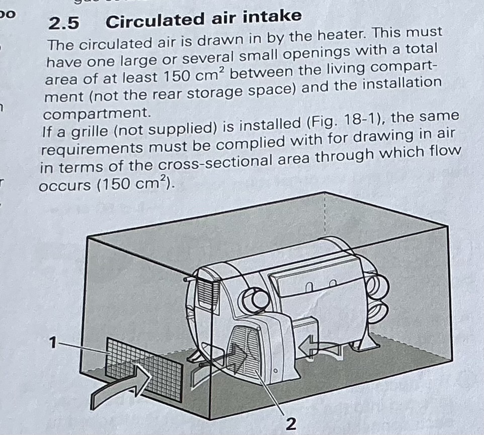

Firstly I can’t see a vent in the door or boxing near the circulating fan. This is a picture from the manual.
Secondly I can only see one hot air duct leaving the boiler, there should be four but only using 3 is allowed. If only 3 outlets are used the redundant one must be one of the lower outlets and it must be blanked off with a special moulded part. There may well be other ducts I can’t see in the picture but you do need to make sure none of the heated air is escaping directly into the boiler enclosure because this could be the reason the small fan is having to work too hard.
Thanks, there are 4 heater hoses exiting, the obvious one goes to an outlet to the main room close by and lower left to an outlet in the wc. The two right ones go to outlets at the front of the main room.
I can't see it complies with that 150cm air flow. There is a gap at the bottom of the door about 1cm by 30 cm. But surely that is only an issue when heating the room? When just heating hot water that room circulating fan won't be on. In any event I will try it next time with the door ajar to ensure enough ventilation.
