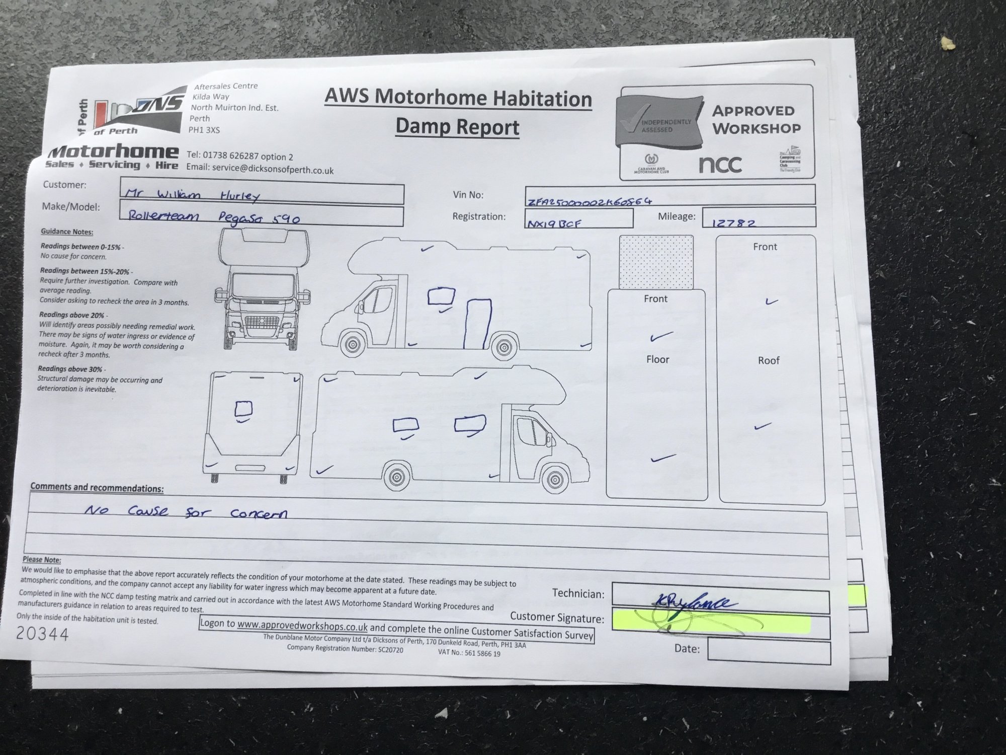

I have had three checks carried out. The first paid for by catterick caravans, and owing to a dispute with Roller Team they paid for the last two. So I have not been conned. The first two checks were carried out by catterick caravans, and the last one in may by Dicksons of Perth, were I have just ordered a new van. All three checks included drawings showing the areas checked for dampness. So what you are saying is that both dealers are conning people, not just the one.
I have attached the report from Dixon’s of Perth who did the last check. Also I can take readings myself, three months after getting my van I got a 23% reading below the small lounge window on the O/S. This was caused by a faulty seal, and the dealer had to refit this window.
Leakes can develop were there are joints or openings.
I am aware of the forced ventilation and were these areas are in my van.

The damp report must have been based on a visual or tactile examination only. If the van has a GRP inner skin a traditional 2 prong electrode damp meter will not be able to take readings. GRP does not conduct electricity which is fundamentally how a damp meter reader works. Any surface moisture or ponding as a result of seal leaks or drips should be obvious from a visual or tactile examination.
That is the logic. Could an engineer or scientist disprove this logic?
EDIT:- There is a meter reader used in the marine industry to check GRP composite boat hulls which uses high audio frequency signals to detect moisture. Costs around £700. If you have a modern van with a composite double skinned body and your service agent is claiming that a damp check can be carried out, ask them what type of meter reader they are using. If they are using a reader used in GRP composite marine technology that is high frequency audio based then you know you are being offered a genuine systematic test:-

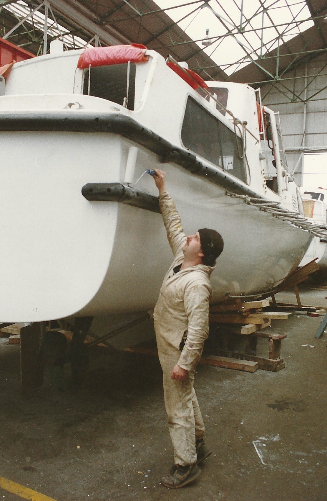

I don't think they would use that meter. It is is looking for water within a GRP structure. Boats can develop what is known a osmosis. Small cracks and holes in the gelcoat top layer allow water into the matting layer. The chemicals used in the GRP then absorb this into the GRP. You get a distinctive bump in the top coating and, if it gets more severe, those blisters burst. A big problem in boats although it usually happens after many years in the water unless there was faulty layup in the GRP from the beginning.
I believe a motorhome is unlikely to get osmosis unless immersed in water for some reason, or very old, or a terrible build. You would look for it on the outside, not within.

Correct, hence many boats that stay in water 24/7 are two pack poly painted, will not be a problem for MH.
