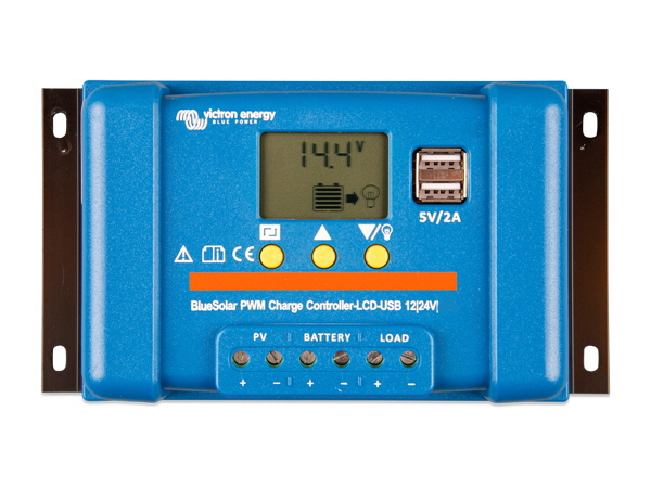

Post a pic of the area and the panel it might help us to help you betterIt's parked on driveway not connecting to electricity. I'll flick all the fuses off then before I try to remove the cover will be after lunch before I get a chance to do it
Kev, I am going to assume you have never fitted a Victron Solar Controller?My twopenny worth, I think the connections themselves are all the same on any I've fitted,
the panel on the left, the battery in the middle and usually the load on the right, I've never seen the load connected to anything yet.
The terminals usually go + - + - + - Red being positive, Black negative.
As for the setting I can't help there.
