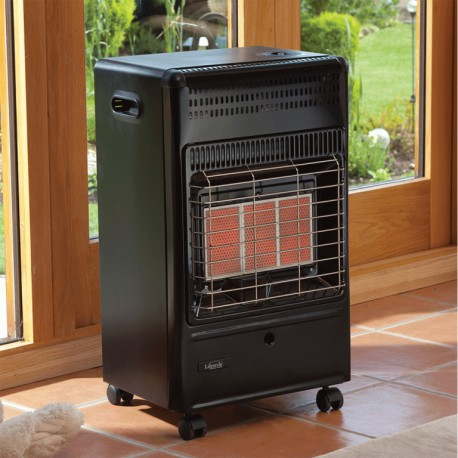

My husband says that you get too much condensation from the calor gas heaters so you would need to open the windows thus letting out all the heat. This didn't matter when old houses had air gaps everywhere but modern houses are now hermetically sealed and tested for air gaps

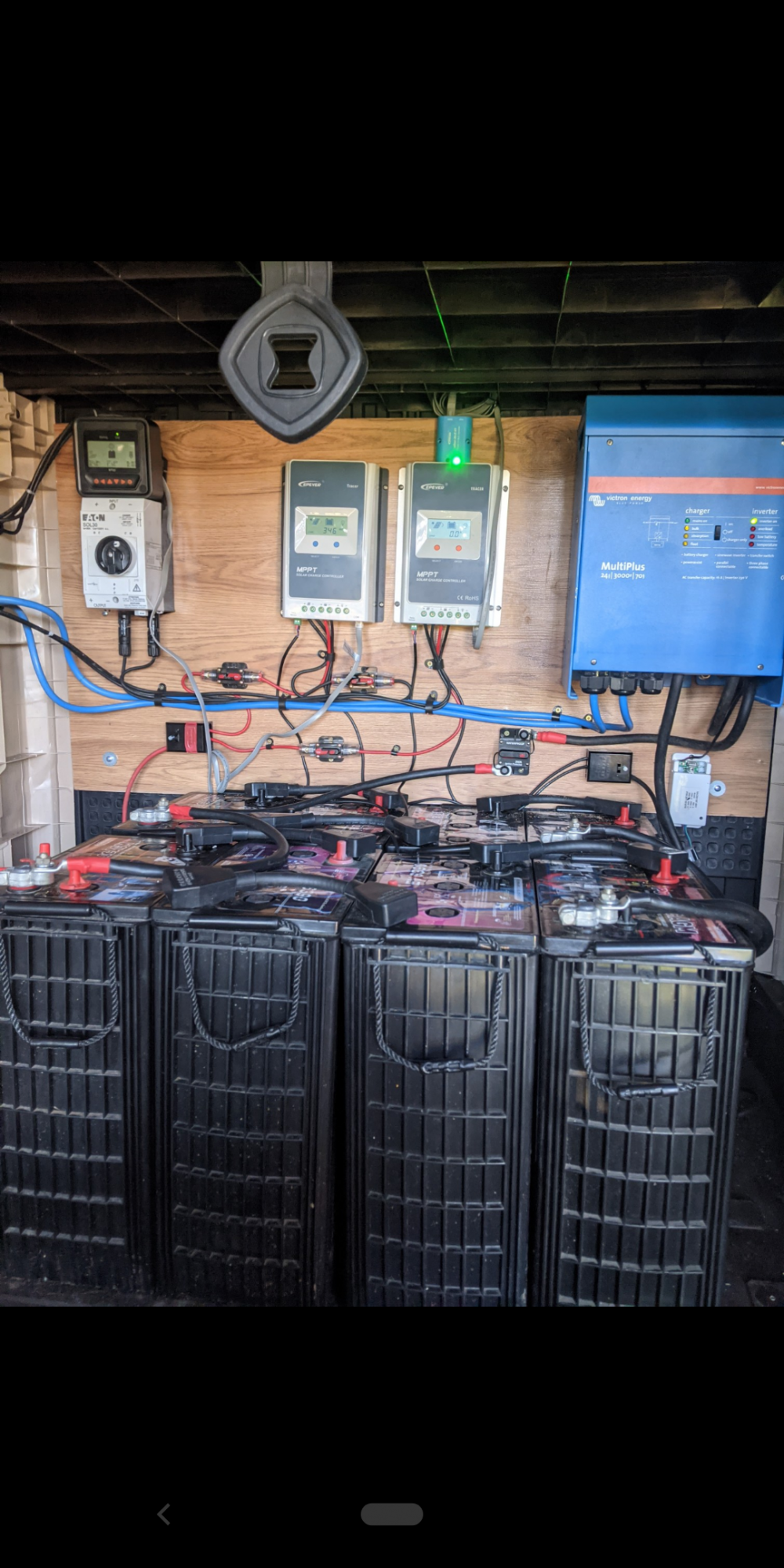

Like this!
Been living off grid for 5 years now and the system is still evolving - few more changes since this pic.... Needs help from the generator during December and January maybe a couple of times a week, but apart from that everything runs from the two banks of solar panels.

No power cut worries here 👍

Excellent. I would like that at mine.
My old boss on Isle of Eigg. This has been posted before. I wonder what improvements have been done since 2011.
