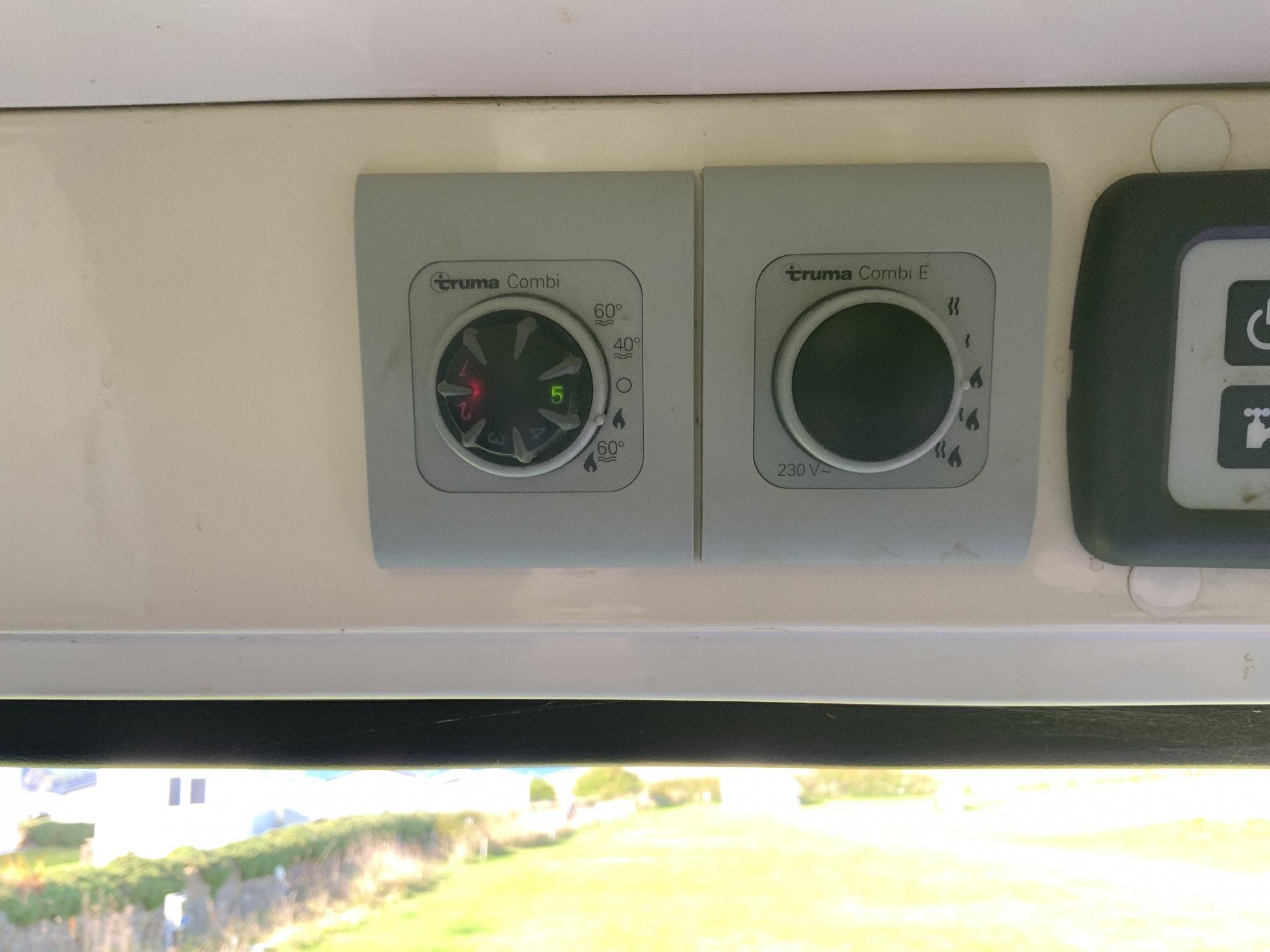

So my combi boiler seems fine on mains electric but nothing happening on gas except the control knob flashing red, I know there is a ‘slow burn’ fuse on the boiler but can this be the problem if it works ok on mains? ,it’s the older ‘2 knob’ type of controls. The gas is on at the distributor and it powers fridge/cooker so gas is available, regards, rog
If you can see the led on the control card the # of flashes will give the fault code. When you say nothing happening except flashing red is it selected on the control for gas and not elec and does it make any attempt at going through the start sequence.

It’s the one on the left that flashes, not immediately about 3/5 seconds, no it doesn’t run through the start up sequence as far as I remember it used to pop a bit then whir into action, thanks so far

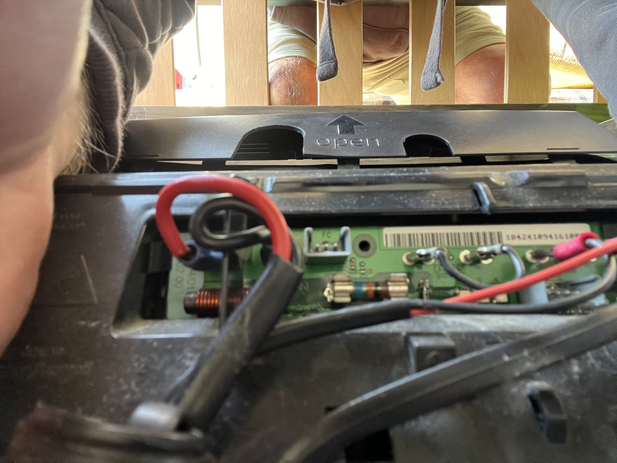

I think that’s what i used to hear but it’s not doing that any longer, I have a Sargent EC328 but it doesn’t have a fuse for the heater, I’ve removed the cover on the boiler and there is only 1 fuse in there ,it’s not easy but here’s a photo as it’s facing the other way
Hi, thanks for response, there is only 1 fuse which the manual says is a ‘slow start’ 10 amp as pictured, this may be the culprit but it’s a special fuse and a bugger to reach, no one has used it since it last worked correctly, gas tank is under slung and there is a distribution valve under sink and boiler has its own feed from this ,I “guess” it’s some kind of pizza starter but there is just silence when I choose gas on the dial, it’s not going to cause me a big problem as we can make sure we have ‘hook up’ wherever we stop on the way home so I can get it looked at when we get back, I just hoped it was something as simple as a fuse but he-ho not to worry, thanks for all the replies .

From the photos yyou have a Truma Combi. More than one model type (2E / 4E / 6E )
This page describes them. Can you confirm a model number.
Very rare (and dangerous!) to have a circuit without a fuse.
You need to test every fuse in the EC328. People have been know to piggy back from a fuse.
also worth while having a hunt around for other fuses (often in line fuse) and if you find any make a note of where they are
The photo shows a 230v "slow blow" fuse, readily available
But I doubt this is the cause of your problems

Pretty sure it’s a 4E, tried the ‘re-set’ to no avail but while I was under the bed I found a small fan heater I’d forgotten about so at least we can stay warm, thanks again for all your efforts

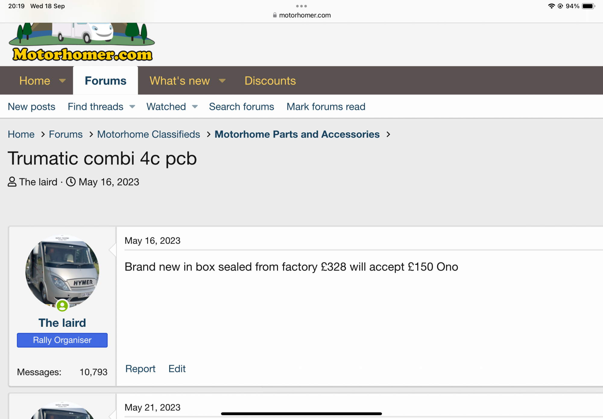

I have a new pcb here in ye box from truma
Can let you know the model £80

Looks like the set up we had on our caravan. The red light then shut down after a few seconds was when I hadn't removed the external cowl cover ...:rolleyes:. This was a common oversight at the start of the 'Heating Season' ...

Are any of the leds on the card flashing. There is also another fuse on the lower card that you cant see without removing the full cover
It would point to a power selection issue. Either control switch possibly which are linked together with a short data cable and then another long data cable down to the boiler. I have had to change my long data cable in the past. They are just chea RJ45 cables if needed. Dont buy expexive Truma cables
