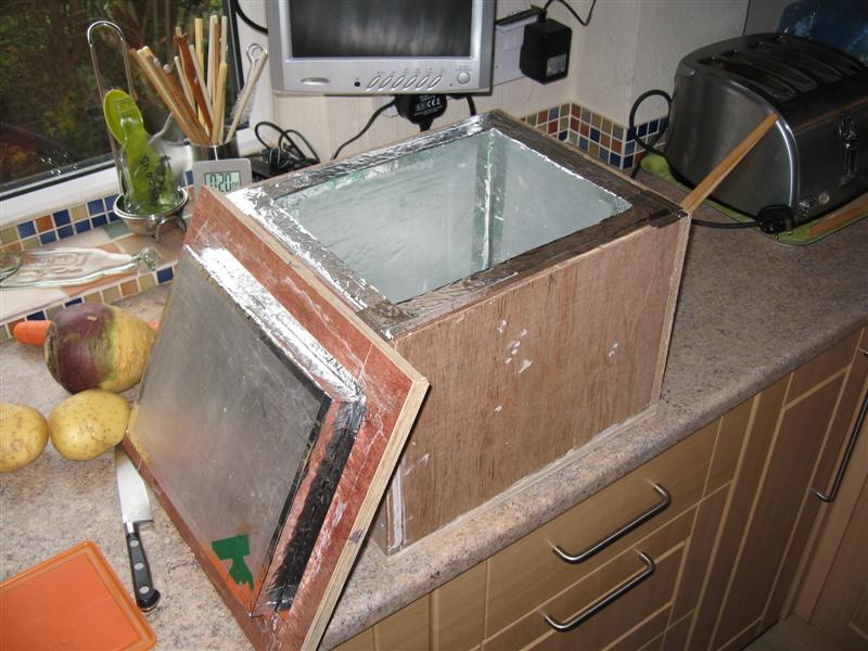

Having got interested in the Magic Cooker and then ordered one from ebay which turned out not to be in stock :rolleyes2: we decided to have a go at making our own.
I already had a Le Creuset cast iron casserole that my mother gave me.
Phill made a box from 18mm marine ply (just happened to be what we had) & lined it with Kingspan insulation board. I taped all the edges of the board with foil insulation tape.
View attachment 19033 View attachment 19034

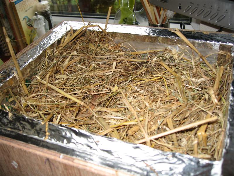

Plenty of hay & straw available from the barn next door.
View attachment 19037 View attachment 19036
I started off a bacon & butterbean stew at midday. It went into the box at 12:30.
