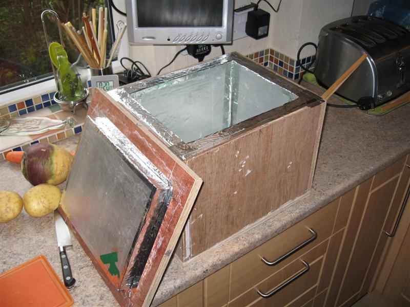

Having got interested in the Magic Cooker and then ordered one from ebay which turned out not to be in stock :rolleyes2: we decided to have a go at making our own.

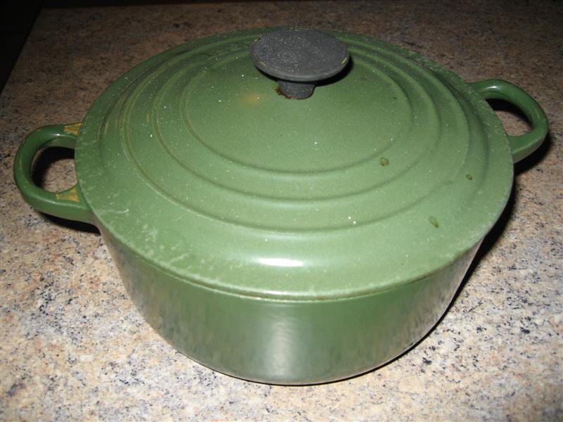

I already had a Le Creuset cast iron casserole that my mother gave me.

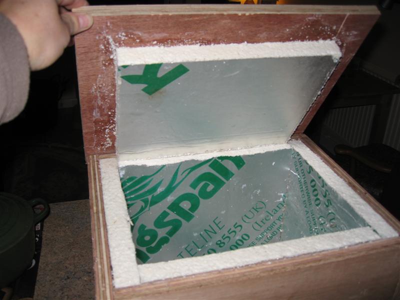

Phill made a box from 18mm marine ply (just happened to be what we had) & lined it with Kingspan insulation board. I taped all the edges of the board with foil insulation tape.

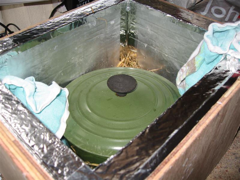

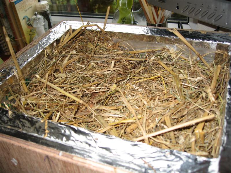

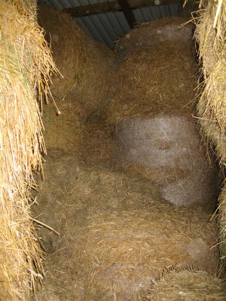

Plenty of hay & straw available from the barn next door.
I started off a bacon & butterbean stew at midday. It went into the box at 12:30.
We like most things motorhome to have a dual purpose so this is also a step-up for the fixed bed & a coolbox. Phill has worked out it will hold 16 beer cans.:cheers:
We'll be having dinner at about 7-8pm & I will report the results.
