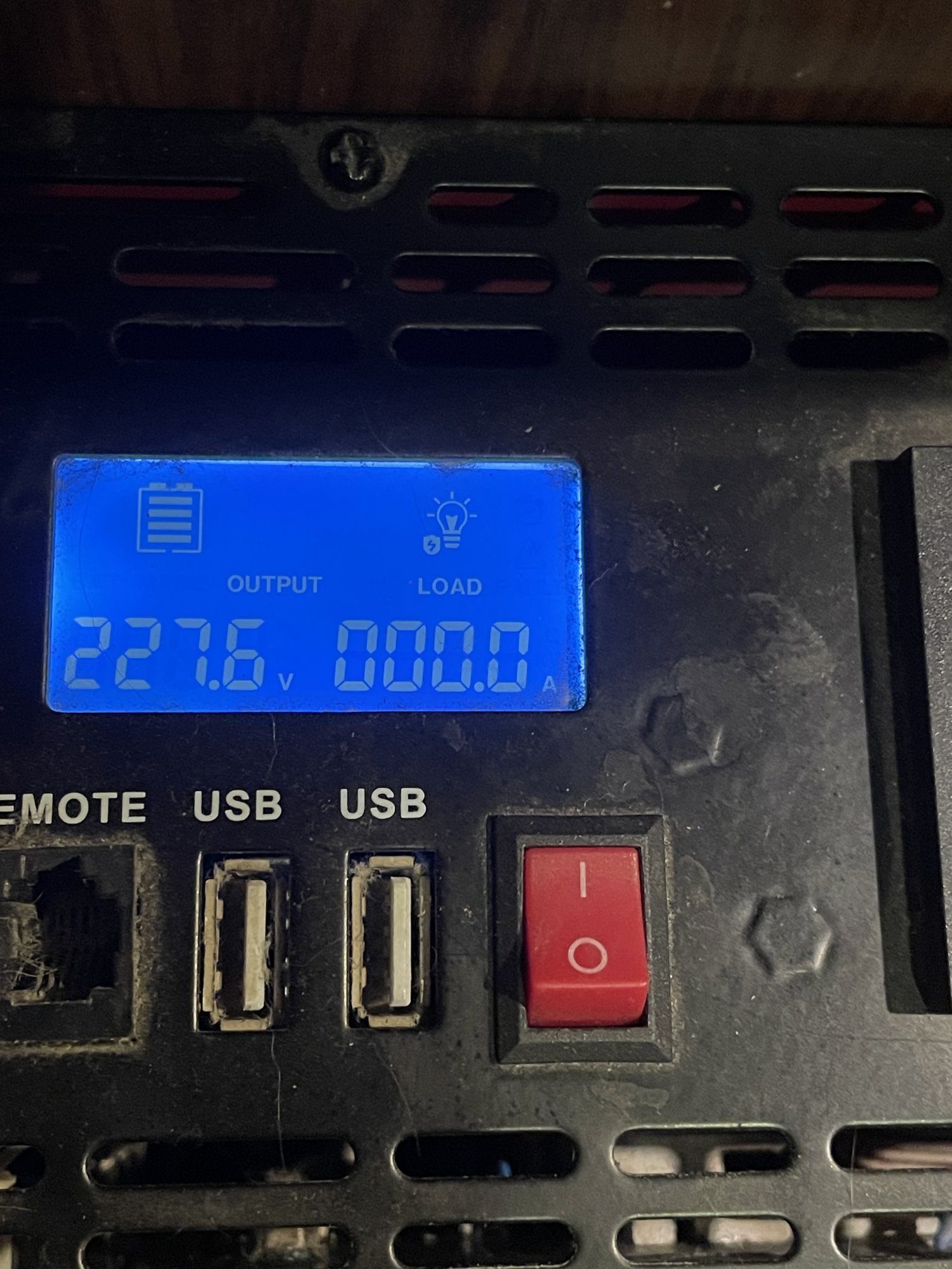

The inverter has been working just fine. All of a sudden no power to the sockets. The system is set up so that it thinks it is on EHU whenever the inverter is switched on.
The inverter switches on so it can’t be a fuse. The readings on the top are:
Output 50.0 Hz. 228.6v
Battery 13.2v
Load 0
The battery icon shows full
Not sure what the lightbulb denotes as tbh haven’t taken any notice of it before.
When it stopped working, I was just charging 2 and a speaker so hardly a big draw.
I can’t tell you what brand without breaking into the cabinetry. It’s a 3000w and about 3-4 years old.
Any ideas of what we can do to check the fault or do you think it’s fried?
View attachment 146095View attachment 146095View attachment 146095View attachment 146095
Could be the priority switch, or it vould have been overloaded, we had same problem with ours NDS inverter, ours also still switched on but would not switch to sockets when turned on, happened in Italy on our way to Turkey couple year back,

Ah but Georgia FIXED IT.
Lovely chap disassembled the inverter box. And reassembled around the socket. Now it works.
Strange as I’d used that inverter socket to run the EHU cable to the external connection point to rule the 220 system out. However, it now works!!!
So happy days!

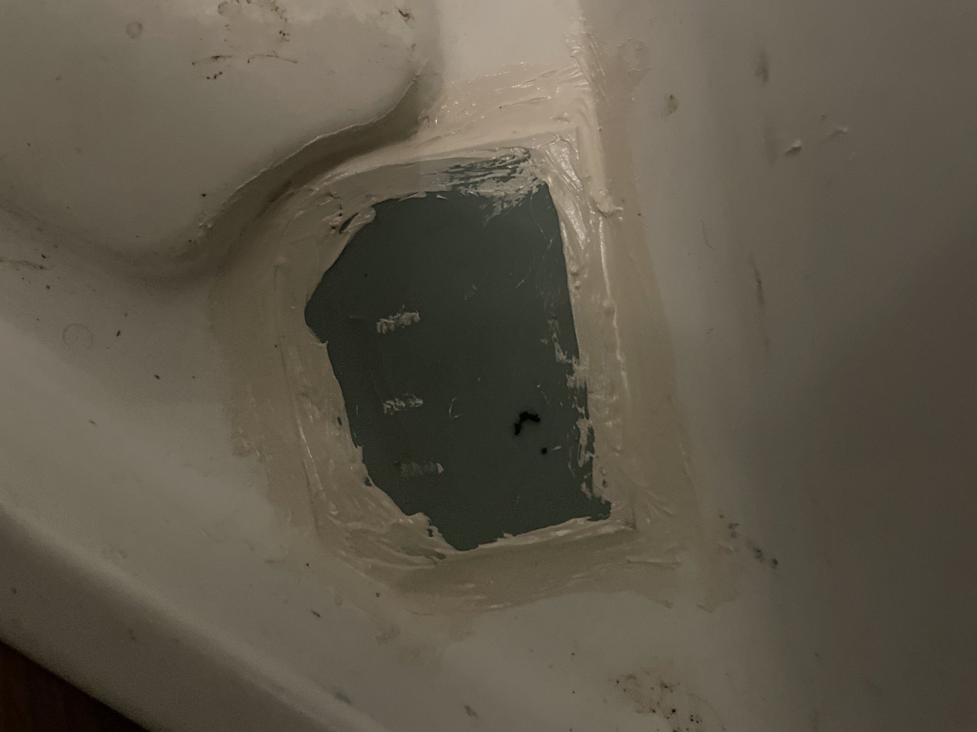

Well, sort of happy. But not delirious. Still no heating (Alde wet) and broken shower drain had just been blocked off as a temporary fix. Just worried water will go down the remaining shower drain and back up the disconnecting drain pipe work. image.jpg
