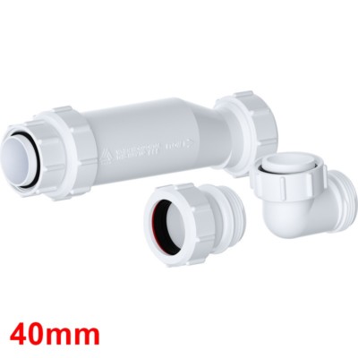

These Waterless traps can be useful in some situations as they work horizontal and don't need to be kept filled with, water....I fitted traps to all the pipes that feed into the waste tank to prevent odours coming back and all were push fit with no sealant. No leaks or odours now.
