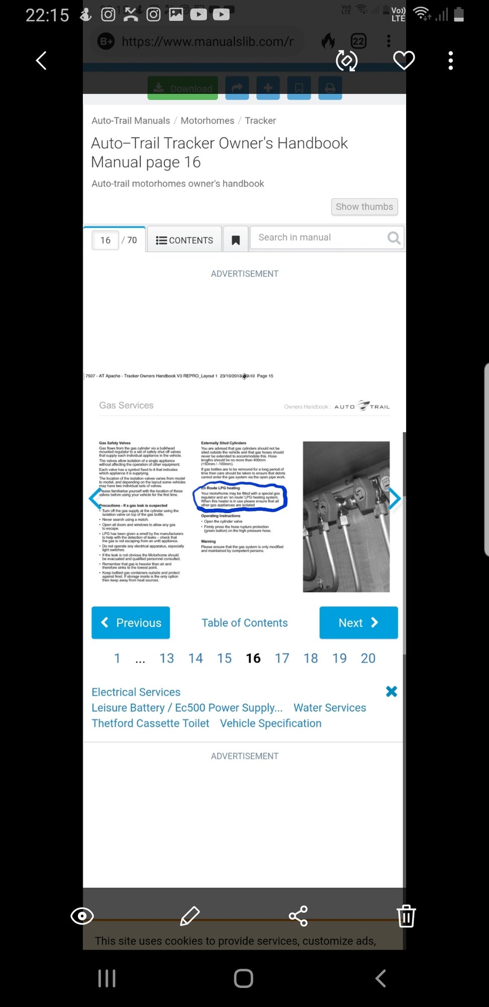

But here's a page from Autotrail Tracker Owners Handbook with photos showing post 2006 Ducato base.
The ringed section states that a gas heater may be used on route if the correct regulator is fitted.
I did have a look at my handbook and it did provide this contradictory info (see this post - https://wildcamping.co.uk/threads/gas-switch-off-or-leave-on-when-driving.84340/page-2#post-1144826), but as I have a -DS regulator AND a Gaslow bottle, if I decide to drive with the gas still on, I will not feel more unsafe than if I had it turned off.

I too found a Cheyenne handbook with no mention of en-route gas operation.
Maybe the factory never installed the same heater as in Tracker?
Either way as you say the fact remains that with the right kit you don't need to turn off.
