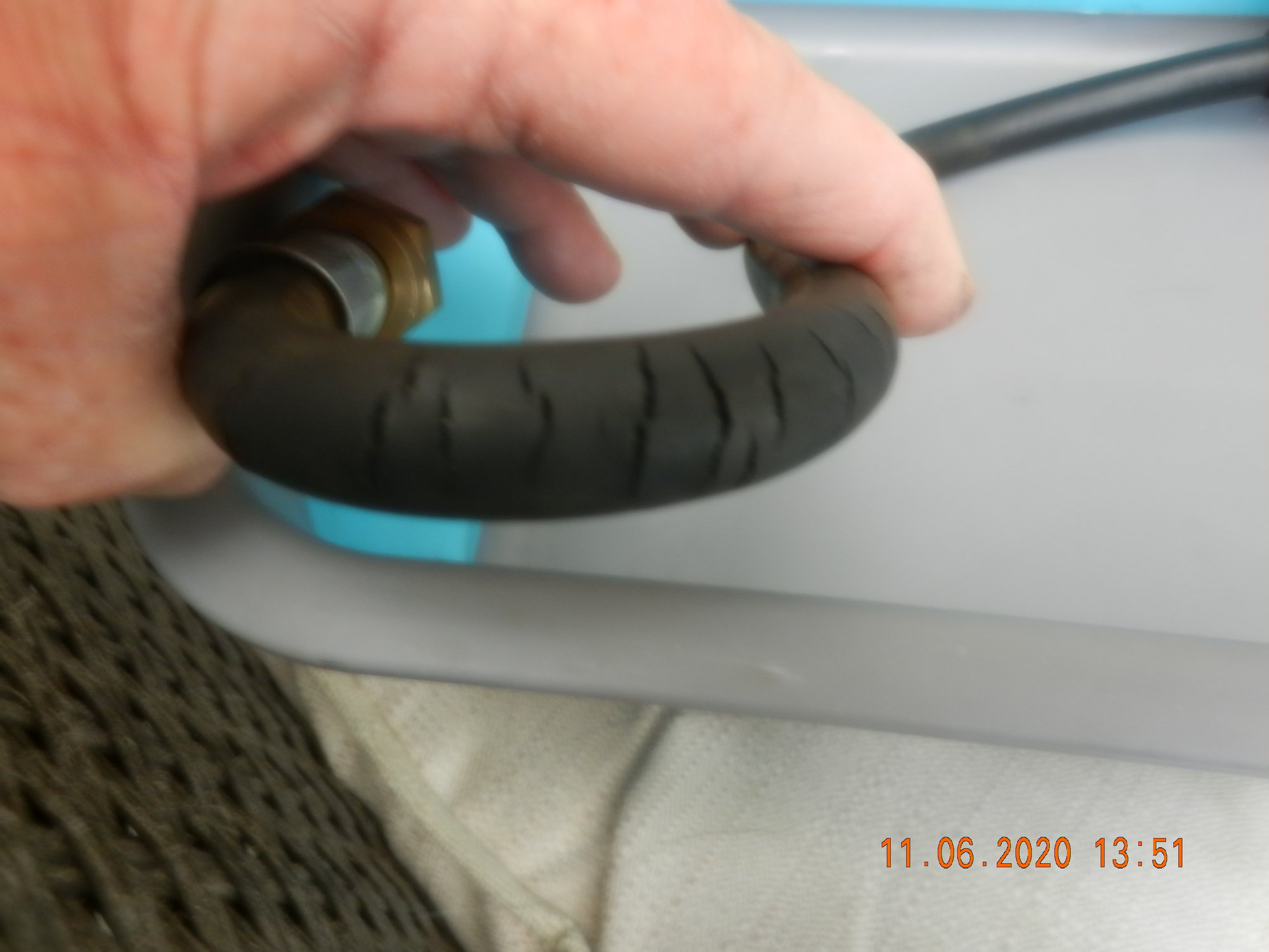

I checked gas supply hose on one of my old vans and if you accept that you cant really see this fault until you remove the hose the pic may be of benefit to others to check the expiry date on the hose
I always go refillable with stainless hoses which is probably why it was spotted
And i do leave gas on generally really dont like putting this on show but it might help others with rubber hoses
A little while ago I turned on my compressor and noticed it didn't cut out when up to pressure - so checking along the long rubber air hose on one of the outlets I found a section just like that in your photo. Looked fine visually while straight but could just hear the air leaking out. And on bending it the cracks became obvious. That hose was maybe in place just 6 years and inside at the point.
The steel braided hoses are definitely a better idea than plain rubber ones (it is interesting I think that they also have two sets of dates on them usually depending on their intended use)
I know that ss braiding will do wonders for abrasion but does it do anything (other than hide them!) for age cracking?
Cuts down UV degradation but in a locker or under a van that's not much of an issue.
I rather suspect that a lot of us have age expired houses unless we've changed our layout - so a timely reminder to do an annual crack check.

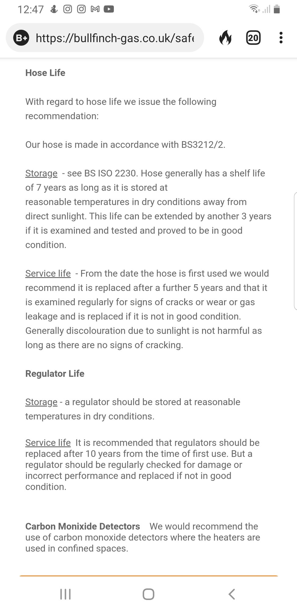

Hoses are recommended to be replaced periodically, I've seen all sorts of recommended dates, but 5 years seems most common.
As usual string length comes to mind!
Here's Bullfinch's take which would indicate that a hose could still be serviceable 15 years after manufacture.
In a stable location not subject to large temperature ranges or direct sunlight (like a gas locker) it wouldn't be unexpected for hoses to remain serviceable for more than 5 years.
