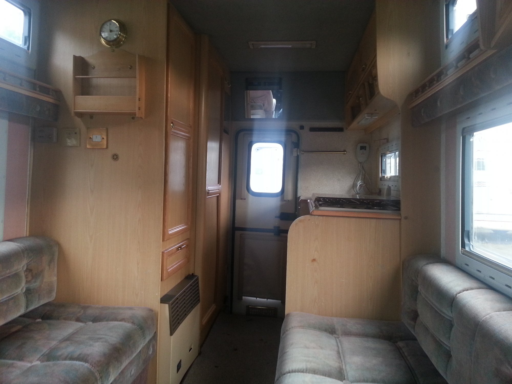

We have just replaced our old Eberspacher "wet" boiler (combitronic) with an Autoterm D5 using the rest of the combitronic system except the controller. Temperature control, 3 timers a day and I can add a modem to start it when we are on the way back to the van. In our old Talbot (1994) Compass Calypso, there was a small gas heater, it didn't seem to make any difference unless it was left on all the time. I certainly don't want to have that thing back! There it is, no fan on the back, but not sure it would have made a difference...

if noone's mentioned it , carver type heaters can be tricky to fit in a self-build van ,because they need a large hole in the floor if floor-vented ,or a small flue venting through the roof . all you need is a large and comprehensive tool kit and a good knowledge of electrics , plumbing ,carpentry ,metalwork etc , and the confidence to use them
