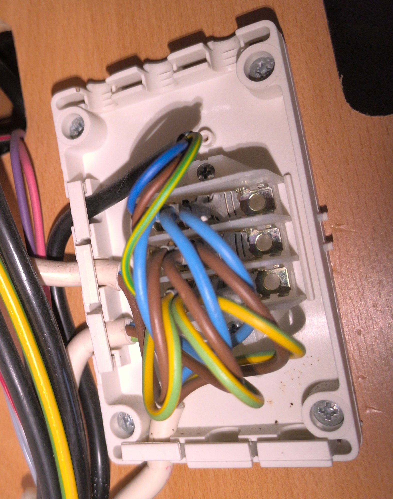

I have just had a look at what I thought was a fuse box in the cupboard, difficult to tell but it looks more like a connector block, definitely 240v to the fridge though IMG_20250613_125627.jpg

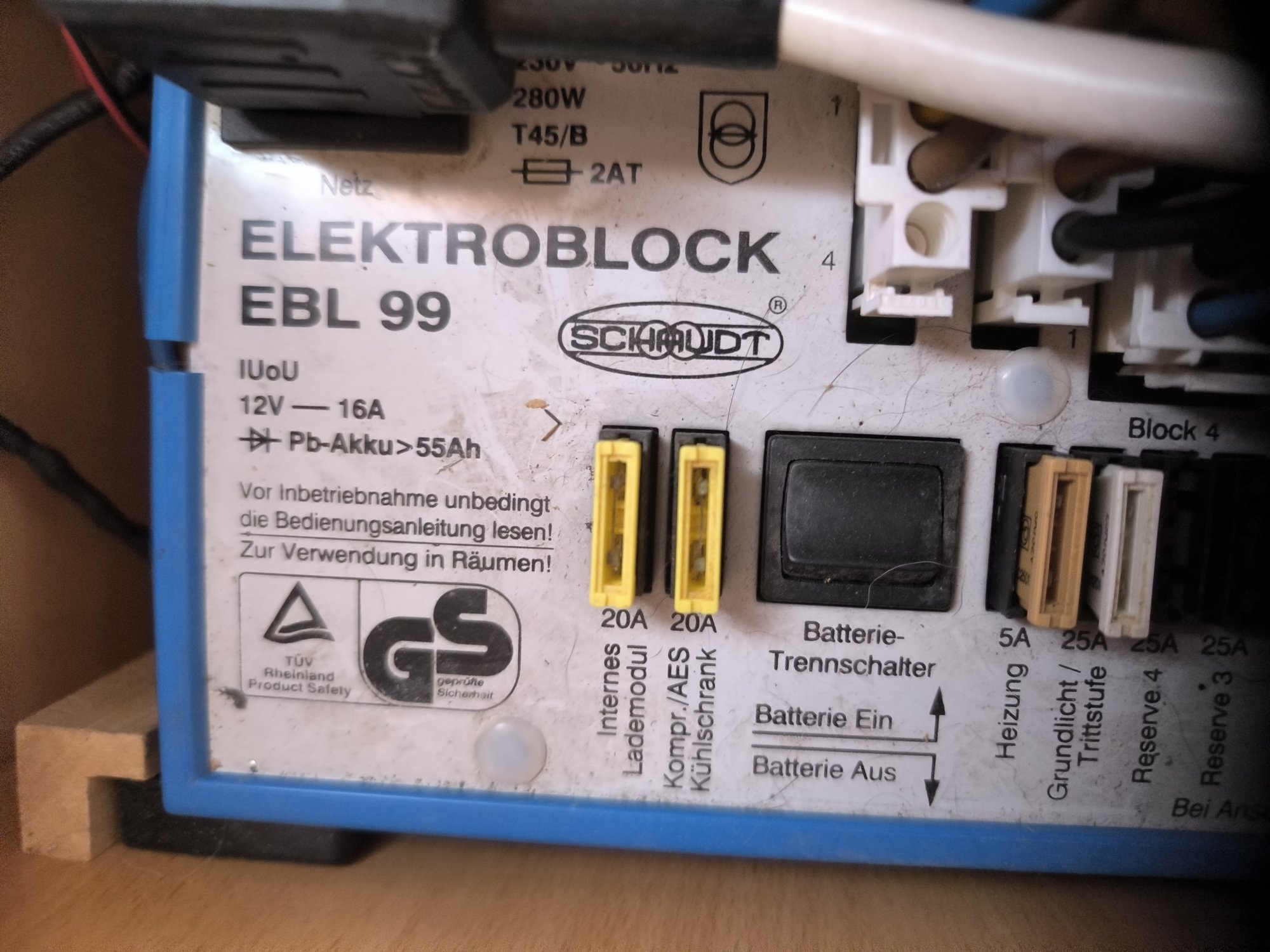

If it is an EBL 99, the fuse is on the EBL. There are 2 x 20 amp fuses at the left hand side. The right hand one is for the Fridge Freezer. If it is not an EBL 99 (which it should be on a 2002 van) let us know what model it is.

Yeh, I assumed they'd be fuses in the appliance plug tops or switched fused spurs rather than a row of 'mains fuses' like we see on the 12v side.
So the OP probably should trace the fridge mains lead back to either a socket, or spur and check for power and the fuse at that point.👍

Good post Jim, but it looks like a 12V fuse
The OP has still not given any detail on the type of fridge, or whether it is not working on 12 volts or 240 volts. If it is a 240 volts problem then the fault may be in the EBL 99 itself, or one of the multi plug contacts is faulty. When I was adding my Schaudt Solar Controller (with the conversion kit) I noticed a couple of pins on the multi plugs showed signs of heat, so I bought some new fittings and replaced the affected male and female fittings.
