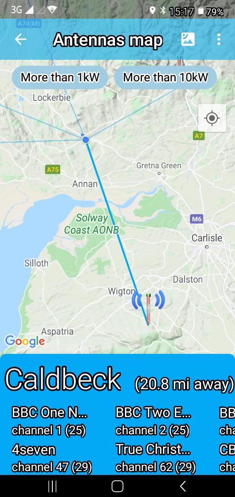

Why not use the App DTV Antenna, shows where all transmitters are to your location.
