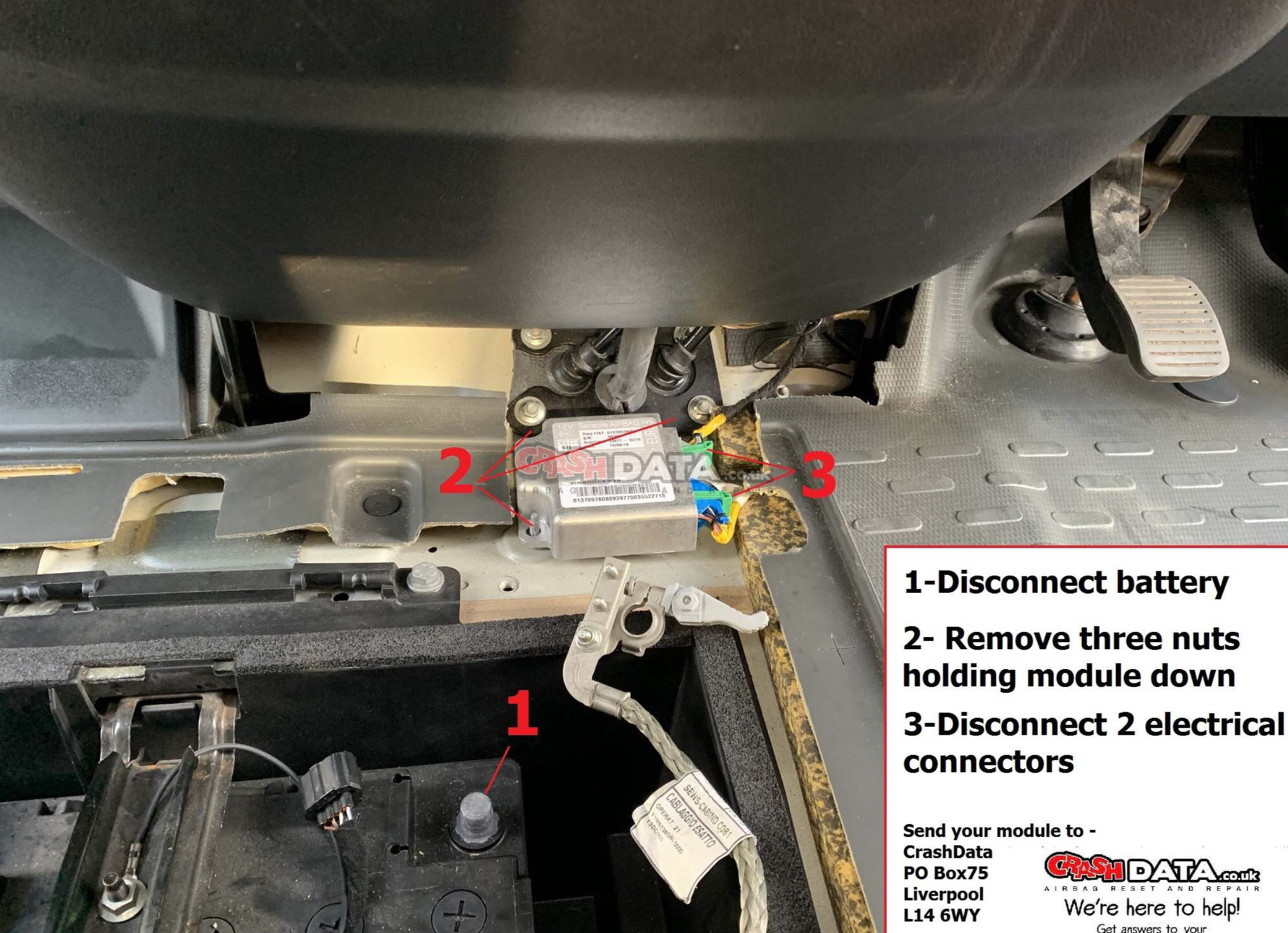

I had the same problem. Seems there’s a fault with this ecu. I took it out about 4 screws and two wee bolts unplugged it sent to crash test data Liverpool on a Monday morning and had it back on the Thursday Morning. Takes about 20 mins to take out and 10 mins to re fit. Once returned they guarantee it for life . Can’t rember exactly but think it was in the region of 60 70 quid plus postage. And you don’t need a computer or diagnostic to re fit it just plugs in light goes out on dash and it works.

Nope.- Crashdata can reprogram the module. I belong to a Bailey MoHo site and this is a common fault. Once crash data have reprogrammed the unit and the owner refits the module, the light behaves as it should.

Here’s a photo of where the ecu is located and what to do.
