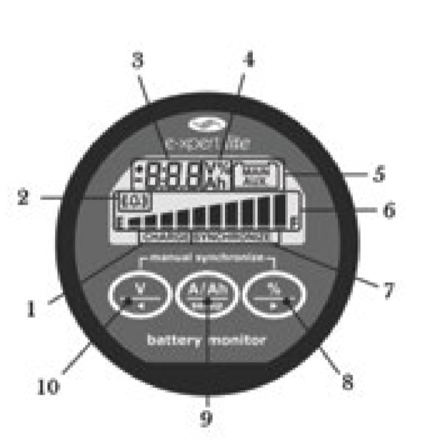

iv recently purchased a camper van with one inside but not connected to anything there was also 2 victrons 12/1500va all disconnected and just in the back of the van
iv tested them all and everything works
however I'm unable to access any data from the EZA battery iv downloaded the apps both on android and for the iPhone but with no joy at getting any data from the unit
I have charged the EZA to 100% iv even tried to connect to my laptop using the usb port
any info would be greatly appreciated
The early versions of this battery did not have Bluetooth but used a small display similar in appearance to the Victron BMV702 to monitor and manage parameters.
Maybe yours is one of those early versions?
The monitor looks like this;
And here's the original guide (in French)
