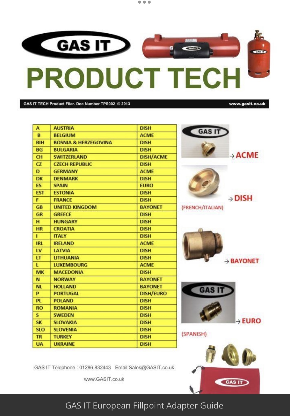

This is a comprehensive set, but a bit expensive. I thinks a minimum the dish type adapter is the most common in Europe.

You may want to get the Spanish one as well as the French one.

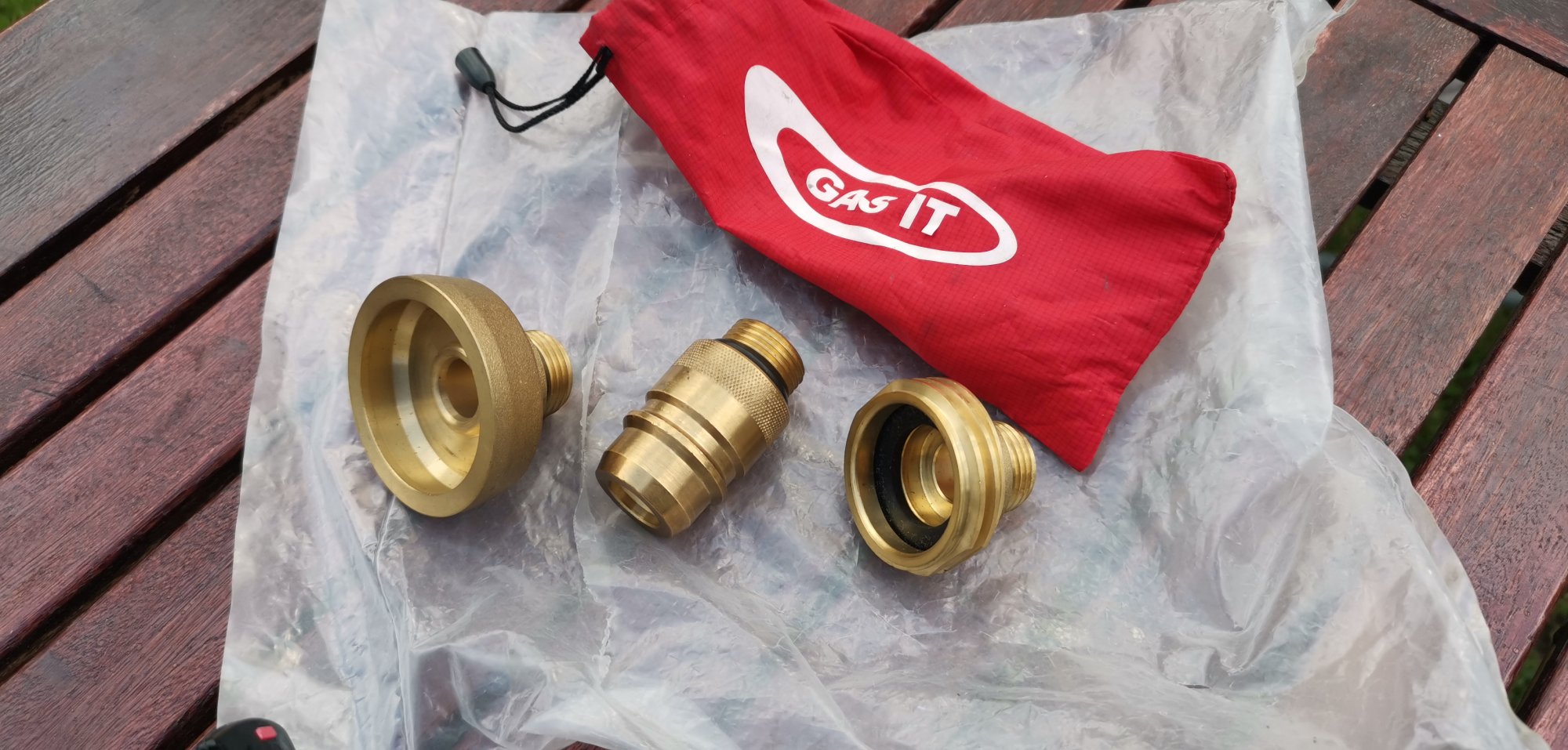

I'd advise you buy the pack of three .
Definitely covered for France and Spain . I'm sure I've used the third one but can't remember where .

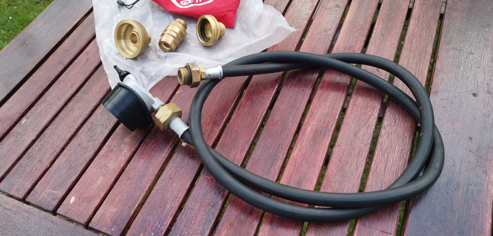

Left one is what I've used in Norway, Middle one for Spain. The other not used nor the bottle adapter, from gas-it, for, I believe Spain. Used with the hose.

the triple set covers most of europe but i had to get the bayonet extension piece for a lot of uk garages particularly morrisons the nozzle is so chunky it wouldn’t fit inside the bayonet housing
Forgot which one I need for the UK
If you have the standard bayonet connector, you don't need an adapter for the UK. The dish one in the left (the only adapter I have: all I've needed) screws into the middle hole of the bayonet fitting.

I found that the dish adapter was the only one needed, i have the set of 3 but only ever used 1 of them.
