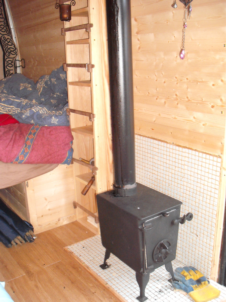

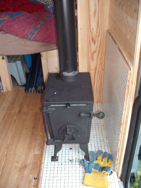

Hi there thought I would reply to this and say that we considered a lot of different stoves for our van including the fronter stove but in the end went for a bantam 3kw stove from the champion stove company Champion Stove Company Products Page Martin supplied the stove within one week with the flues, capping and the silicon sleeve at a very good price. We bought two one for our van and the other for a log cabin and they have both proved to be very efficient plus they can be shut right down at any time to extinguish the fire.
I will post some pictures of both of ours later
Kev
Here is the stove we use in the van, at the weekend we used one of those compressed wood logs and with the fire turned right down the log burned for nine hours giving out enough heat to keep us very comfortable. :)
