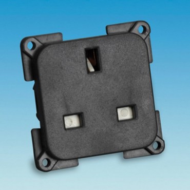

Why not just use the proper thing and be done with it ..
Available on ebay CBE Electrical Sockets
Surface mount and certainly easy to fit with four screws and a round hole. They do all sorts so you can have a complete set that all match. Different trims to hide the screws.
the CBE Electrical Setup is IMO by far the best and most flexible system - sold hundreds and hundreds of the USB Style Twin socket :banana:
The 240V Socket also has a back cover available for it to cover the terminals which is highly recommended to use :D

CBE stuff is certainly good quality but can be fiddly to fit especially with multiple units. Plastic plasterboard type boxes are good when the fitting is in dead space but where the back will be in a storage space I prefer the more robust plastic version of the metal surface box. No holes where tings can get inside the box and robust enough to fit a cable gland to act as a strain relief.
IMO, it's really expensive and actually not that good!
My complaints about the CBE systen (which is both aesthetically good and covers almost all needs) are firstly the back boxes are very small to hold the wiring, and can have small objects poked though which makes them only suitable for mounting where there is dead space behind, and because of the system precision you need a jig to get multiple hole properly aligned. As I have seen none offered for sale I have 2 home made ones hanging up in my shed. Finally because of the very wide range of inserts one is often forced either to pay extortionate prices to buy all you need from a single supplier or make multiple purchases from a numbefr of retailers. As a result I tend not to use them these days if at all possible
I'm assuming (please correct if wrong) that by "inserts" you mean devices? If so, isn't it a great thing to have such a range of devices to be able to install just about anything you need but keep a common cohesive look?
I have a wide range of CBE kit in my shop, but not everything for sure! I use multiple suppliers based on both availability and price when stocking product, so no different to shopping around as an end customer. Has it ever not been the case that to get the best prices this is what you must do?
Interesting point about a jig requirement. I've always just used the frame for alignment and never had any issues but I can see the benefit of a jig to ensure holes are marked up dead centre and aligned together for those who maybe new to installing CBE kit.
I think this could be a job for my 3D Printer :rabbit:
