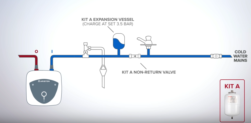

Neil, I guess different folk have different meanings? Ariston call what you are referring to as the Accumulator tank the expansion tank (vessel).
As I mentioned, on the heater I have, the expansion tank is fitted to the cold supply (i.e. BEFORE) the heater.
Here is a picture from the manufacturer that is in the install manual that I used, and is featured on their on-line video on installation I just searched for.
And that is basically the way I installed my setup .... (teeing off the cold supply for the water heater in my case rather than teeing off for the tap as shown above - same difference of course)
Heater Pipework

Sounds like whatever you buy, you need to read the instructions carefully!
I notice on the link that Neil kindly included that the picture of their Accumulator tank actually says “Expansion Tank” on it and it’s clearly identical. Confused or what.....
This link, which I need to read more carefully, says that you might or might not need one or both, depending on pressure, non-return valves, capacity and so on.
