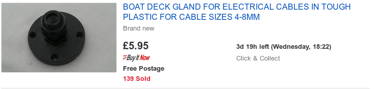

Taking a cable through the roof is best done using a boat deck gland which can be bought on ebay cheap
