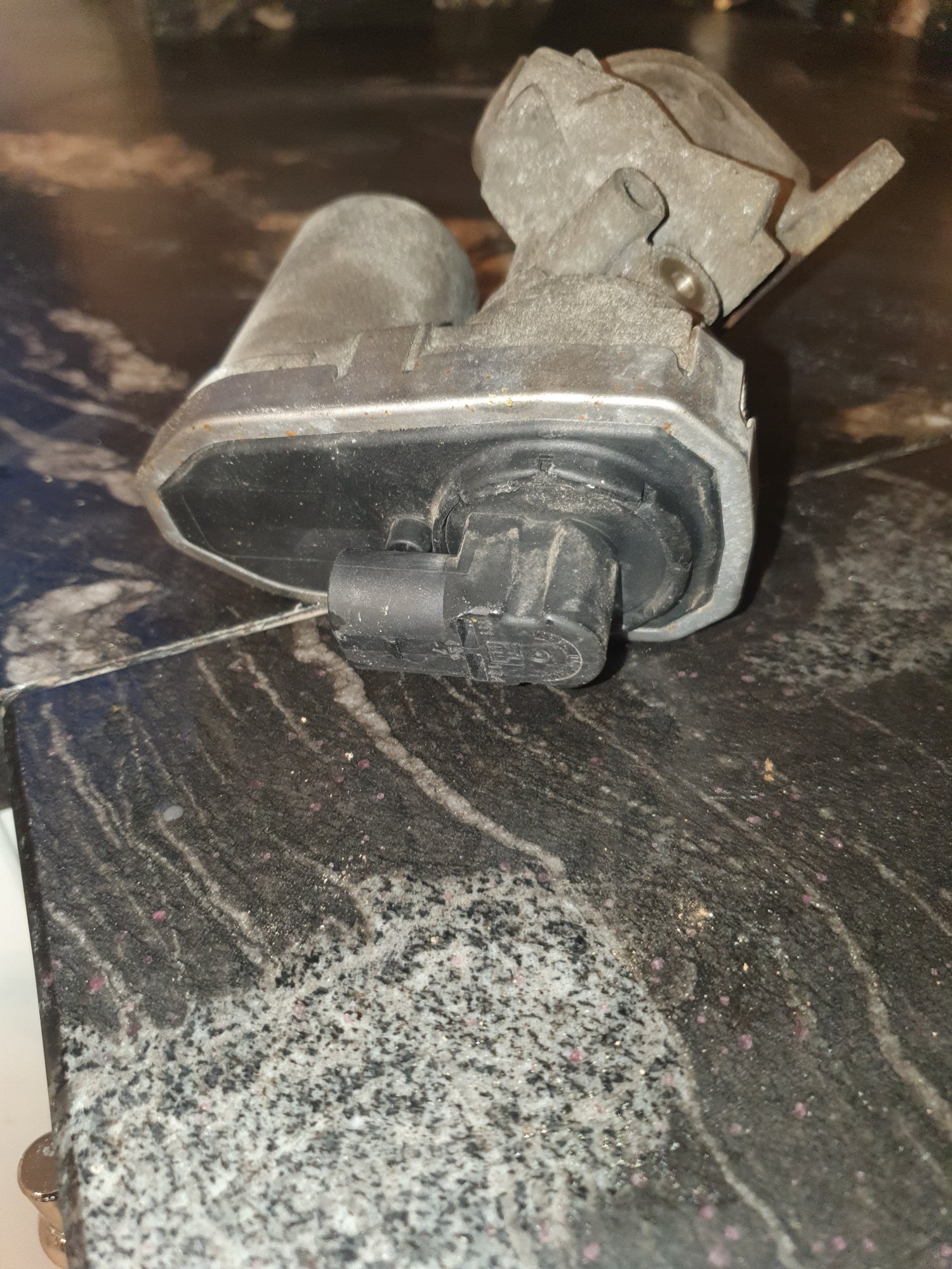

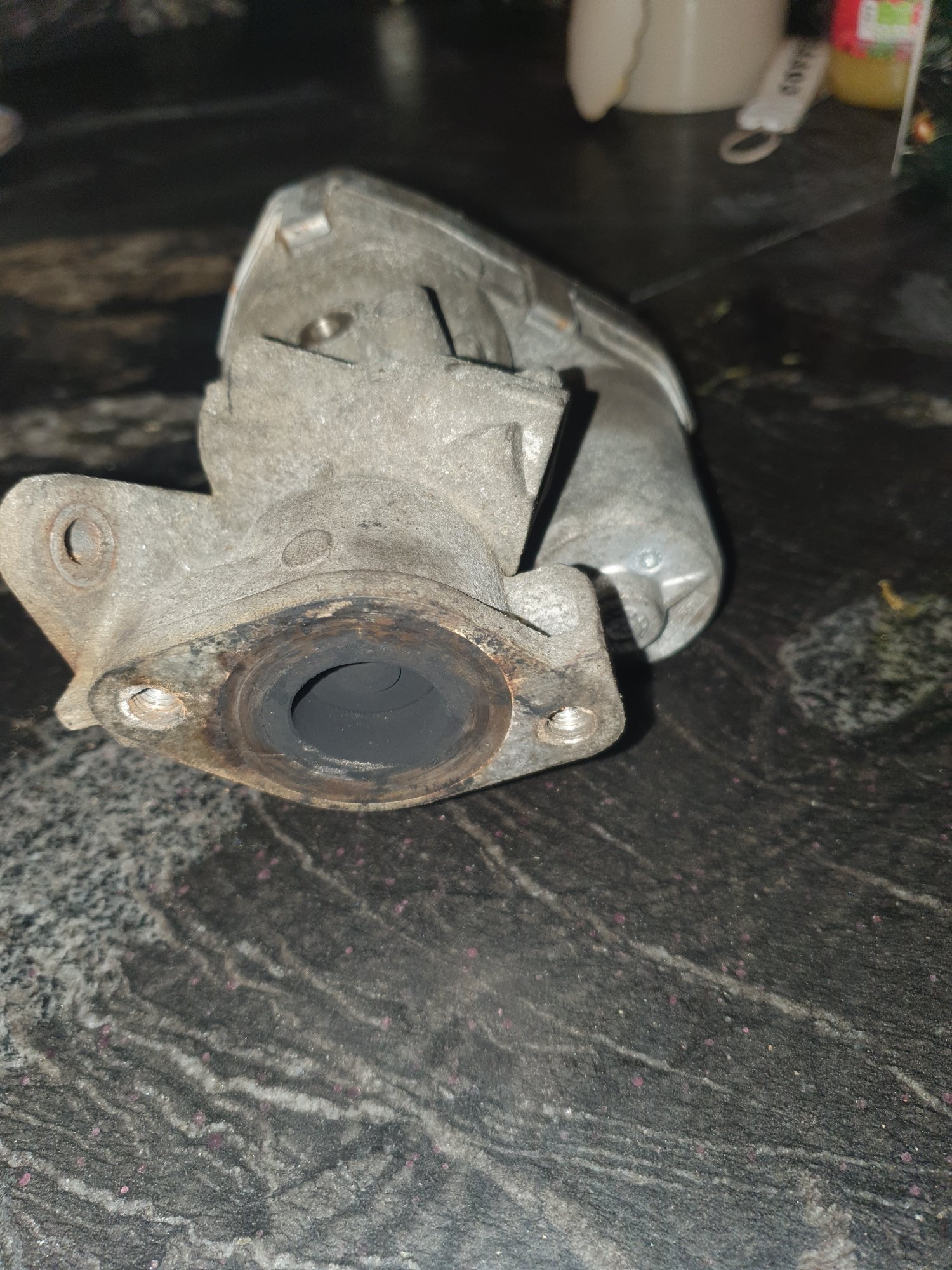

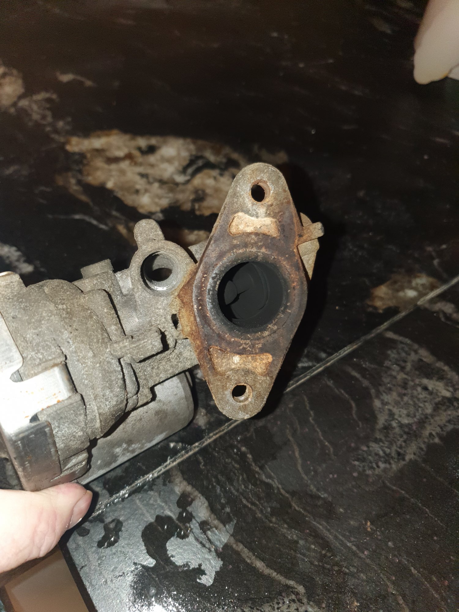

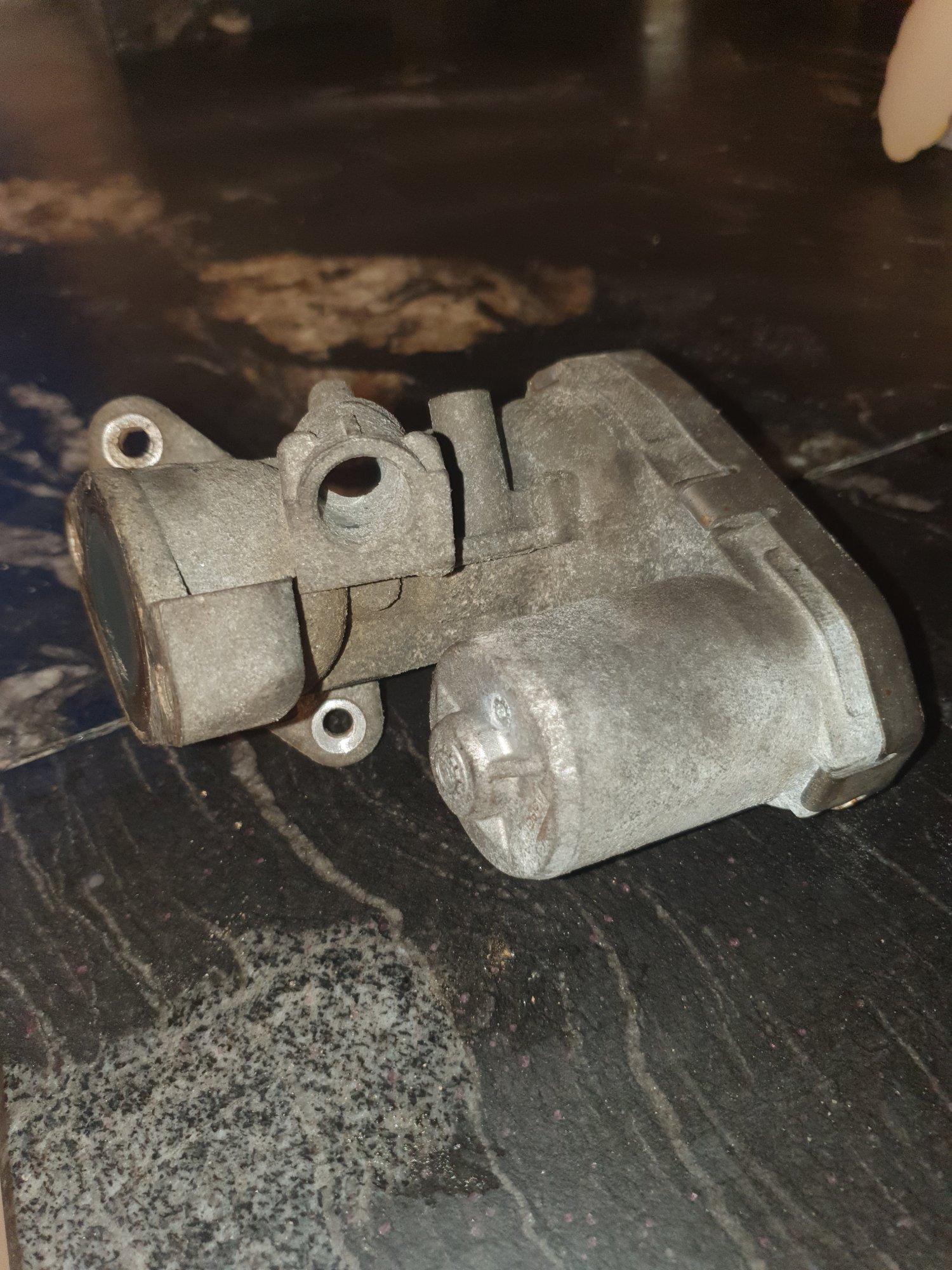

The Diesel garage rang me just now about MY EGR valve. He's got it off, and it is NOT caked up at all really, (I'll post a pic of it later on, not the problem it seems, I almost always every day drop to third and cane it for a few miles if on a decent road, so that seems to work fine, he thinks it is the solonoid that is at fault which is part of the unit older vans have a vacuum operated valve, so that hopefully with fix it's cold running problem, it works 100% once it reaches normal temperature.
I did consider that, but he advised against it, he did explain but it was a whoosh moment and Liz was waiting for me.
Got the van back home, it's like a new van, sets of well goes up hills better, and just feels better, £400 all in.
