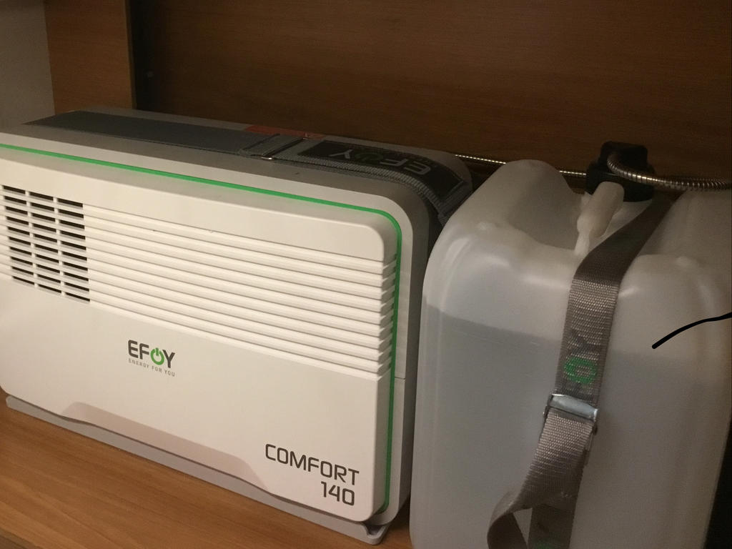

You forgot to add the corporate logo, Wully. :tongue:
Looks good terry you think like me. I’ve attached a wee bottle to the vent pipe with tape pure 100 distilled water got to be good for somthing although I’m not one for contaminating my whiskey with water they guys took 12 years to get it perfect slanj
In your install does the Efoy draw power for the leisure battery to run.
Sorry I’m not quite getting what you mean. It works and wires direct to battery you set the level that you want it to start up so when you’re battery say dips to 12.3v it’ll start up automatically and run and if you’re using a constant feed from battery then it senses this and stays on until battery is fully charged or the setting that you’ve asked it to turn off at I’m no expert but find its been pretty simple to manage the settings

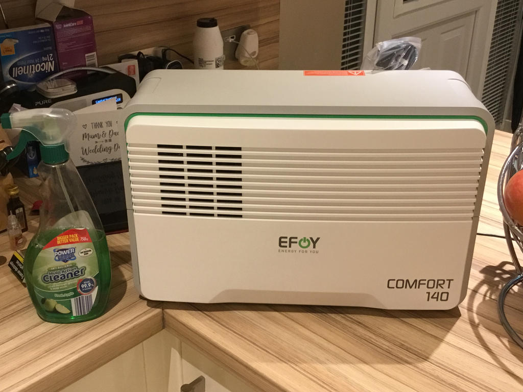

View attachment 60632Fitted my efoy 140 fuelcell today took about 1 hour to completely install. I’m even more impressed when I heard it running or dident hear it. For me it was a hard decision because of initial set up cost and listening to everyone saying how good solar was well it’s pitch black outside and this things still charging my batteries at a cost I know but the piece of mind it’s giving me is great a constant 24 hour energy without sun or a noisy and polluting generator I’ll keep youse posted on running costs over time. View attachment 60627View attachment 60628
