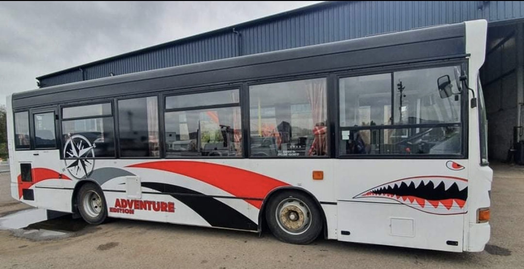

I've applied to dvla to change the log book to a motohome...had a letter back today say even thou inside ticks all there boxes for a motohome conversion...outside they reakon it still identifies as a bus ..so they want to change the class to a HGV😪..any ideas what I can do guys?

Pretty standard response on a refusal.
Personally, I would say actually it does still look like a bus :( Maybe blank off some of the windows and paint them the same colour as the lower part? I'd have a look at images of some factory A-class coaches and take some cues of them for external appearance.

Let them know it would be illegal to class it as a HGV as it's not been type approved. Ask for Class M1 with a weight exemption.

In fairness to the DVLA, But in general I don't think they are fair, it does to my mind still resemble a holiday coach, it must be very difficult to make a coach look like a motorhome as here in the UK "RV " is still an Americanism and not really recognised by the general British public. Phil

Body type will not have effect on taxation class, it will be PHGV tax £165 . as prev post , it does look like a bus/coach . They want to move it to HGV as a tax class as you cant have private coach/bus tax , and it would not be possible to class 4 mot it , as far as I can work it out ? They have confirmed it complies as a motorcaravan so you quite safe with class 4 mot .
You will be right cold and condensation with all them single glasse windows, first thing I would have disposed of and sheeted in, does in my eye look like a bus.

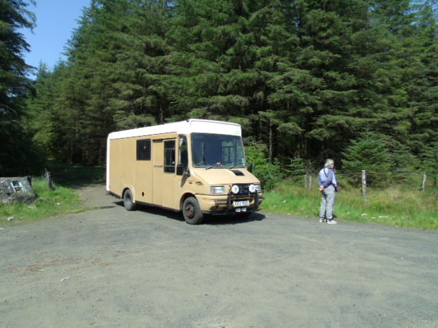

I currently have a 5.5tonne Iveco welfare bus conversion, which the DVLA are happy for me to use as a motor caravan, it has a class 4 mot, & its taxed as a bus. The post office couldn't tax it as anything else while that logbook taxation class says Minibus. The entire system is £$%^, everyone interprets the rules differently & nobody, including the DVLA seems to have a clue what the actual rules are. I get different advice every time I ask anyone, its just a minefield!
