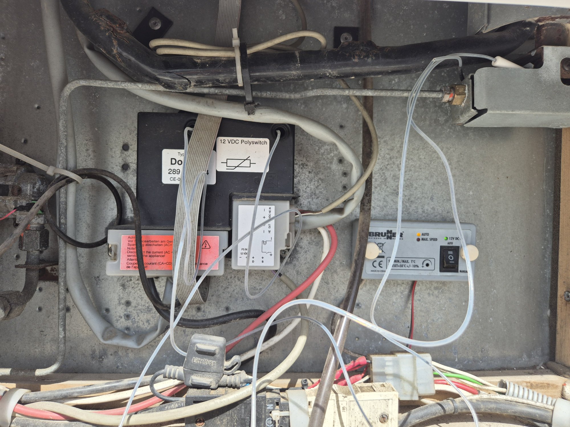

View attachment 141916View attachment 141917
We had a new controller unit 18 months ago, thinking that was causing the previous fridge problems. In the end, it was a blocked supply! But, fortunately, I have the old and probably OK controller, with us!
But could do with identifying the fault before we pay to replace it. Ho hum ... there's always something!
At Fiat in Heraklion atm ... fixing cab heating, so will see if I can identify the ignition switch and clean it. The clicking stops, so reading the above and link to previous Annie's issue, it sounds more like that.
BTW, no ignition battery. And I'll dig out the model no.
Thanks guys
Fixit man in Hetaklion then stopped answering our calls so he was obviously too busy!
We won't be using the mh between now and end July as house guests and will fly back to the uk when my first grandchild arrives.
So I'll book repairs on the Greek mainland. There's a newish place near Athens that has a free serviced aire. They can look at the heating that also only works on electric! The joys of a modern motorhome in its 8th year!
Thanks for the comments and thoughts ... reckon ignition switch.
