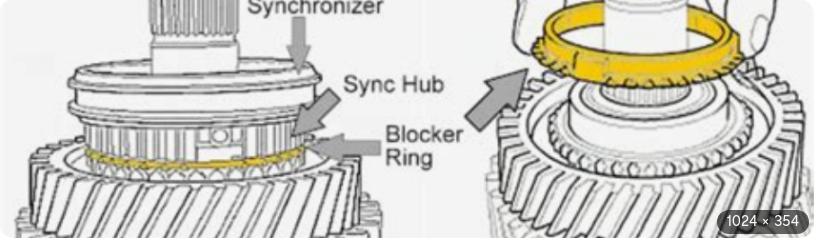

The problem was first and second gear badly worn, and yes they had to remove the gearbox to rebuild it. Like a new motor now.
Never had a g box wear the gears, mainly the syncro rings are first to go, esp first gear ones, this happens because folk dont put the cluth to the floor or change into first when moving to fast.
You may well be right Trev, although they gave me the faulty bits back, I actually had no idea what exactly I was looking at. 🧐🥺🧐😡
syncro rings are thin and a bronze colour, they fit at the end of a gear and move slightly left and right, the idea is they move to make sure the gear meshes with the other driving gear/hub.
Some times the hub or mating notches also wear, so both require new units.
Thanks for that Trev, I’ll get the gear out of the garage later, and have another look and see if there’s anything obvious.
Some times the hub or mating notches also wear, so both require new units.View attachment 148204
