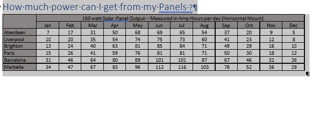

The output you get from a given panel depends on how far North you are, and the time of year.
I developed this guide a few years ago, may be of use.

Point us to the sun. Good graph above
