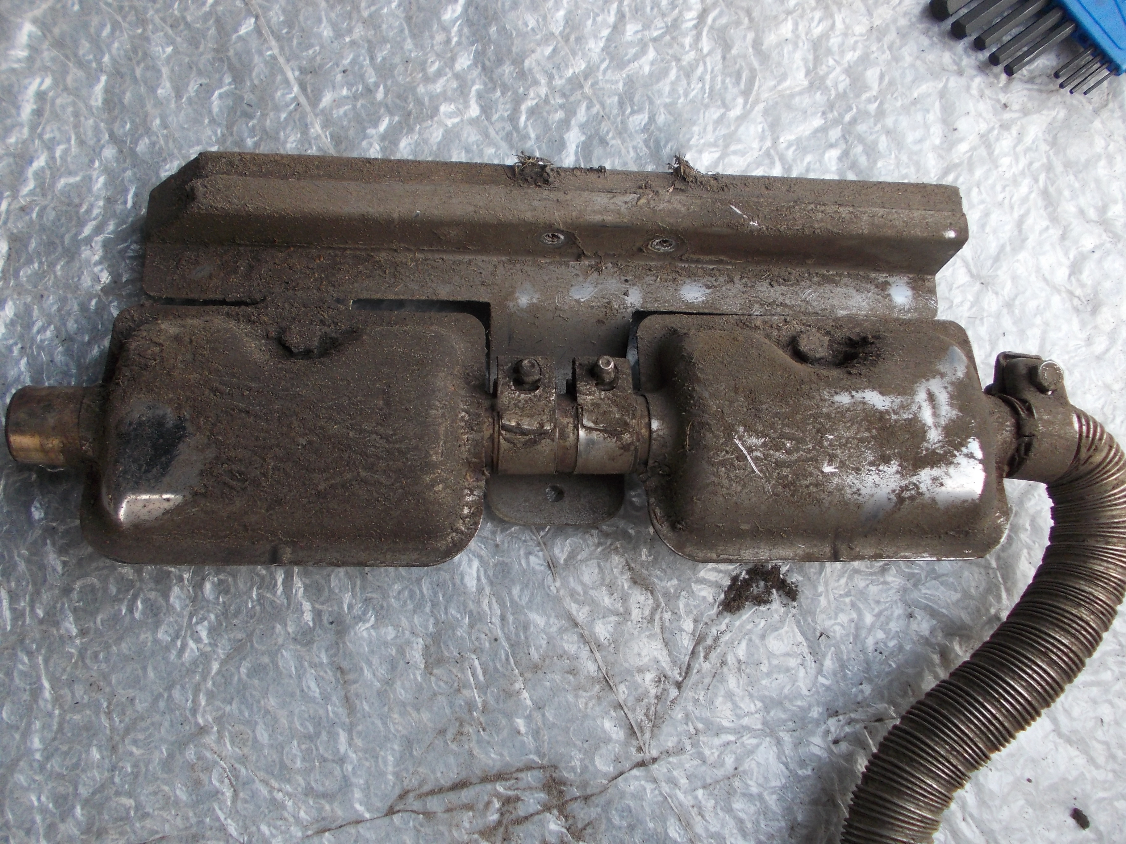

First thing, thank you for all your input. I have read all the replies and taken all your suggestions onboard. Today I put it all back together, ran it at a high temperature ...... ok, turned it down and the smell of unburnt diesel became strong. Tomorrow I will be removing the exhaust and putting a straight through pipe in it's place and see if that makes a difference.
Last hope.

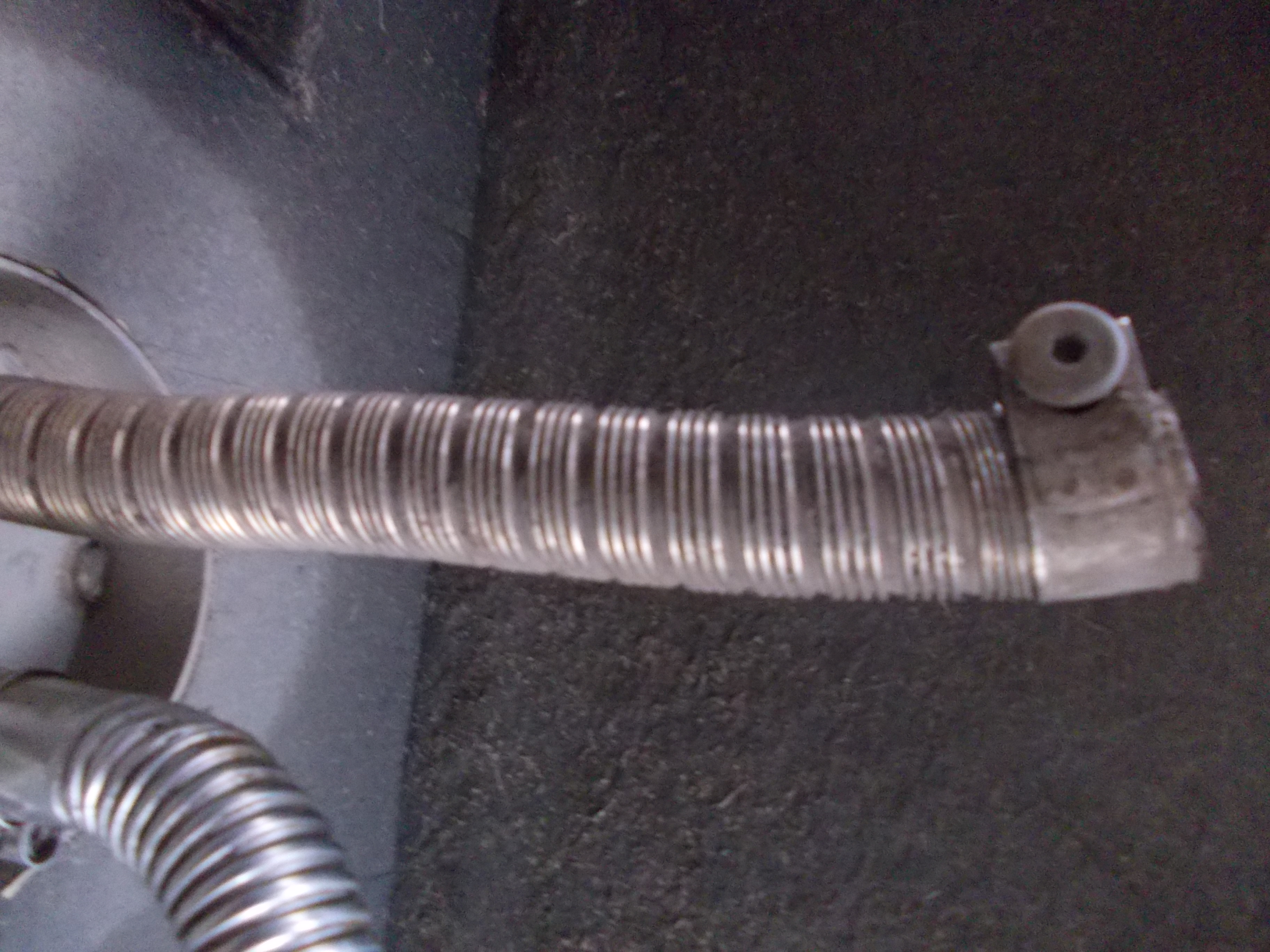

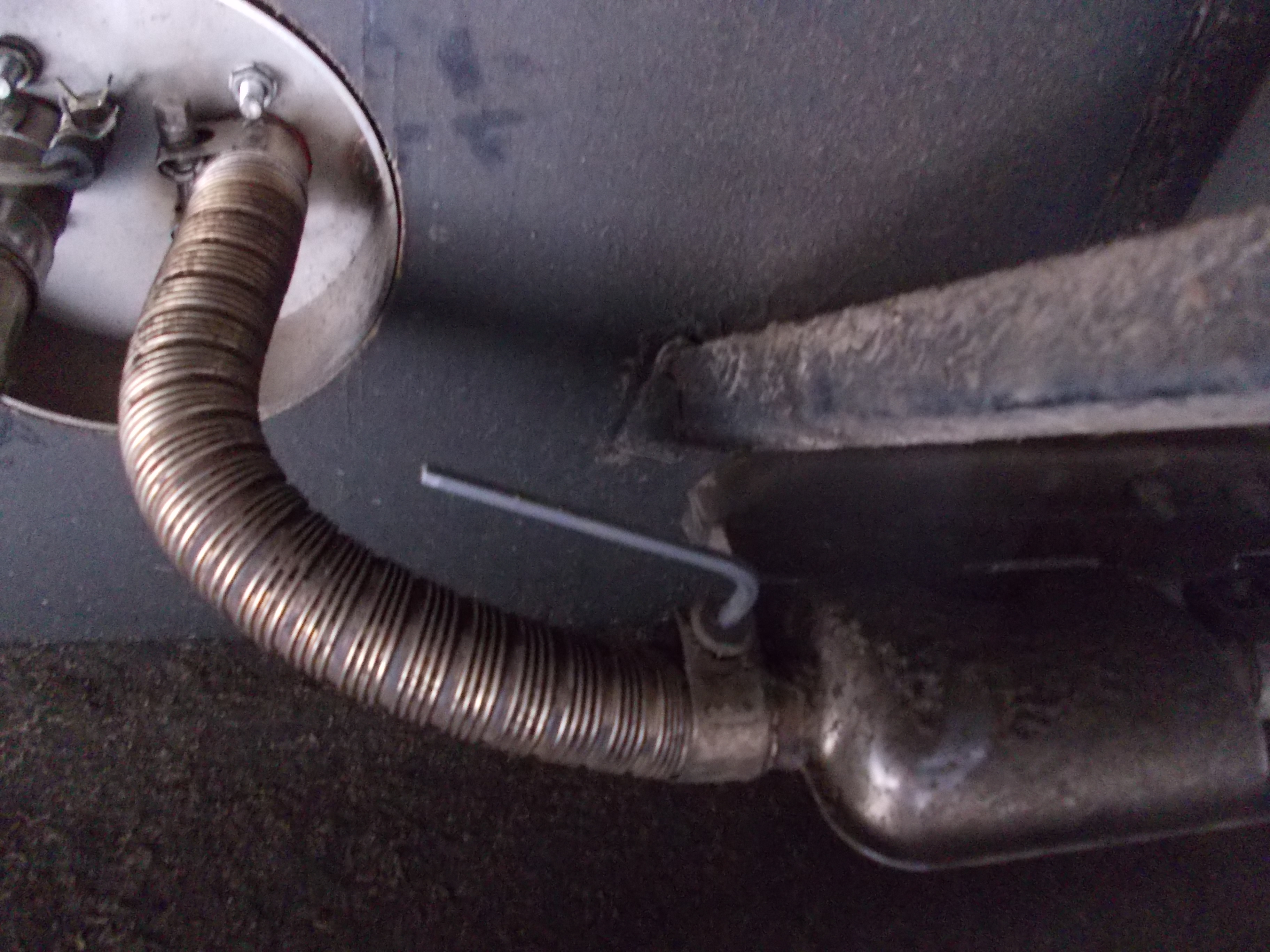

Before I start on the electrical side I thought it would be prudent to check the exhaust.
After disconnecting the silencer it was just a matter of starting up the heater and see what happens.
Could not believe how much soil had deposited itself on the silencers.

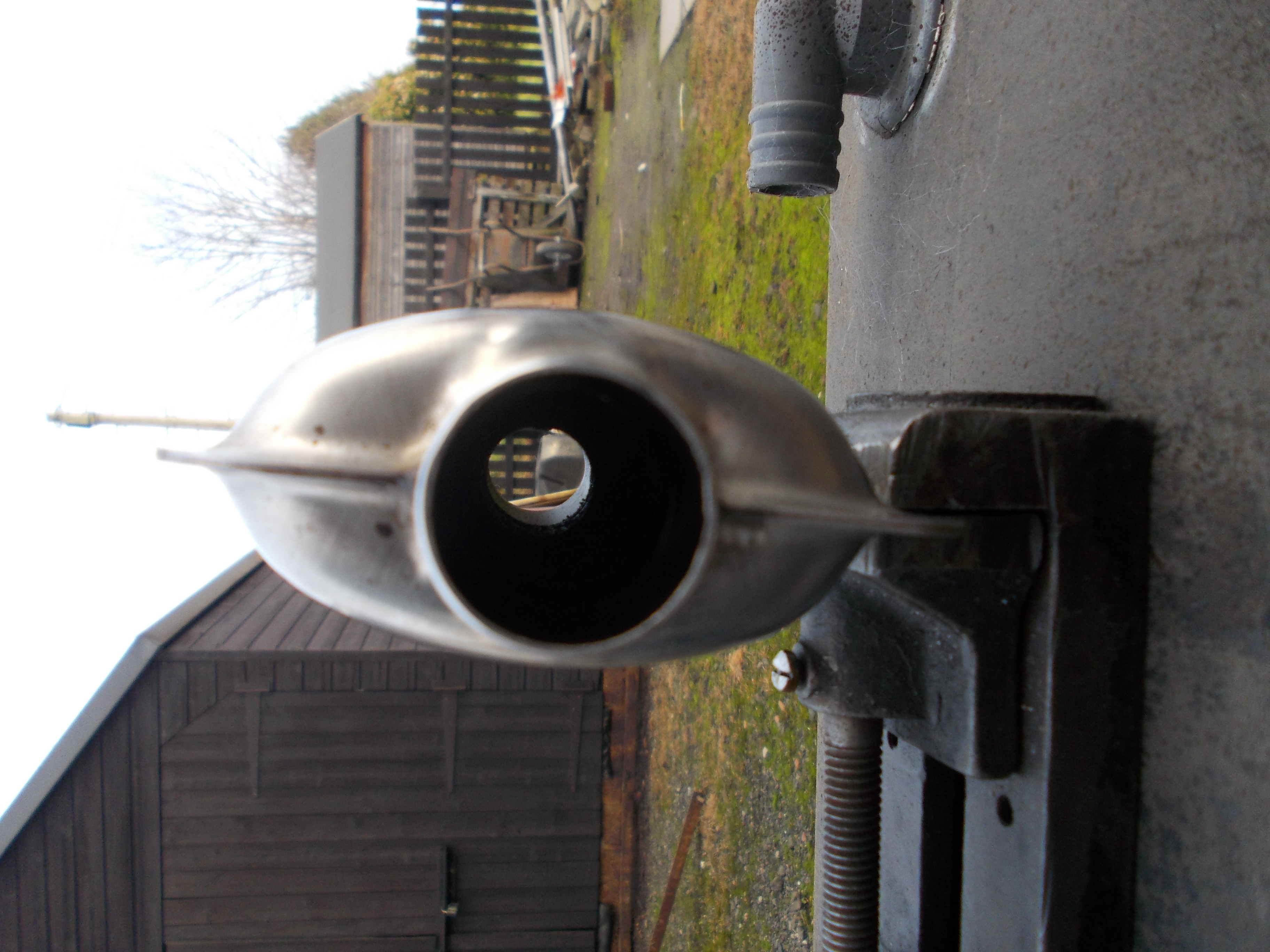

Next job, pull the silencers apart and have a look through. When I was making this system I opted for the Chinese silencer as it was straight through. Looking at the first one, no problem there.

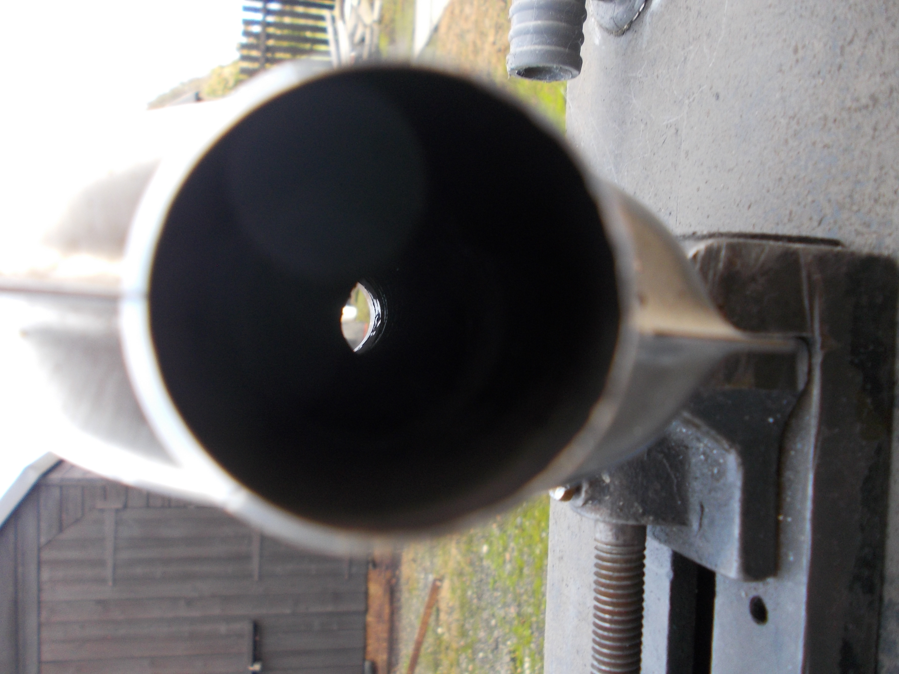

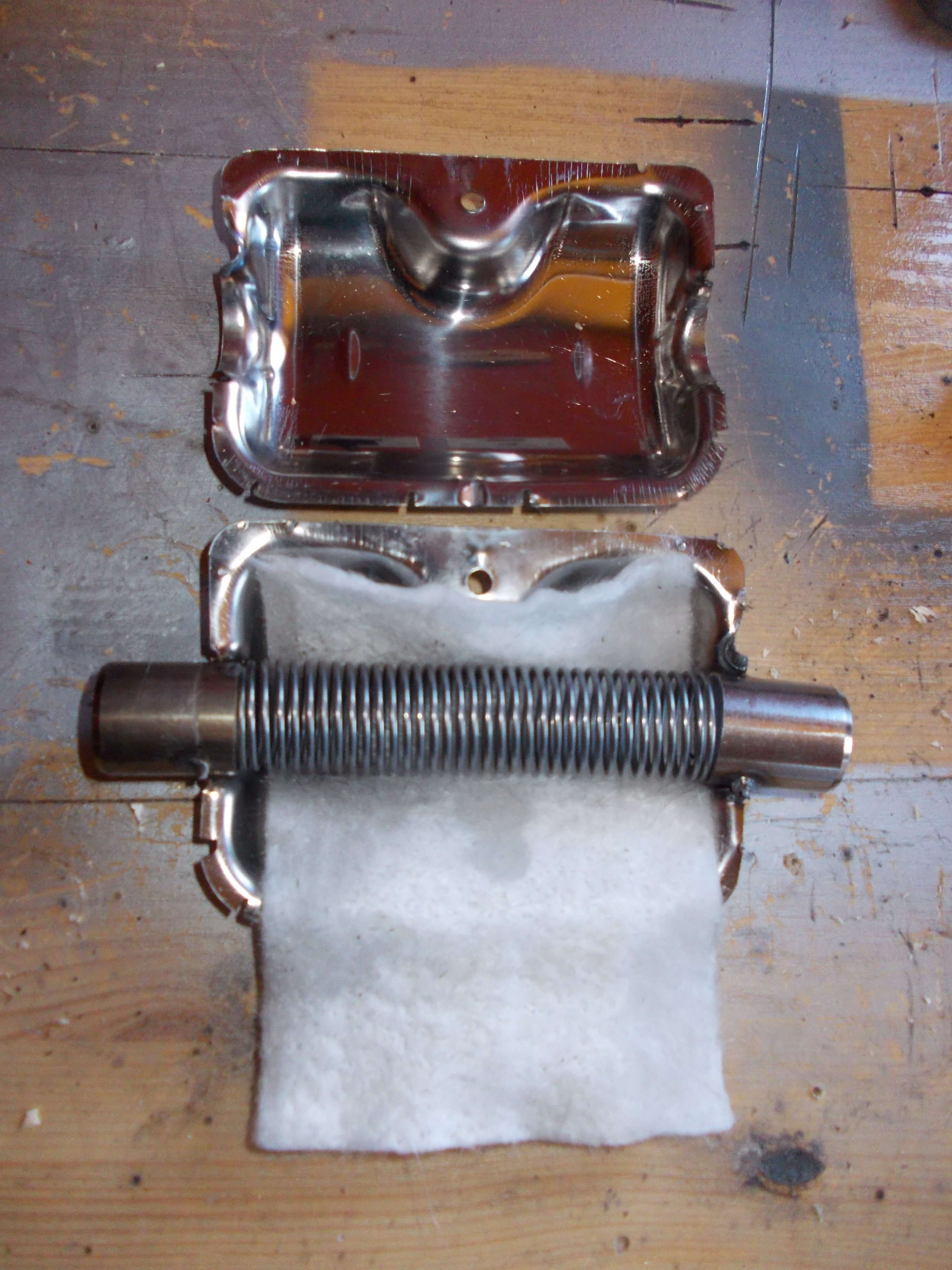

Here we have the second. I think, and I say think, this may be the problem. The muffler has collapsed inside and it must make some difference to the exhaust gases. At the moment I'm running it with no silencer just to see if that, in fact, was the problem.
A new silencer will have to be purchased but, this time, a quality one as I believe the noise will not be acceptable to me.

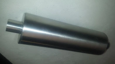

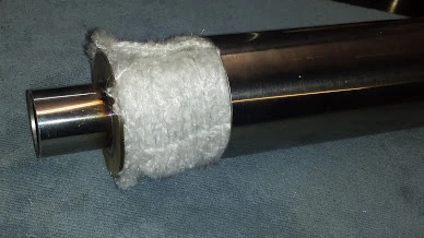

I'm running without a silencer on Betty at the moment and it does howl.

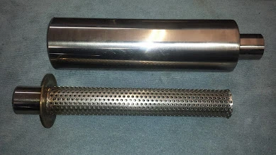

The first thing I noticed was that the smell was different so it must be burning properly now; hopefully, that's one problem solved. Next, make it less offensive to others and not ruin their peaceful outdoors.
I opted for one of these, not cheap but hopefully it will do the business.

Last hope.
Rae
Doesn't look damaged to me... Just looks like the genuine eberspacher 'u' bend inside...
I'd be more concerned about the fact I'd paid for a silencer with the other one and got an empty tin...
Have a, looksy on here at what a correct one looks like inside.
Could still have all the wadding around it even if no bend though. Can't be sure it is an empty tin from that picture.
Silencers are a funny subject, especially for a constant noise. Trying to absorb annoying frequencies without reducing flow is not that easy. Even with perforated tube, hole size and spacing can make a big difference. I studied this for a while before deciding life is too short.
I have taken it apart and it looked like the spring had collapsed and, yes, it is a Chinese one. I could have used a eberspacher one but I wanted one that was straight through, as I had 2 in line, I thought the bend x2 would slow the gasses down.
Try reading up on pulsed resonance expansion pipes for tuning 2 strokes...

Of course it may not be applicable to the Chinese Heaters, but Eberspacher publish specific recommendations regarding maximum exhaust pipe lengths from heater to final outlet and also in what positions a silencer can be installed. They are actually quite short maximums.
It is probably available on that Cypriot varnish site?
I wonder how fussy the eberspacher number are, as I intend to take them to the limit. The D4L will be mounted on the left and the exhaust needs to exit on the right.
I had that situation on my T5.... D2 Heater on right and wanted to exit on left. Woukd have went beyond the max length limit and I decided not to test it! Just accepted it would exit right :(
