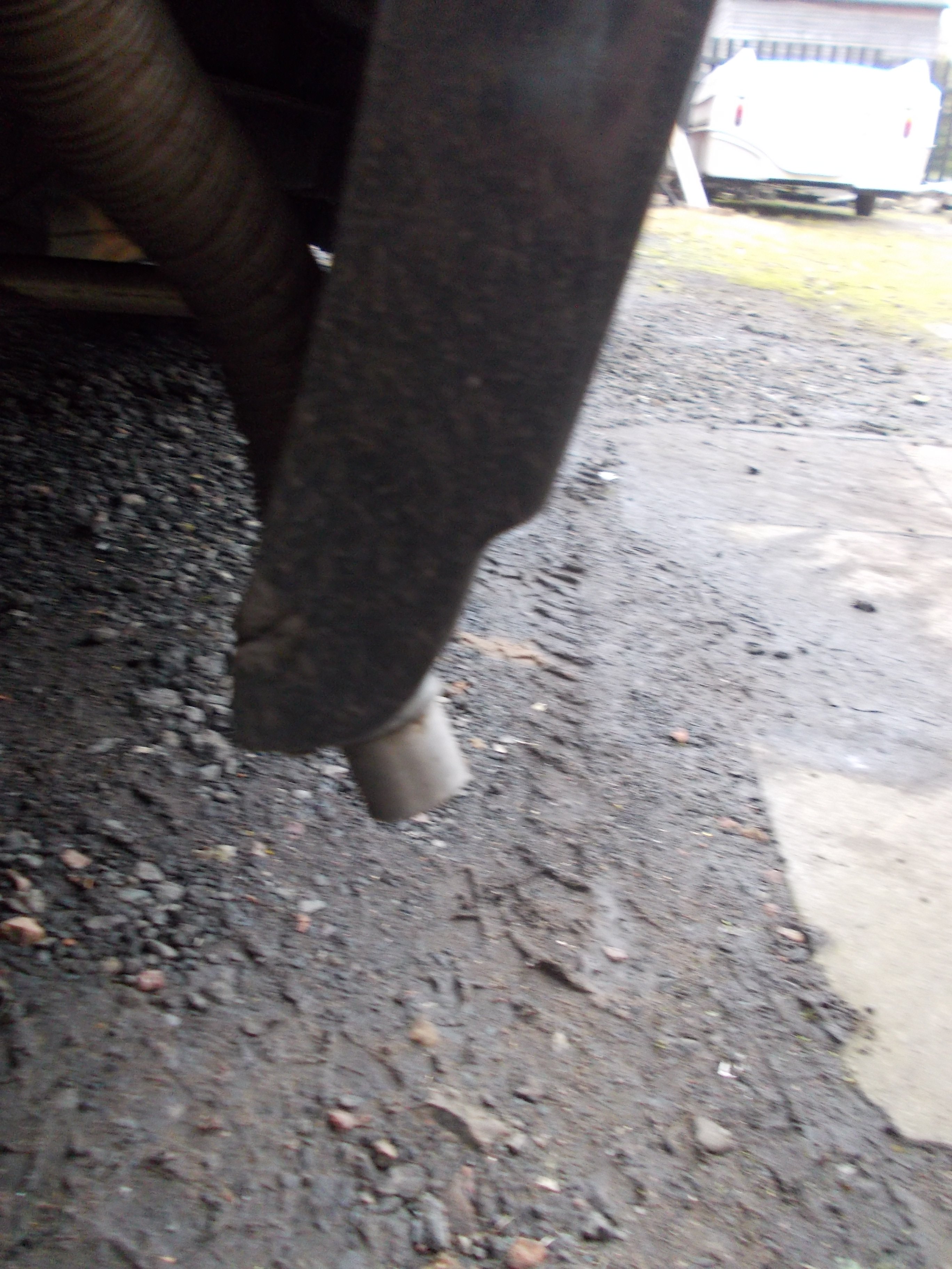

My carbon monoxide detector is up-to-date and isn't beeping so I would presume the batteries are not flat.
Below we have a picture of the exhaust. All joints were clamped together using quality clips and not the ones that were provided.
The reason could be if there is a slight wind in the wrong direction, you might be getting the output blown back towards the fresh air intake? the 'sucking' effect of the combustion could even be potentially drawing the exhaust output into the air intake?
I don't know what the composition of the exhaust fumes would be, but maybe something other then Carbon Monoxide that could be unpleasant to breath?

The intake is just behind the driver’s seat, the intake for the burner is under the floor, just behind the cab.
