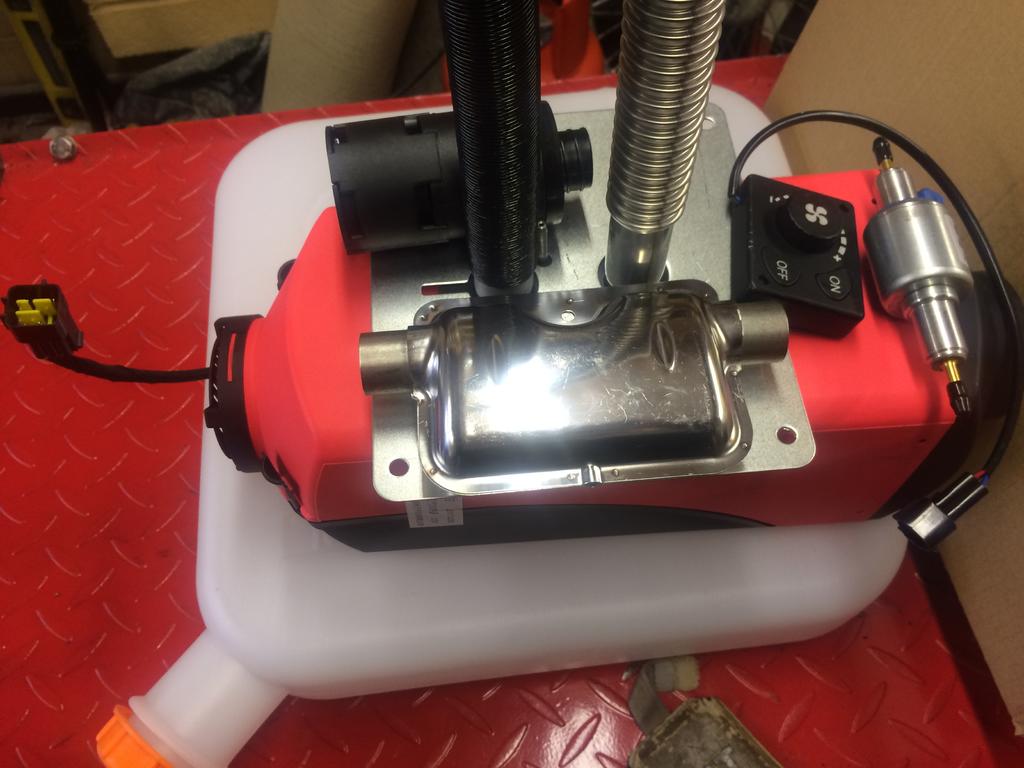

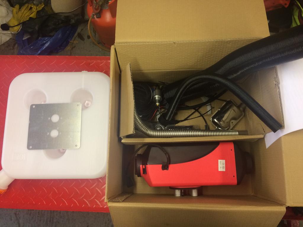

Well I took the plunge and bought one, it arrived today well packed and all seems to be there.
I need to make some mounting brackets for it and don't see me getting to do that until Monday as its market day tomorrow which means work.
I guess you can connect it together and run it on the bench to try it out ?
:wave:
You have to be a bit careful you don't get caught burning the wrong stuff nowadays.
To burn waste oil, you need a permit costing £3,218 and an annual fee of £1,384 apparently.
Not for priv/ homes.
Yes it comes with its own 10ltr fuel tank, even has a silencer for the air intake as well as the exhaust.
If you fit the separate fuel tank, you can run it on red diesel, worth it at 40-50p per litre.
would you mind measuring the tank? width. height and depth. (I am wondering about a seperate tank and have a possible location in mind)
