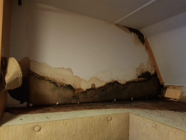

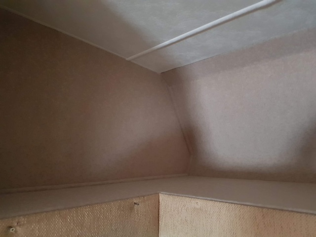

Update
After complaining to the dealer about the potential damp - he sent me pictures saying they had been treated - indeed it looks like the covering is aftermarket - what do you think of these pics
