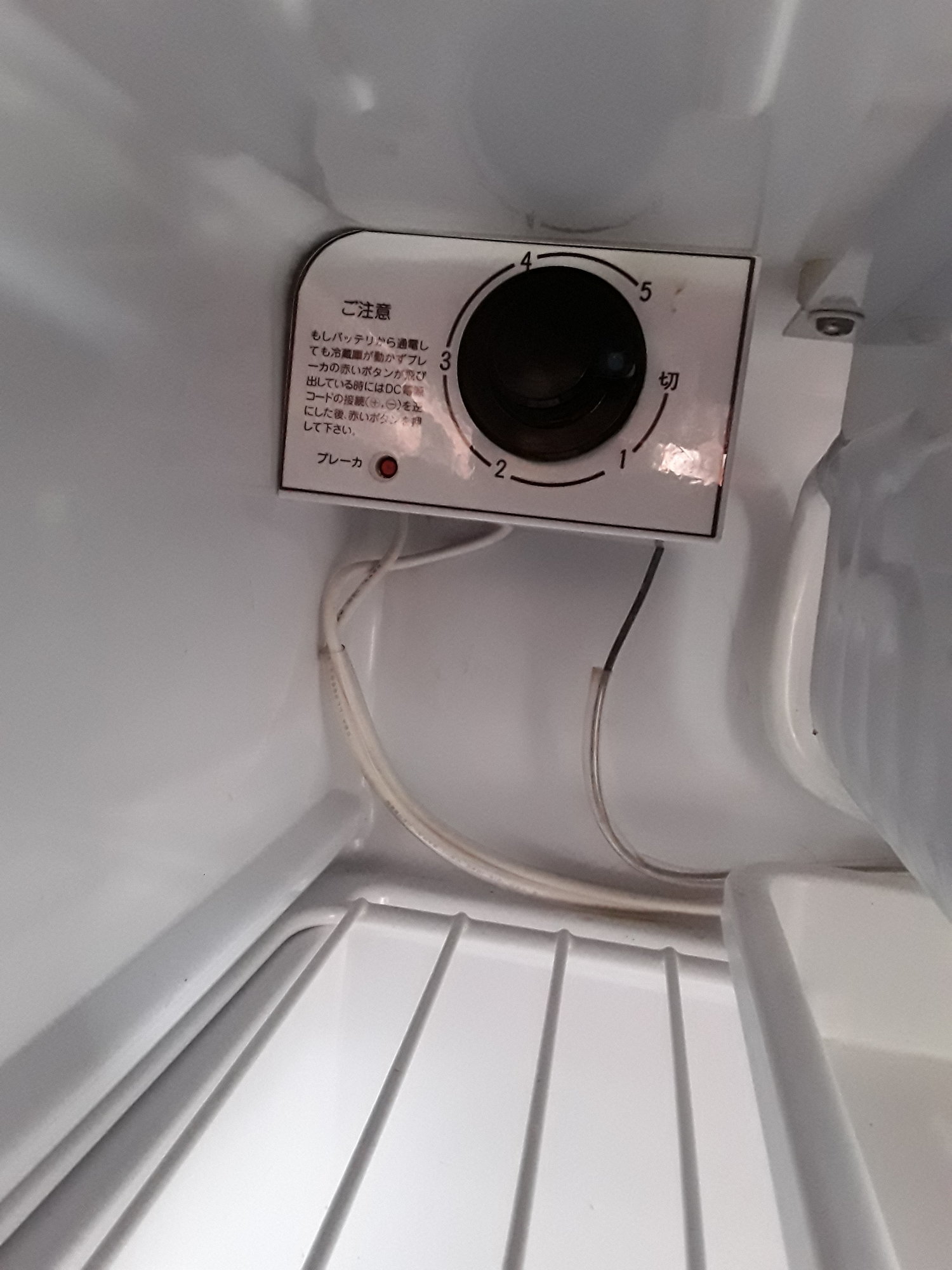

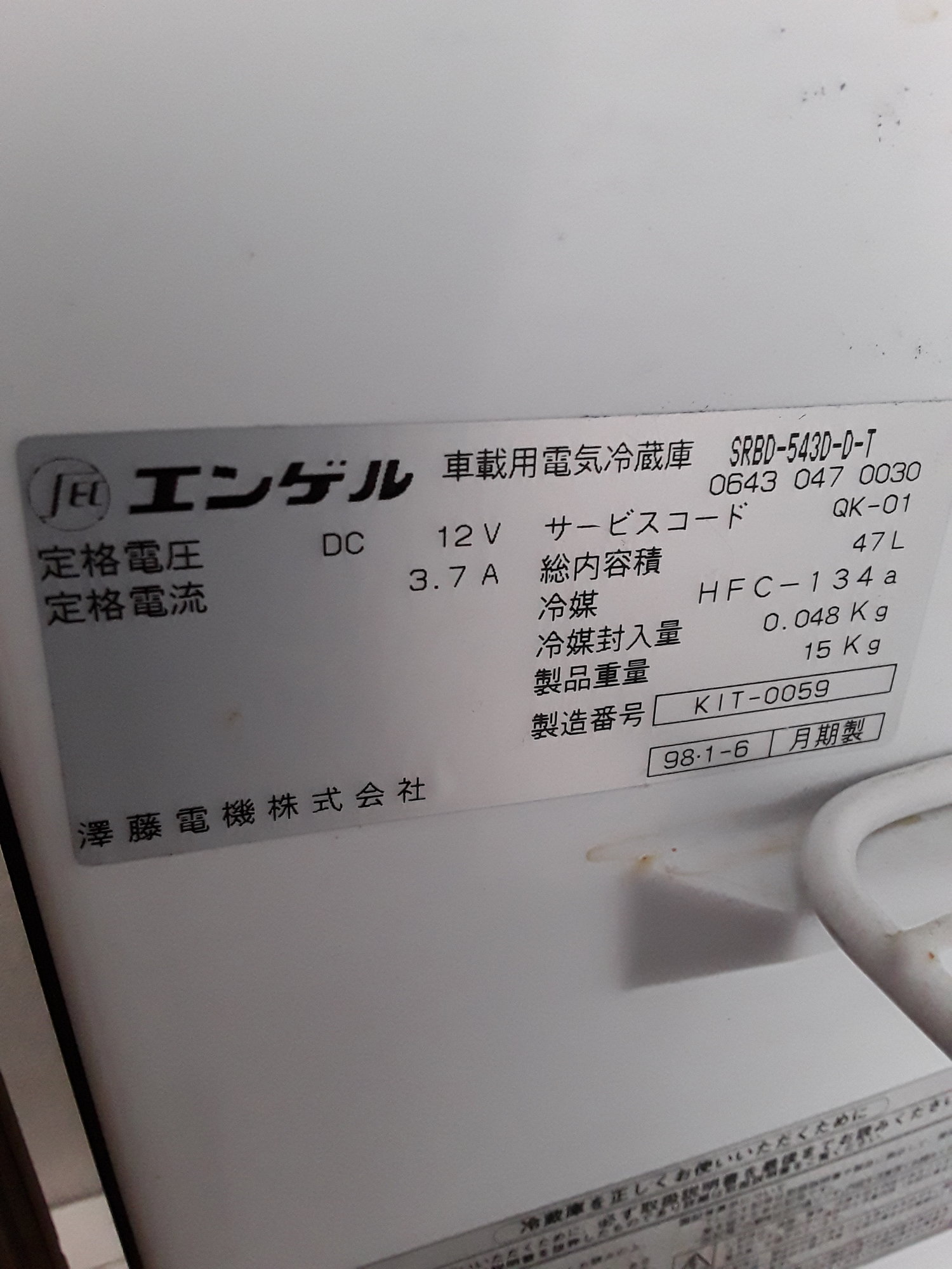

Break out tight ass and buy a small AA++ £70 and a smart inverter.Results:
Ambient 22c and 5 available settings on fridge
Setting 4 (-2.5c)
On 3m 30s
Off 2m 45s
On 3m 30s
Off 2m 48s
Temp increase during OFF of 0.1c
Setting 2 (3.3c)
On 2m 39s
Off 2m 49s
On 2m 35s
Off 2m 57s
Temp increase during OFF 0.3c
I have checked the seal all round there is resistance when opening the door. During experiment seal was slightly broken due thermometer cable.
Any thoughts very welcome as running 50% of the time is going to batter my battery
