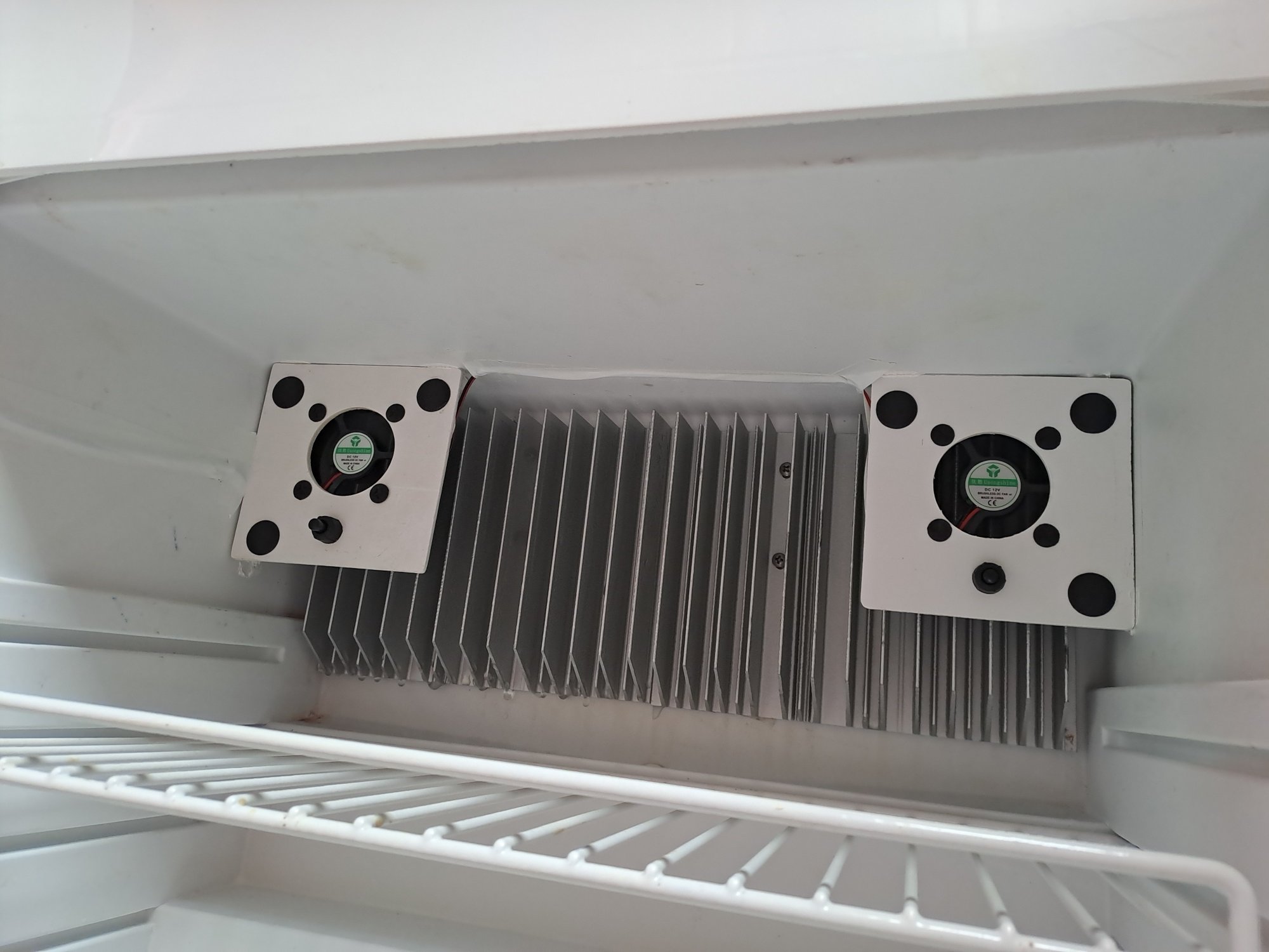

I had this same quandary in 2023. The original Electrolux absorption fridge in our van refused to stay alight on gas. I had already replaced every part possible on it. I thought about a 240v compressor running on an inverter but realised I would probably need to upgrade my 12v system completely. I only have one solar panel of unknown size and also the same controller that came with the van. My two existing 110ah batteries cope adequately at the moment even though we run 2 CPAP's every night. I looked at the replacement Dometic three-way fridges and decided they were too costly so in the end I purchased a Vitrifrigo 3-way. Still fairly costly but I wanted to keep the ability to run on gas.
Apart from a problem with being unable to use different settings when on EHU, I have been pleased with it so far. It turned out that a micro-switch behind one of the push buttons had broken. As it was still in warranty, the manufacturer sent me a replacement front panel which I fitted.
However, as with all absorption fridges it's performance is not great in very hot weather. So, I have recently fitted 2 small 12v fans in front of the metal fins to circulate the cold air. They are switchable so we can use either or both or none. Initially, these seem to help but we haven't had a chance to test them thoroughly yet. I used all plastic fixings to avoid any possibility of rust.
We may be heading down to Frejus next week but not sure at the moment and also of course it may not be that hot!

So we returned from the campsite at St Raphael on Monday having arrived there early afternoon on Friday. We only use sites very rarely and this one is a 5 star and we stay there as my sister and bil usually stay there with Eurocamp each September. So we had EHU for the weekend. I had started the fridge on gas on the Wednesday and switched to 12volt for the journey down (about 5 hours with stop for lunch). I started the 2 internal fans as the journey started and also the 2 fans that assist the external airflow. Once on site we were on electricity so left all the fans running. The weather was quite warm - mid to upper 20's on Friday and Saturday. I am pleased to say that the fridge performed much better than when I had used it on EHU at my house earlier in the summer. I don't think we'll be getting any more heatwaves this year but I am much more optimistic about it's ability to keep things cold for next year.
